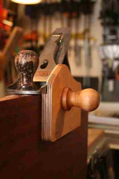

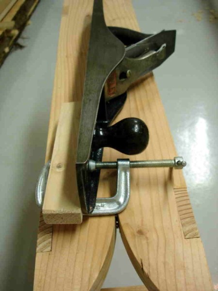

Here is an option:
http://www.fine-tools.com/hobelzubehoer.html
Here is another option. Notice the knob to hold the fence tight to the material:
http://www.hiwtc.com/products/electric- ... -11566.htm
Jointer plane.
http://lumberjocks.com/projects/2814
Here is a quick way.
[ATTACH]16341[/ATTACH]
I really liked this one.
[ATTACH]16342[/ATTACH]

robinson46176 wrote:Here is an option:
Jointer plane.
Farmer remember we were talking about MDF board. I don't like to sharpen hand planes that well.
