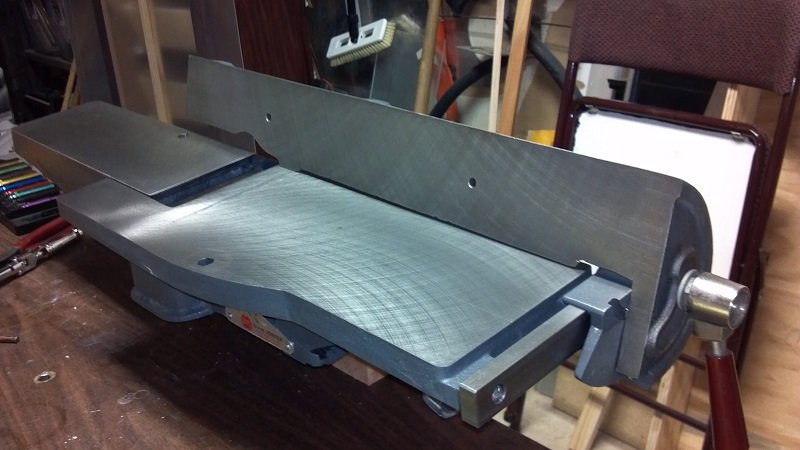

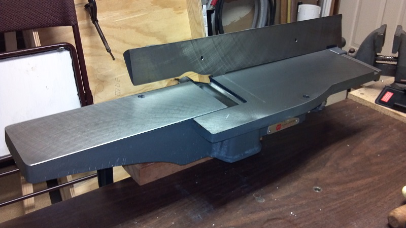

Finally started joiner re-assembly this week.
Assembly when very smooth and easy. Now, with the fence quadrant, that was a different story.

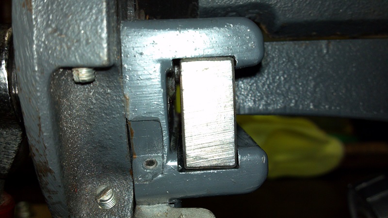

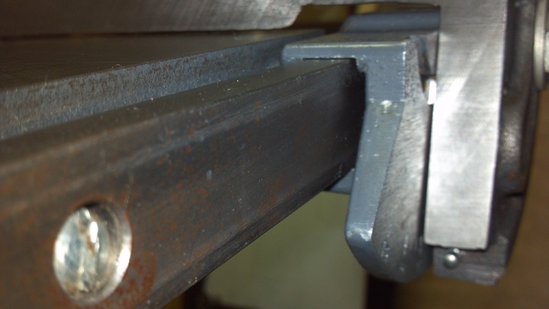

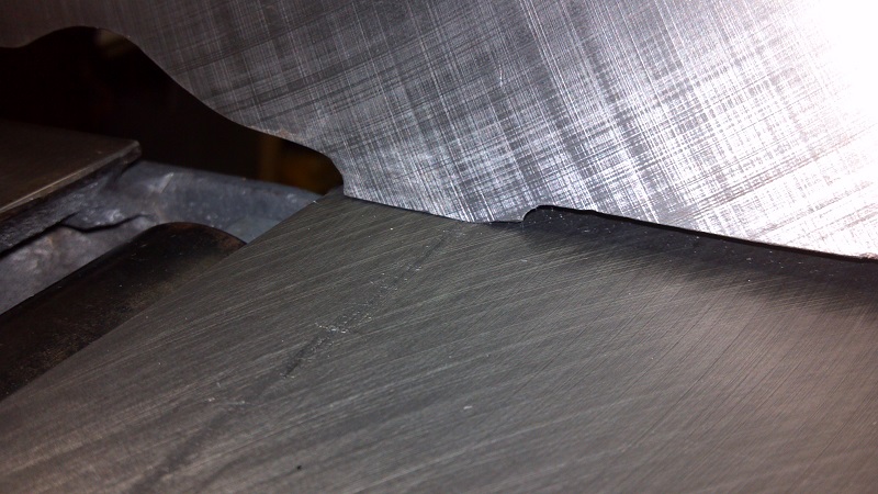

When I locked down the lateral adjustment (quadrant to fence mounting bar), the fence rose about 3/8 to 1/2 inch proud of the infeed table!
After searching past threads dealing with this issue, it was obvious that the quadrant was bent.
Well, took the quadrant and mounting bar to work with me today. Used the 20 ton press and put er back in shape. A little fine tuning with a small flat file finished it off. I left the fit kind of snug but moveable.
After re-attaching the bar, quadrant, and fence, I now have no lift on the far end of the fence. Right or wrong, it's far better than it was.
