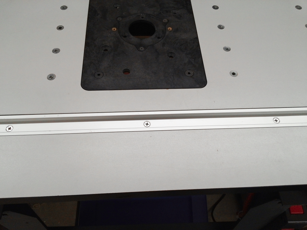

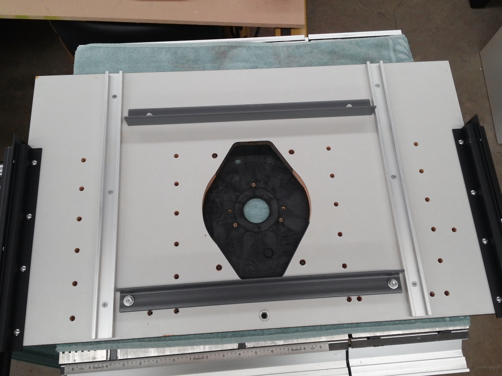

But again, the solution was pretty simple. Some angle iron from Ace hardware (painted with red-oxide primer and then some SS touch-up paint), some judiciously-placed mounting holes, and some masking-tape shims under the angle iron got that vintage table flat to within +0", -0.002" in pretty short order. If I ever bought a brand-new table made of anything other than metal, I'd install similar stiffeners up front, before it ever had a chance to sag.
Definition (1) of "judiciously placed mounting holes": The front angle-iron stiffener was mounted by replacing two of the front T-track woodscrews with stainless machine screws, through the table and angle iron. Virtually impossible to detect from above.

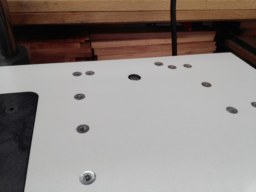

Definition (2) of "judiciously placed mounting holes": After experimenting with threaded fasteners in particle board, i concluded that the stuff was really suitable for compression loading only. And so to mount the rear angle-iron stiffener, I eventually decided to counter-bore the top for through carriage bolts. I was pleasantly surprised to find that a nice shiny carriage-bolt head, in a counterbore colored black with an felt-tip marker, looked as if it had belonged there all along.
