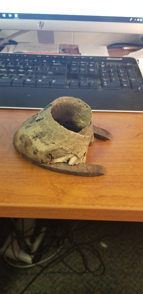

My office building has been in my family for three generations... back to 1923. The building is older than that by quite a bit. A converted home with several additions. The original roof is still visible if you venture into the attic(s), complete with shingles!. We installed a drop ceiling in the second floor, and when we had the painters wallpaper the rooms, he got zapped while wiping the paste off the ceiling track. He had his palm against a light switch. Knob & tube wiring, still in commercial use. The hangers for the ceiling found the wire. Electricians solution? Go the the panel and switch the neutral with the hot. Problem solved (for now)!

Yes, the histories can be mind boggling. I found this in my office attic when I cleaned it out 35 years ago! What was it there for? My grandparents did have a stable early on!
Hobbyman2
LOL Must have been special to some one ?
We found a pair of ladies shoes from what we believe to be from 1915 and a news paper from 1915 that had a story of opening the Panama Canal. we believe the shoe to be the same age as the paper since they were together .
Nothing like a horseless shoe still on the hoof lol but still pretty neat history .
