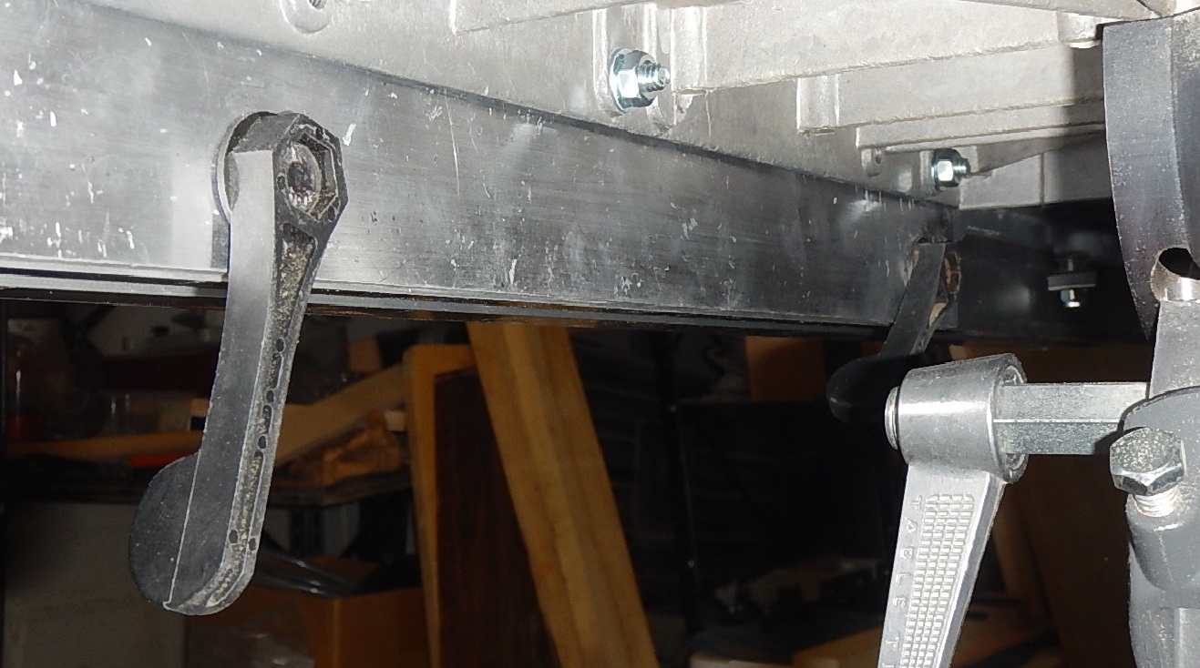

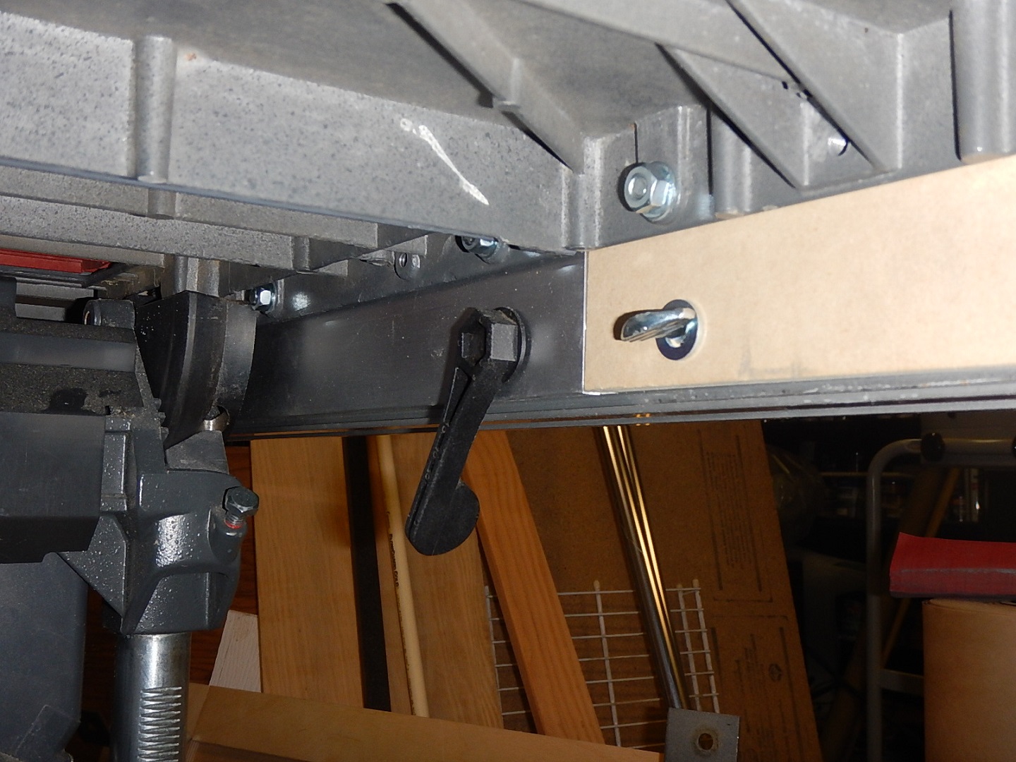

I thought if I could mount the Ryobi rails on the Shopsmith it would perhaps make up some of the shortcomings of the saw. Some measurements between the craftsman and shopsmith revealed there was only a half inch difference between the rails. That meant if I shimmed out the Shopsmith a quarter inch on each side, the rails from the Ryobi should work fine. I did a little mock up with some MDF, and it seemed to work out just fine with just a few modifications.

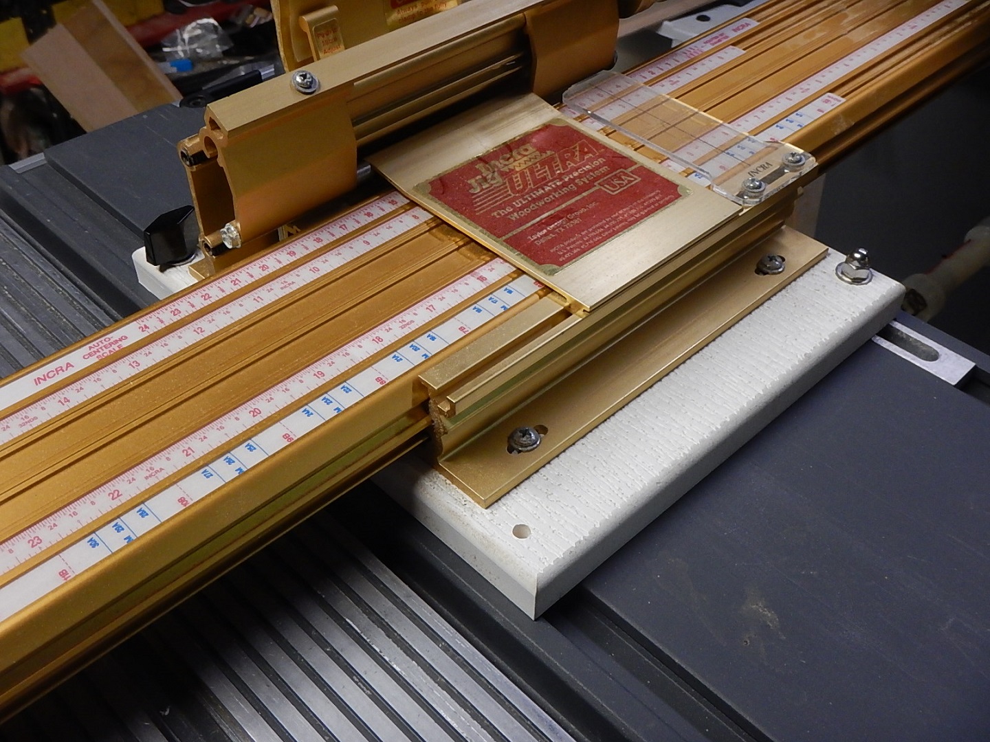

The parts that I ordered were some aluminum stock, 1/4"x2.5"x36" 6011 grade. You can get a piece of this for under seven dollars on Amazon. I then ordered four of the quick clamps off of eBay for the Ryobi BT3000 (under $20). There was probably another miscellaneous $15 in hardware. The rails I had on hand, but if you had to buy new they are about $40 or so for a set. Extra tables are in the $50 range, but adapting one of the Shopsmith floating tables is not difficult. I also found I could use my Incra LS positioner, if I later wanted to add a router table.
I would say the hardest part of the build was making a notch in the aluminum for the rear rail. The back of the fence hits the shim, so 3/16 of an inch needs to be removed from the spacer. I took very light (1/64") passes on the router table, and then did a final sand with some 150 grit sandpaper to remove the mill marks.

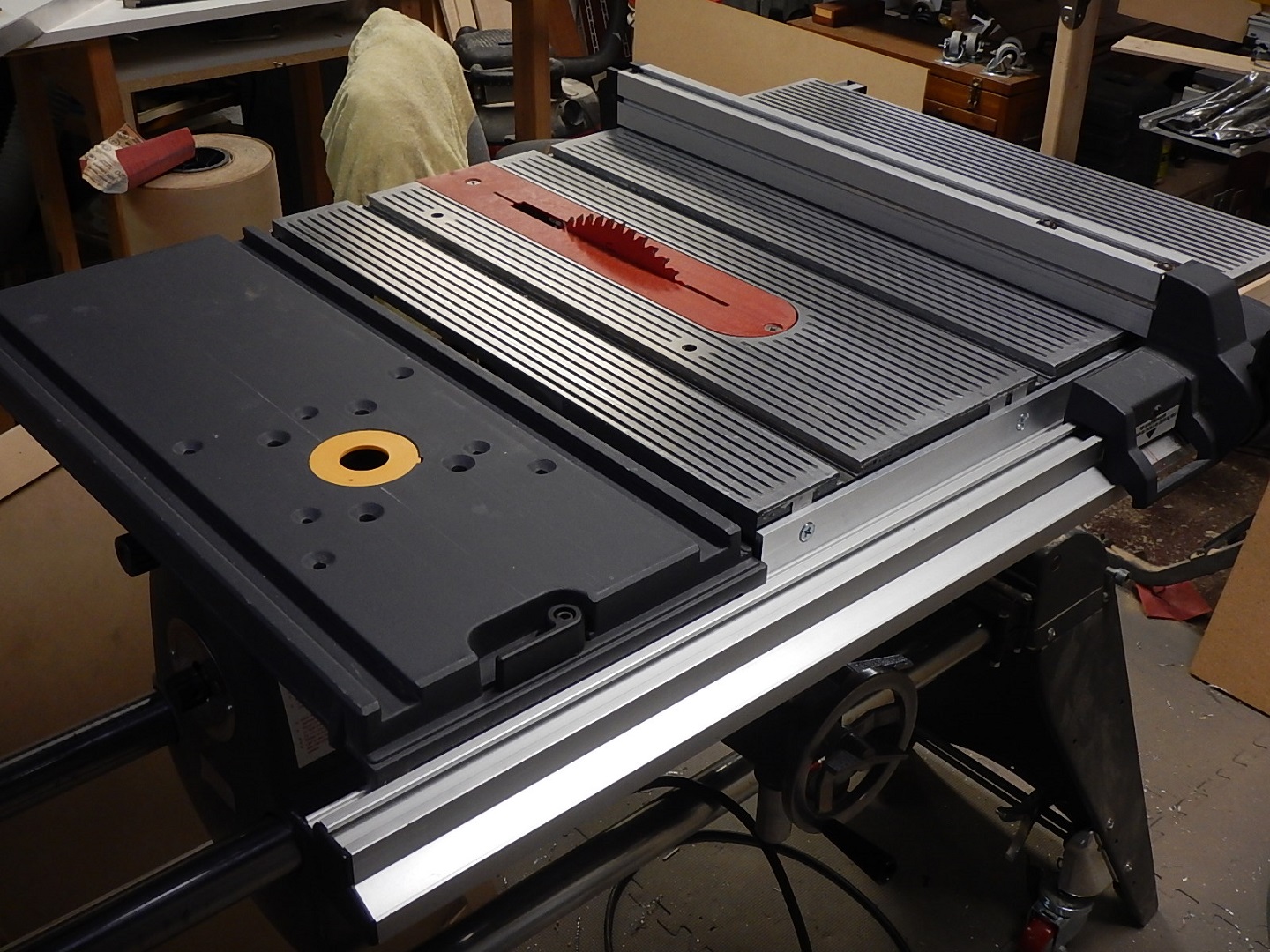

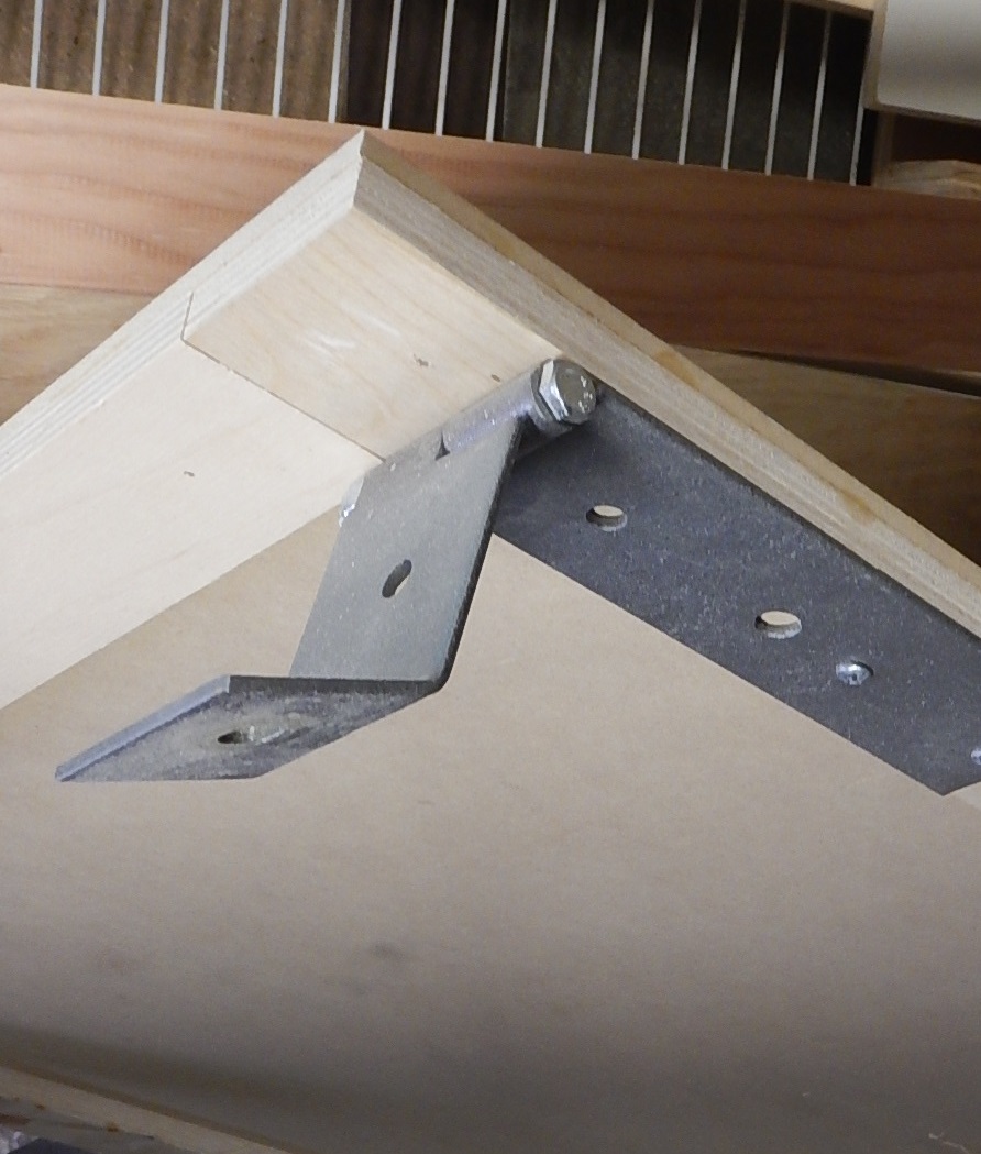

So, how does it work? In a word, fantastic! The fence glides absolutely smooth, and locks down positive. I will add a measuring tape to the front. Depending on how you configure the rails you can get about 24 inches or rip capacity. One thing I really like is you can use the SS extension tables to support long pieces for crosscut. I also have the ryobi outfeed brackets. Those mount in the aluminum extrusion on the underside of the rails, and allow you to flip up an outfeed table. With the adjustable leg from shopsmith, you can have a pretty nice outfeed table.

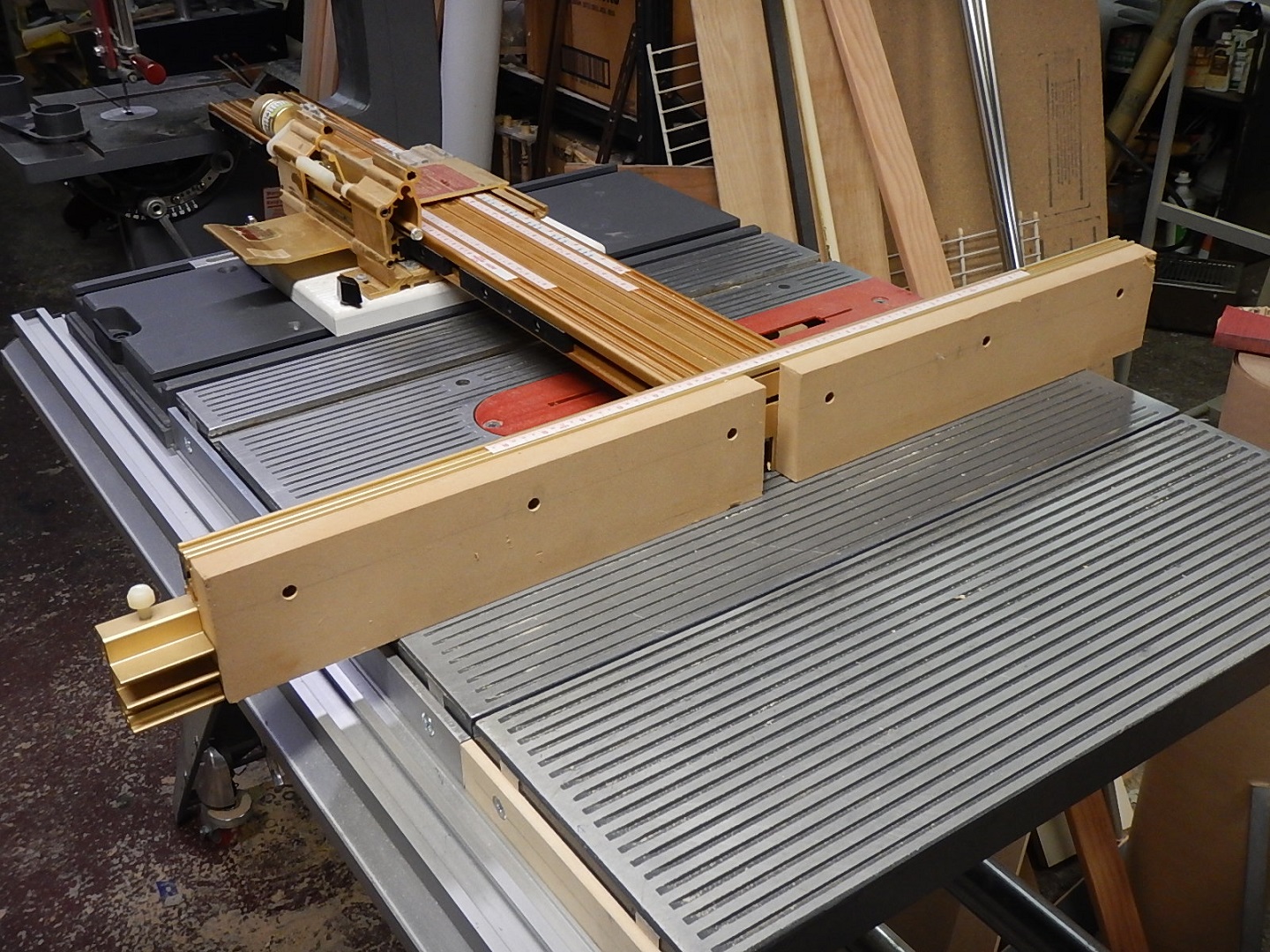

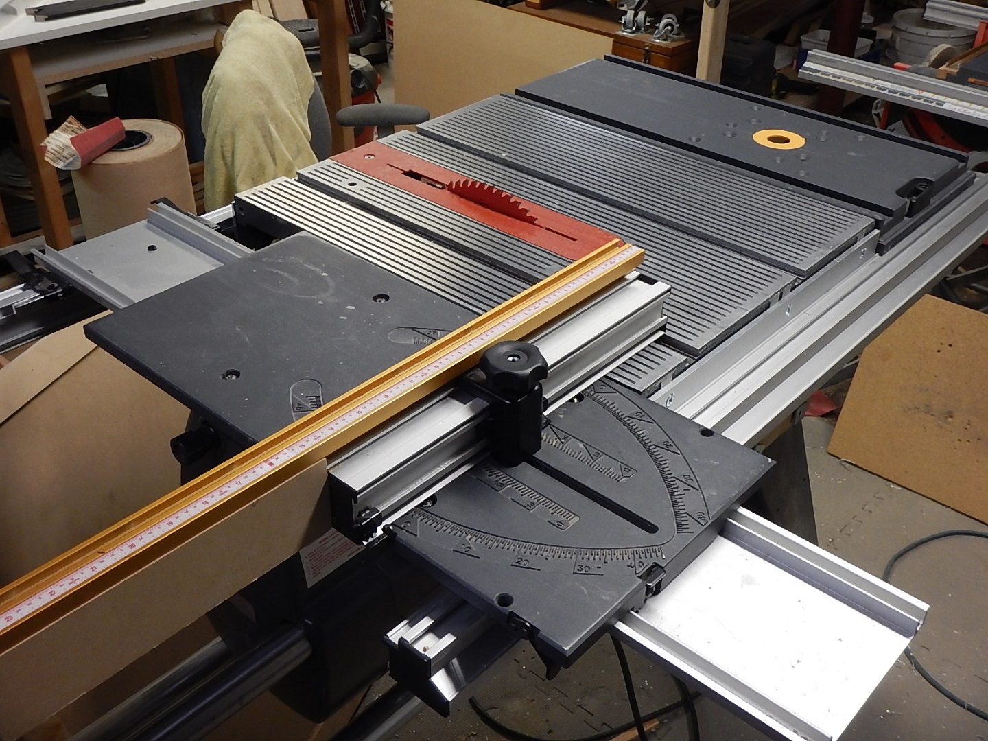

Here's some pics to tell the rest of the story. Enjoy!
