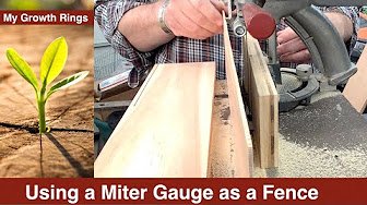

Those who own the Shospmtih Bandsaw with the original cast iron table can take advantage of the cleverly designed cross-slots in the table that allow the standard Shopsmith miter gauge to be used as a fence that easily adjusts to accommodate the blade drift that is a natural occurrence when using this bandsaw. This video covers the easy set-up of this feature.
