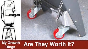

If you move your Shopsmith tools on Shopsmith casters eventually you will need to replace the wheels, and if you own the Mark 7 and/or the heavy PowerPro headstock, IMO, polyurethane wheels are a mandatory upgrade.
The great news is we now have a couple choices:
1.) We can replace them with the same hard-plastic OEM wheels that have served us just fine all these years, or
2.) We can upgrade them with softer, smooth-running polyurethane wheels, or
3.) We can upgrade them even further with Shopsmith's official Premium 3" polyurethane wheel upgrade. But which one is most worth it?
0:00 - Intro
0:16 - A bit of history and how they work
0:56 - The problem with Shopsmith casters
1:29 - 3 replacement wheel options
2:11 - Installing the Econo version
2:24 - Flipping the Mark V with the Headstock OFF
2:39 - Installing the Premium Shopsmith 3" polyurethane wheels
3:15 - Flipping the Mark V with the Headstock ON
3:20 - Removing caster assembly
3:46 - How the Shopsmith 3-position caster assembly works
6:41 - Drilling the legs for the Shopsmith Premium 3" polyurethane wheel upgrade
8:15 - Mounting the caster assembly higher on the legs
8:58 - Pressing in the new wheels
9:24 - Lifting the Mark V back onto it's feet.
9:39 - Taking the new casters for a test drive
9:50 - Final thoughts and my recommendation
