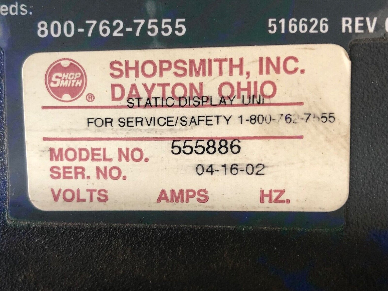

For some unknown reason it has been left out of the Shopsmith History. It is the same as the 510 except it does not have the 2 Floating Tables, Connector Tubes and the Support Legs. The 505 was discontinued prior to the 510 being discontinued. The stick-on label does, in some cases, call it a MARK V MODEL 505 as it came from the factory. Not all labels call the actual Mark V model by name from the factory. An example is below from one named STATIC DISPLAY UNIT.
_

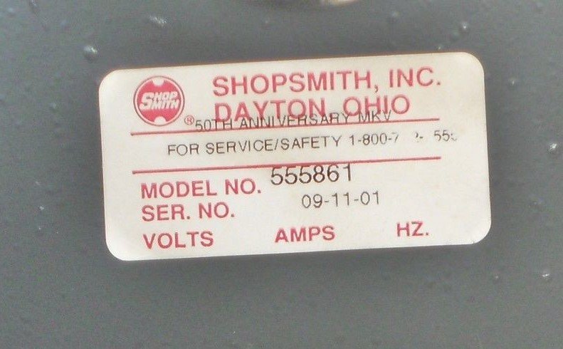

Other names I have seen include PRO MARK V UNIT or MK V BASE UNIT, but one can only guess what all the other names actually mean. Many simply say MARK V. The label below even calls it 50TH ANNVERSARY MK V.
_
