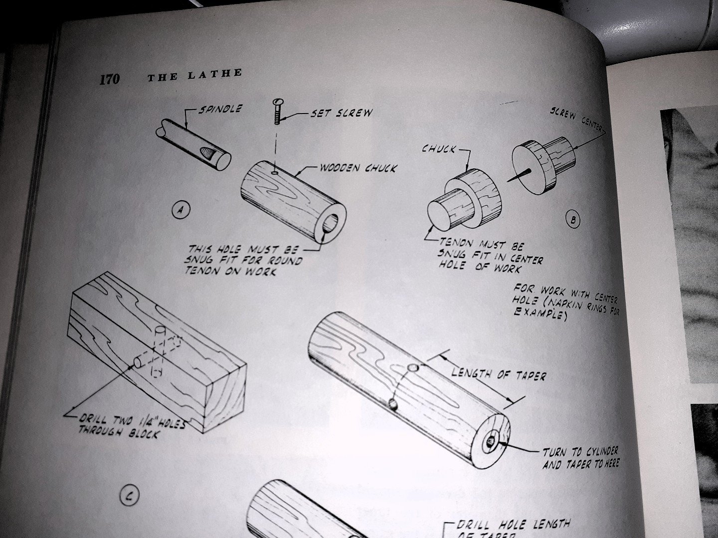

Then make a jam chuck (just a piece of scrap wood that has been turned the bore of the thimble with fit snugly on it) it could be fitted on a face plate, or mounted on a screw center (B ) or mounted directly on the spindle (A) for finishing.
This page is from the PTWFE book referenced above.
