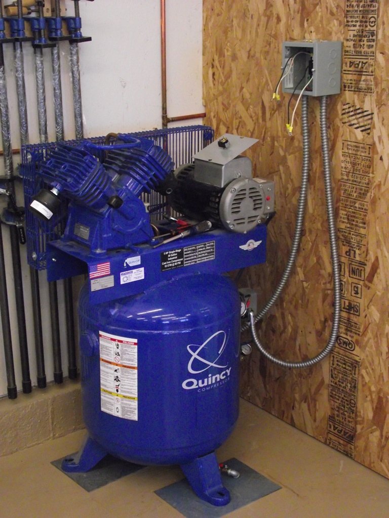

I would definitely say a quiet compressor is the most preferable option. If your compressor doesn't sound like a herd of cattle stampeding across a metal roof then you may not need any other means of sound reduction.
Piston air compressors are much quieter than diaphragm compressors. Years ago I had a 20 gallon vertical Craftsman compressor. It absolutely screamed. I replaced it with a 4 cylinder 30 gallon Quincy. The Quincy is much quieter than the Craftsman was.
GentlemanAdventurer
That's a nice looking Quincy! What are the airflow specs?
It is 21 CFM at 40 PSI and 18 CFM at 90 PSI. It has a 5 HP Baldor motor at 3450 RPM but the compressor pump runs at 900 RPM so it is pretty quiet.
GentlemanAdventurer
Thanks JS
