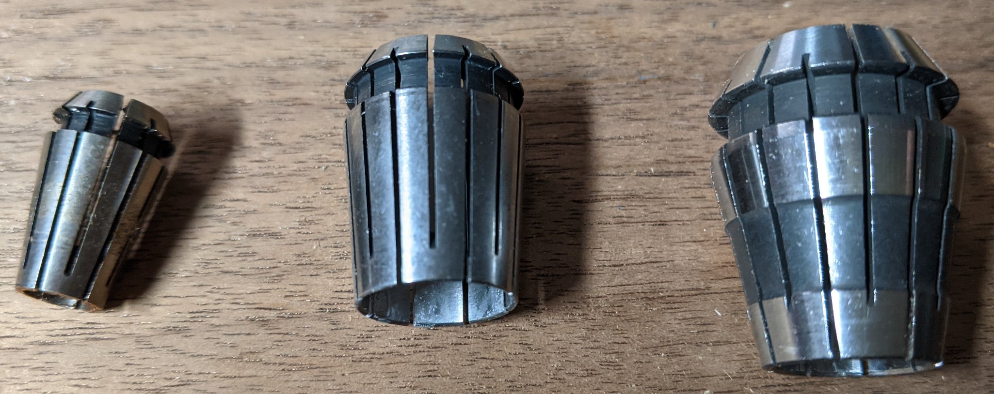

Below is a pic of three different collets that I have. The one on left is a true ER11 (which the ER11 line has various sizes up to 1/4"). The middle one is a 1/2" collet from PB for my Hitachi router. The one on the left is a 1/2" collet, also from PB, for my PC 690. An ER20 collet would look very much like the ER11 but larger. I'll take another pic next week when I receive the SpinRite with its true ER20 collet.

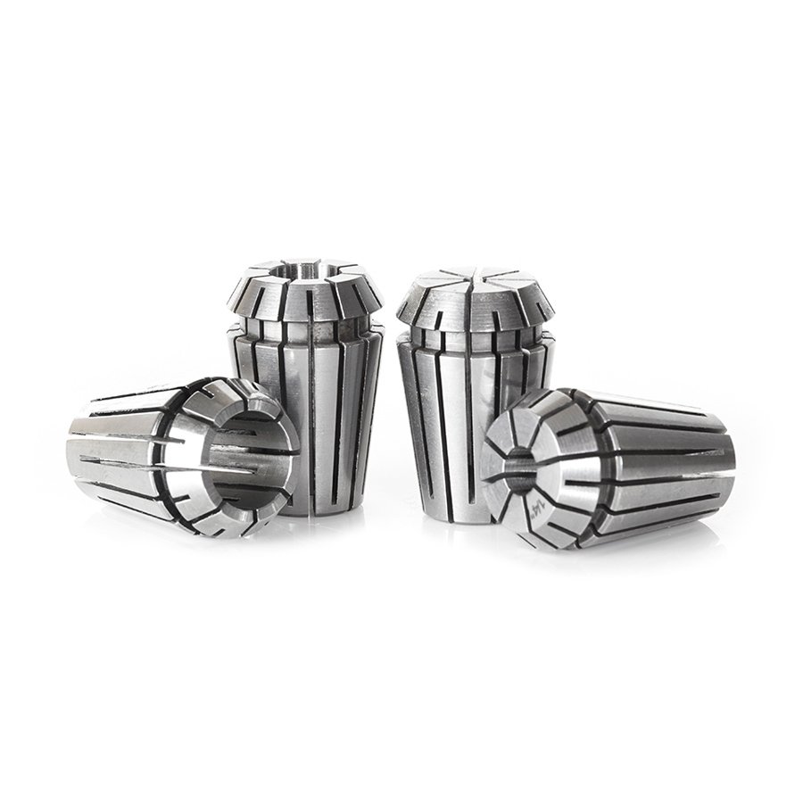

And finally, a pic of ER20s:
See how the ER20s appear to have a different angle from the Elaires, not to mention straight sides vs the indented area. The ER20s also appear to have a different angle than my Hitachi and PC collets.
