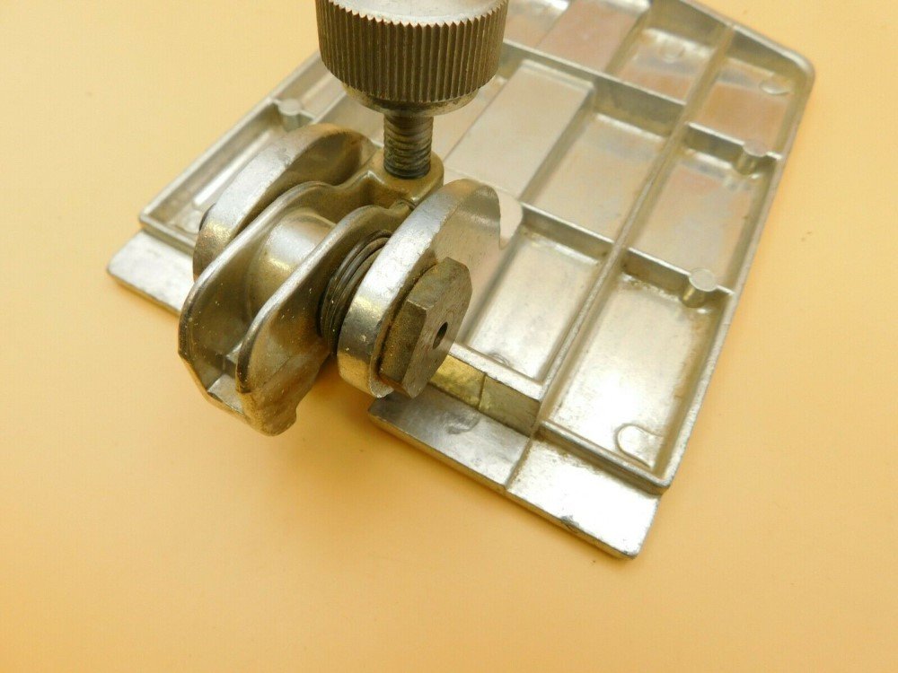

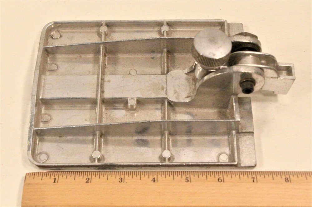

It has been suggested you get Front Table Extensions for your Mark V which has the original Table System aka 500. If you decide to look for them do make sure you get the later version. The table's fence rail changed from a cast on to a bolt on rail and the lock for the Front Table Extensions were changed to accommodate that change in the fence rail. In the first picture below is the original version and note the lock and especially the end of it. In the second picture below is the later version with an extension to the lock which is the one you would need.
