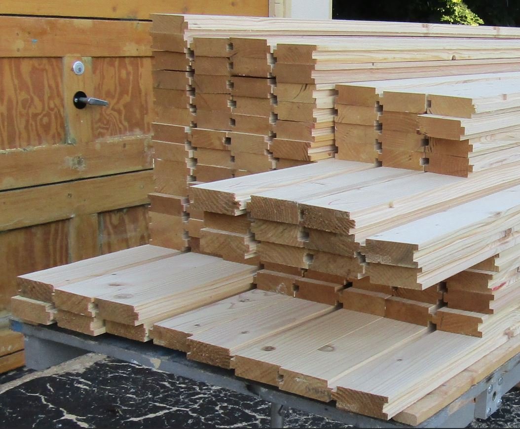

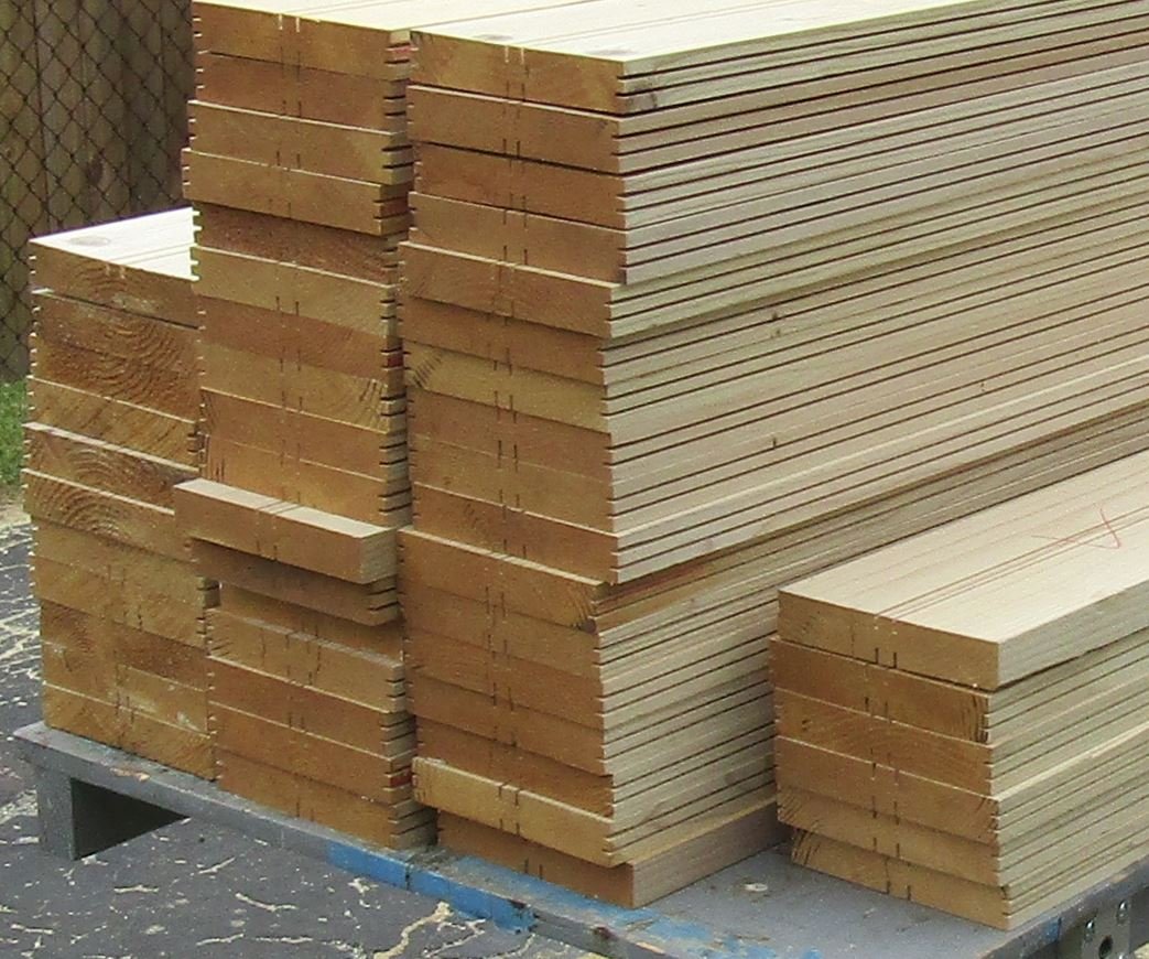

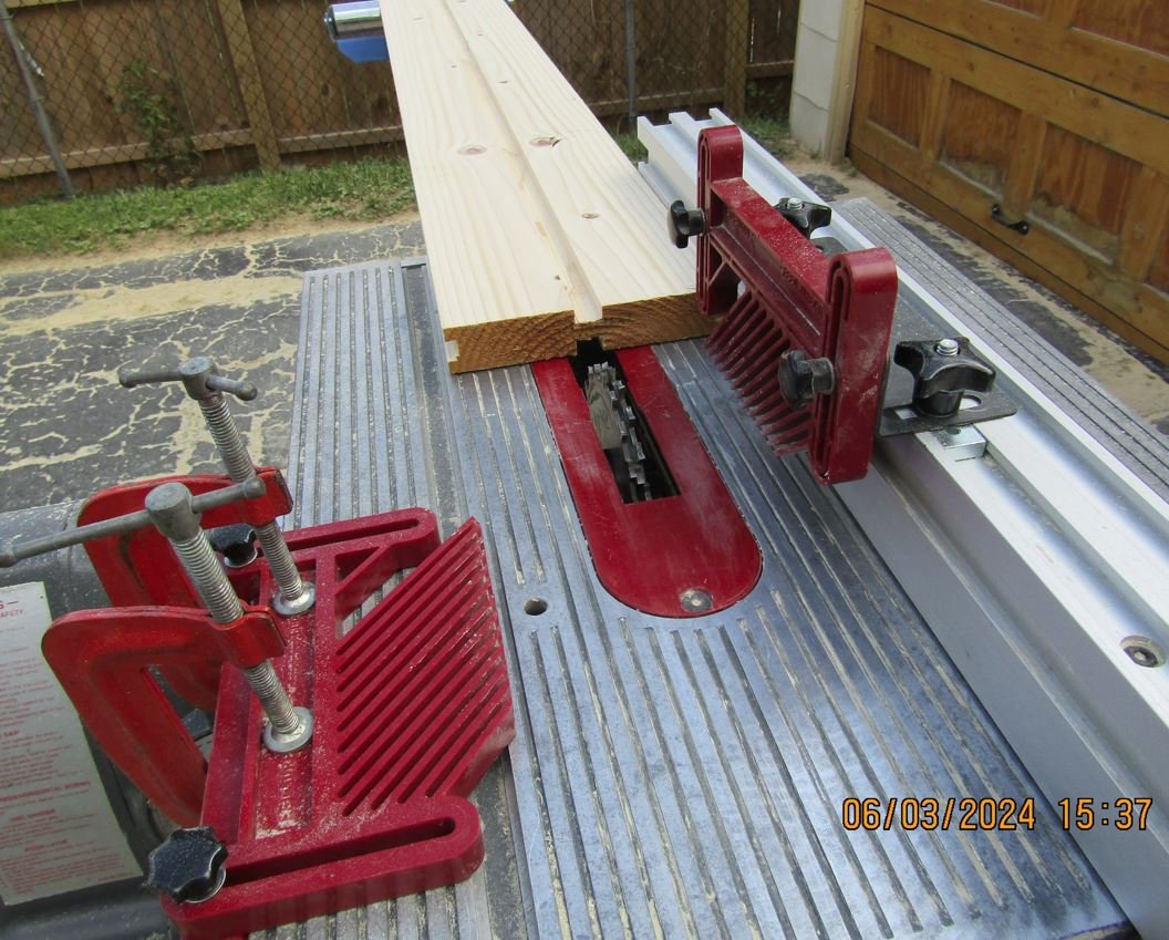

Now I have finally finished milling a batch of tongue & groove floorboards sufficient to do the porch deck. Started with bigbox lumber and milled it down into nice flat straight 1-1/4" thick boards. Shopsmith and I got them to a very uniform geometry.
