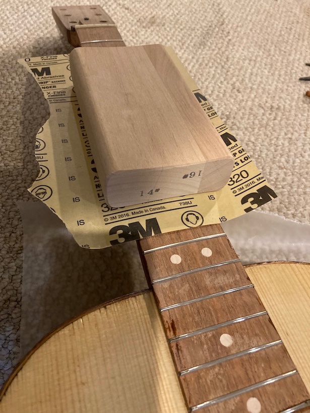

I had to do a lot of learning on (re-) fretting. Here, correct tools are really key. Fortunately, not too expensive.

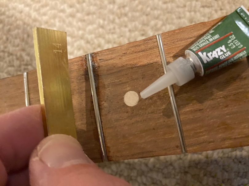

The main thing I found helpful was getting the fret wire, fret press blanks, and fret sanding blocks all at the same (14") radius. That took care of many problems. Out of 18 frets or so, 3 of the slots were wallowed out from my mistakes, but I resolved those with super glue:

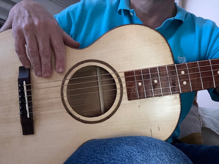

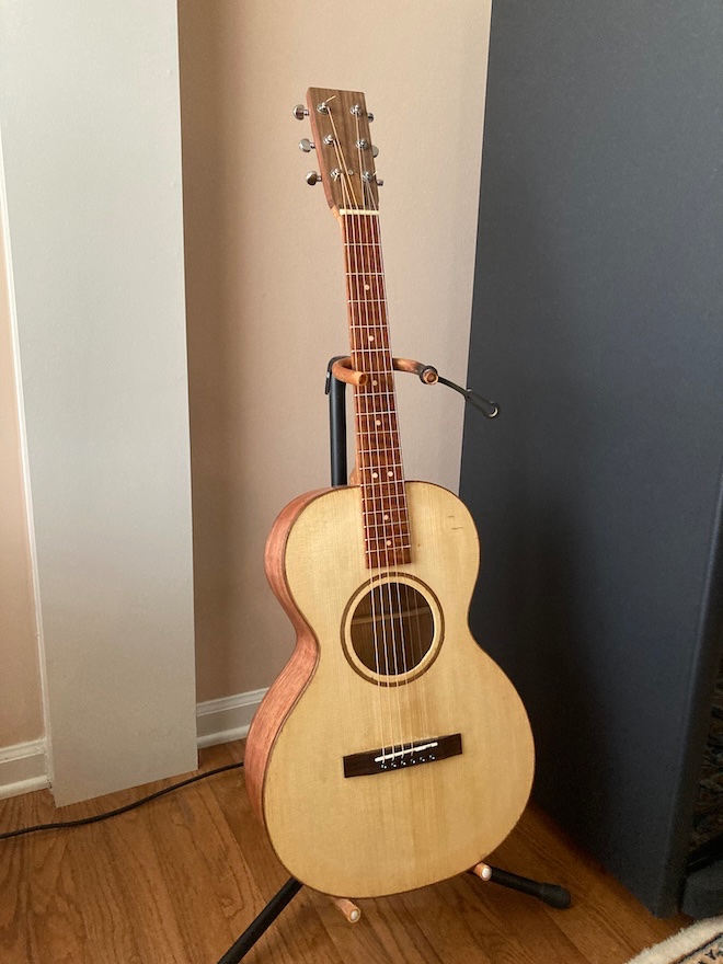

And here is the fully playable guitar!
