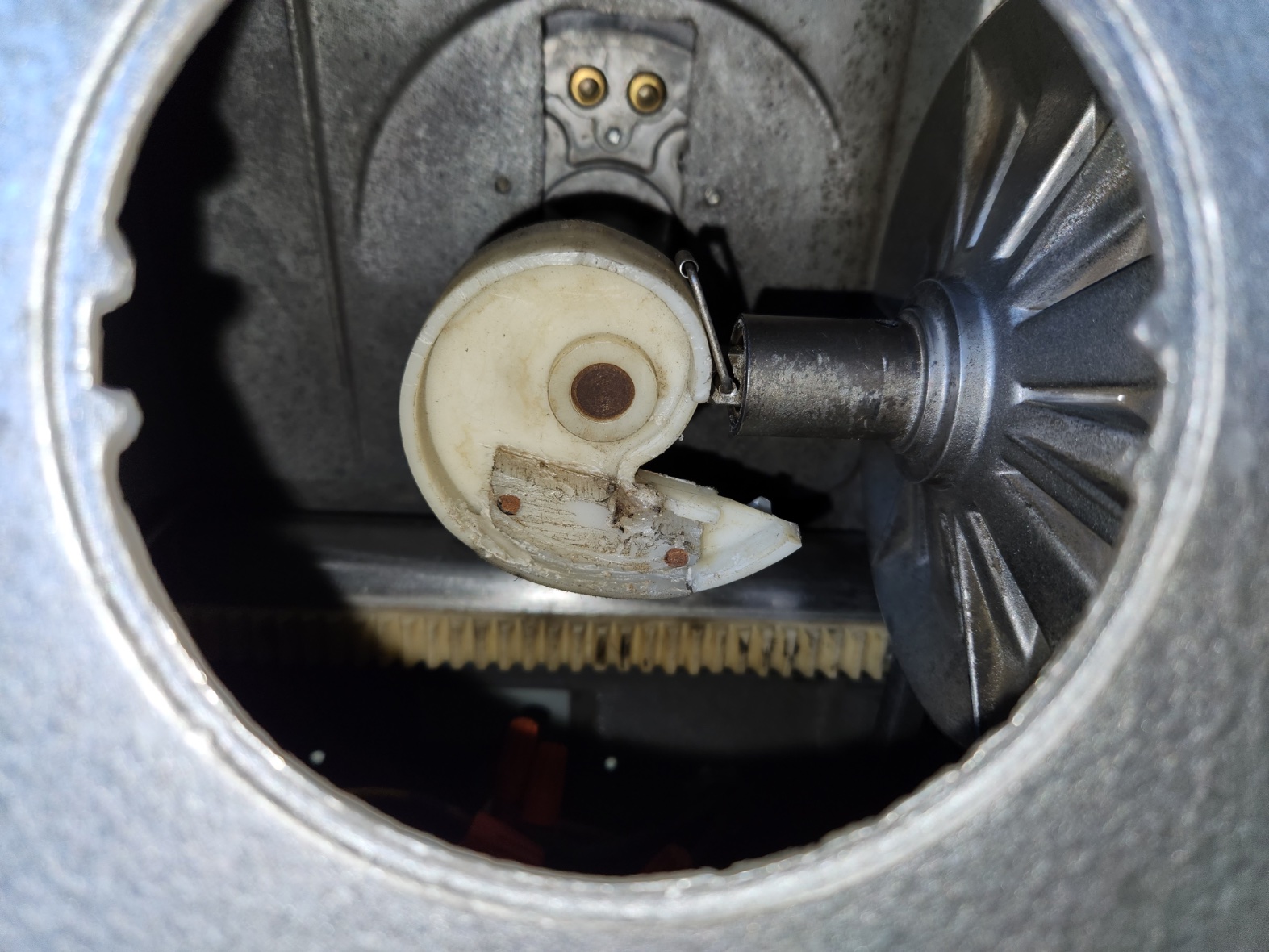

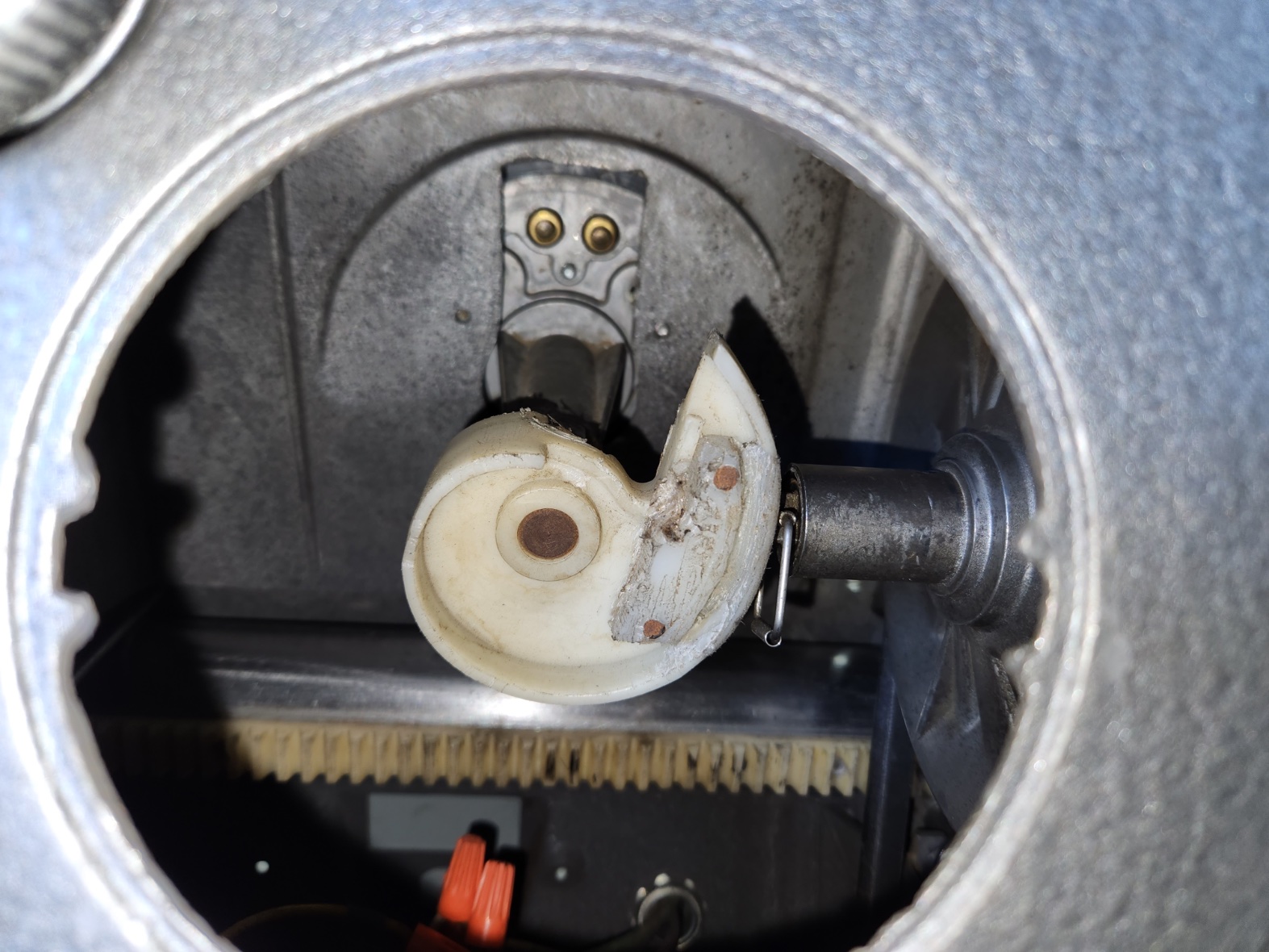

Today I realized that the reason the Mk VII was functionally one speed yesterday wasn’t interference with the crappy cam at all. If you look at the last pic I posted you will see that one of the detent bumps is trapped and unable to release and allow the dial to turn. Makes you wonder why the have that much adjustment…. ???
I still thought the pins in the follower were catching on the cam so I removed them and polished the bearing surface of the follower.
I tried it with no pins. (Does anybody know what they are supposed to do? The big spring on the motor shaft returns the control sheave.)
Anyway it worked better, and even better when I ditched the follower all together and tried the Mark 5 button bearing.
I now have very nice control over a truncated range. I have no doubt that shortening the spigot on the Mark 5 control sheave and re-machining the bearing seat will give me full range. Right now I can smoothly go from about 750 to 3900 even with the cam I have. The 3900 end is dictated by the high speed stop pin on the dial. If the control sheave spigot was 1/4” shorter the pulley would open 1/4” further at the same dial position, likely getting me close to 5200 rpm.
There is also room to adjust the high speed stop but that is fine tuning and can be left for later.
The take away is……. You can sub in a Mark 5 (or V) control sheave on a Mark VII, button and all, and have a range of 750rpm to about 4000rpm with no modification at all.
The pics show the cam positions at 750rpm and 3900rpm.
