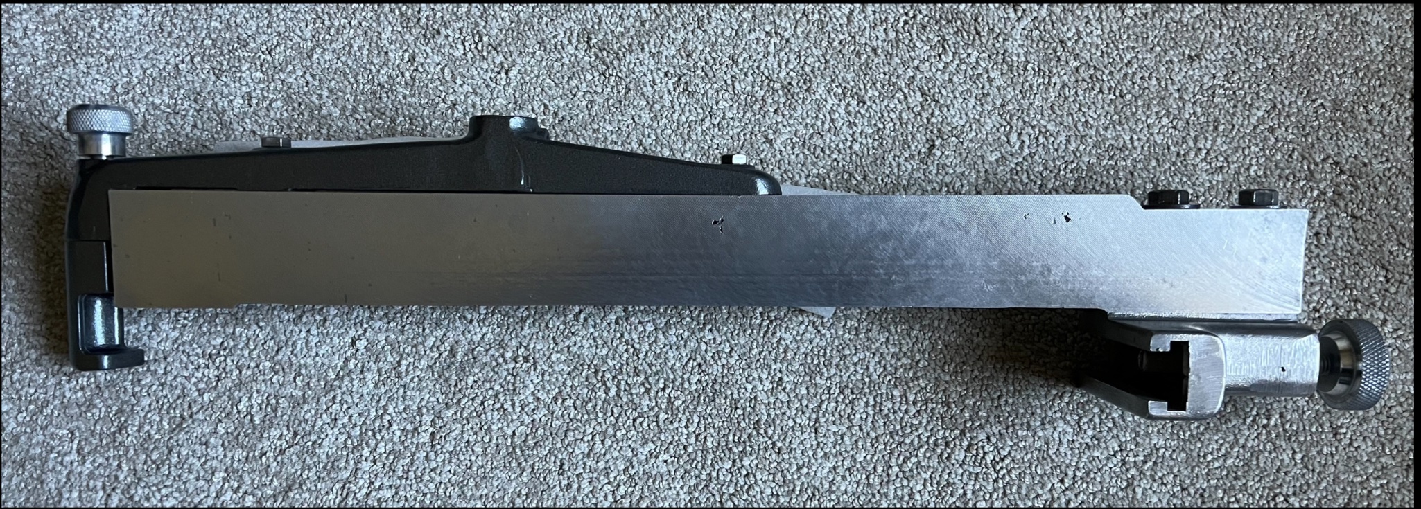

There was an accessory that was made to retrofit the original table fence with a rear hook, but those are very rare and hard to find, so your best bet may be a 10er fence. Here’s an example of the retrofit:

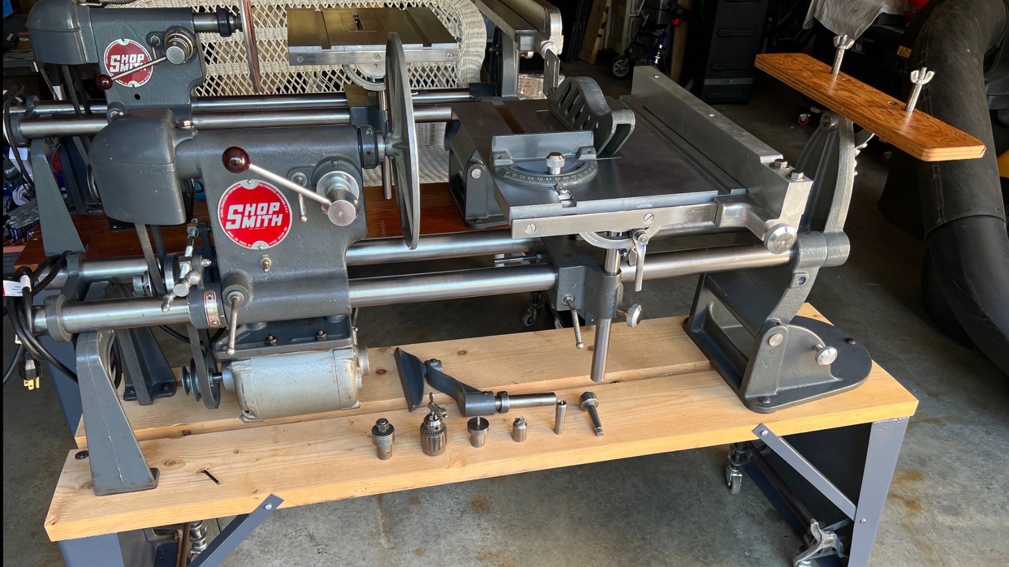

And while it has some quirks, don’t dismiss your 10e as not being a lot of fun to use just as is. Here’s mine all fixed up - works great!
