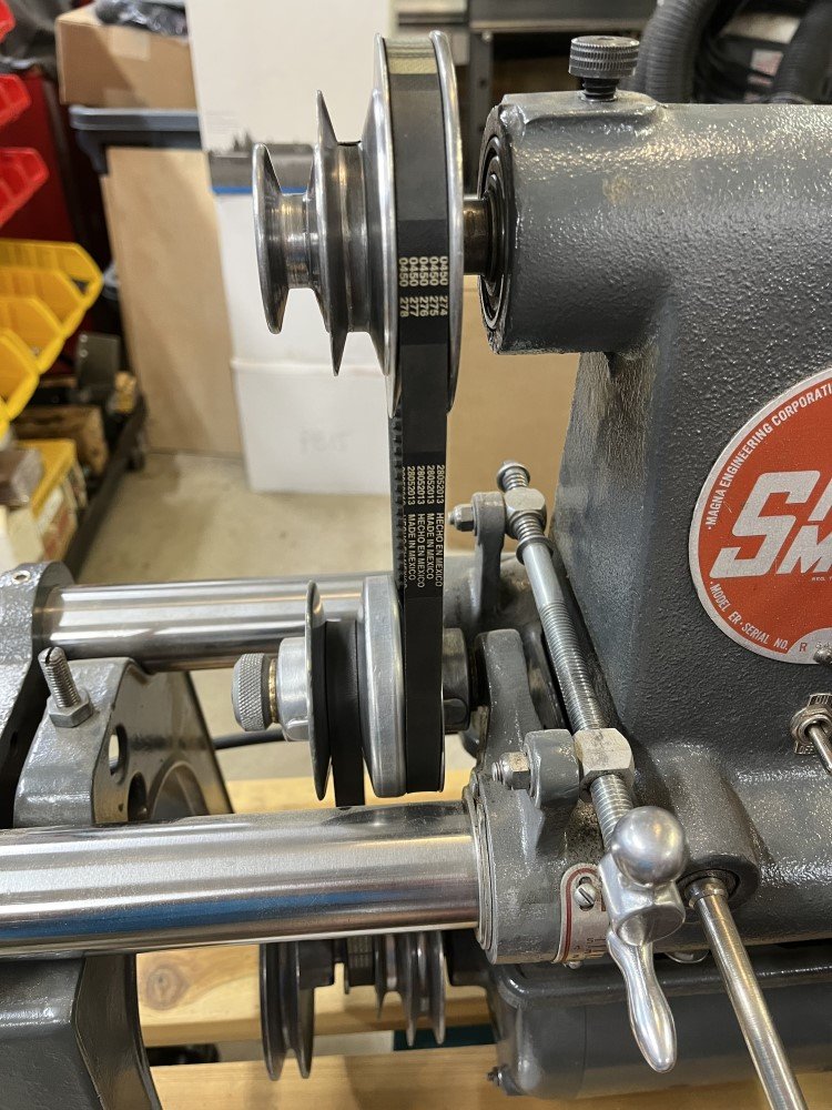

A possible cause is the spacing of the Floating Pulley Assembly. The outside sheaves should have the one belt almost touching the shaft while the other runs close to the outside edge of the pulley. If the one belt is touching the center shaft that could cause slippage. Are the belts sitting close to even with the outside edge of the Headstock and Motor Pulleys? In the picture below the Belt on the Headstock is just shy of even with the outer edge of the pulley. Those are new belts in the picture. Again, belt widths may vary. A narrower or worn belt will sit down further into the pulley.
