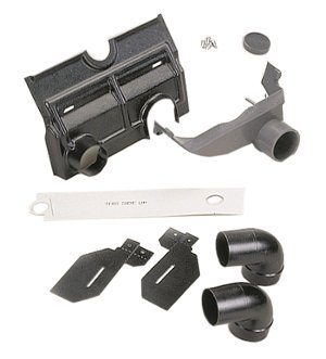

The first version of this Saw Guard had a single 1-1/4" Dust Chute. Not very efficient. An upgrade was made to provide two 2-1/2" Dust Chutes as seen on the following picture of the revised version.
_
Below is the upgrade parts to convert the earlier version.

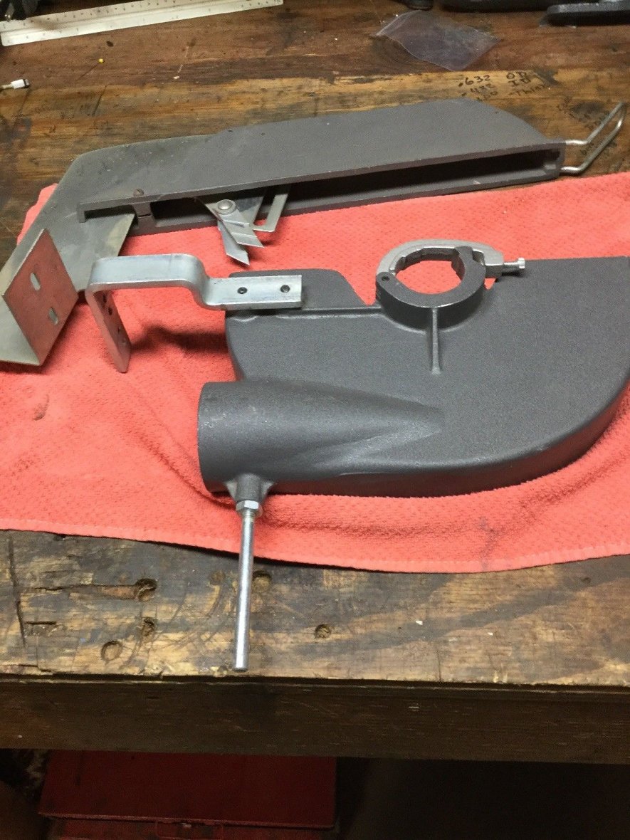

The Upper Guard attached to the Table Post/Tie Bar which is the only Mark 5/V 500 Saw Guard that does that. All other Mark 5/V Saw Guards, including the one for the other Mark V models, have the Upper Guard attach directly to the Lower Guard. The one disadvantage of the 505875 Saw Guard Assembly is that the upper Guard attaches to the Table instead of the Lower Guard so it cannot be used for the extra Table Slot your Mark 5 has.
Going back to the next earlier Saw Guard is the all metal one, part numbers 505627 (upper) and 505628 (lower) shown below.
