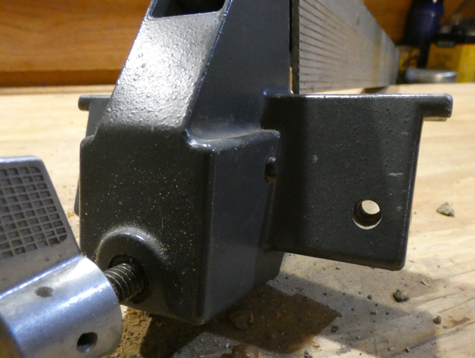

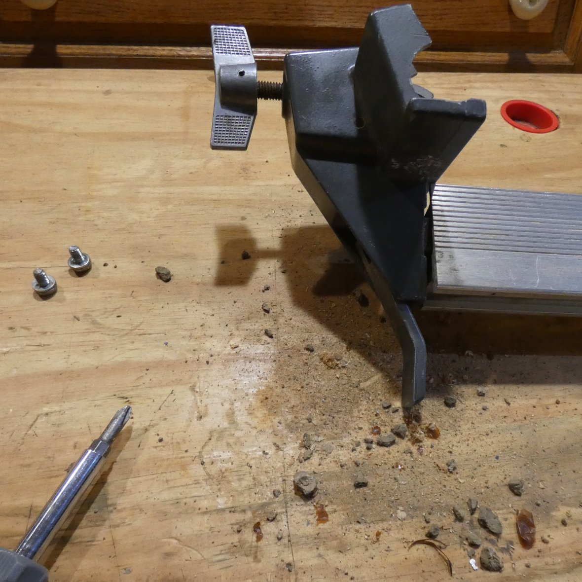

Used the table saw fence for the first time couple days ago and when removing the fence noticed a slight rattle when fence was tilted. Took fence apart and found that during use the vibration had dislodged some old mud dauber nests. During reassembly I noticed a threaded hole (shown in picture), so I then found that it accepts the set screws used in many other places. Looked in the owner's manual I have and found it shows a fence that has two threaded holes rather than the one that my fence has for a set screw used to align the fence parallel to the slots in the table. Hoping that the proper length of set screw is still available.
