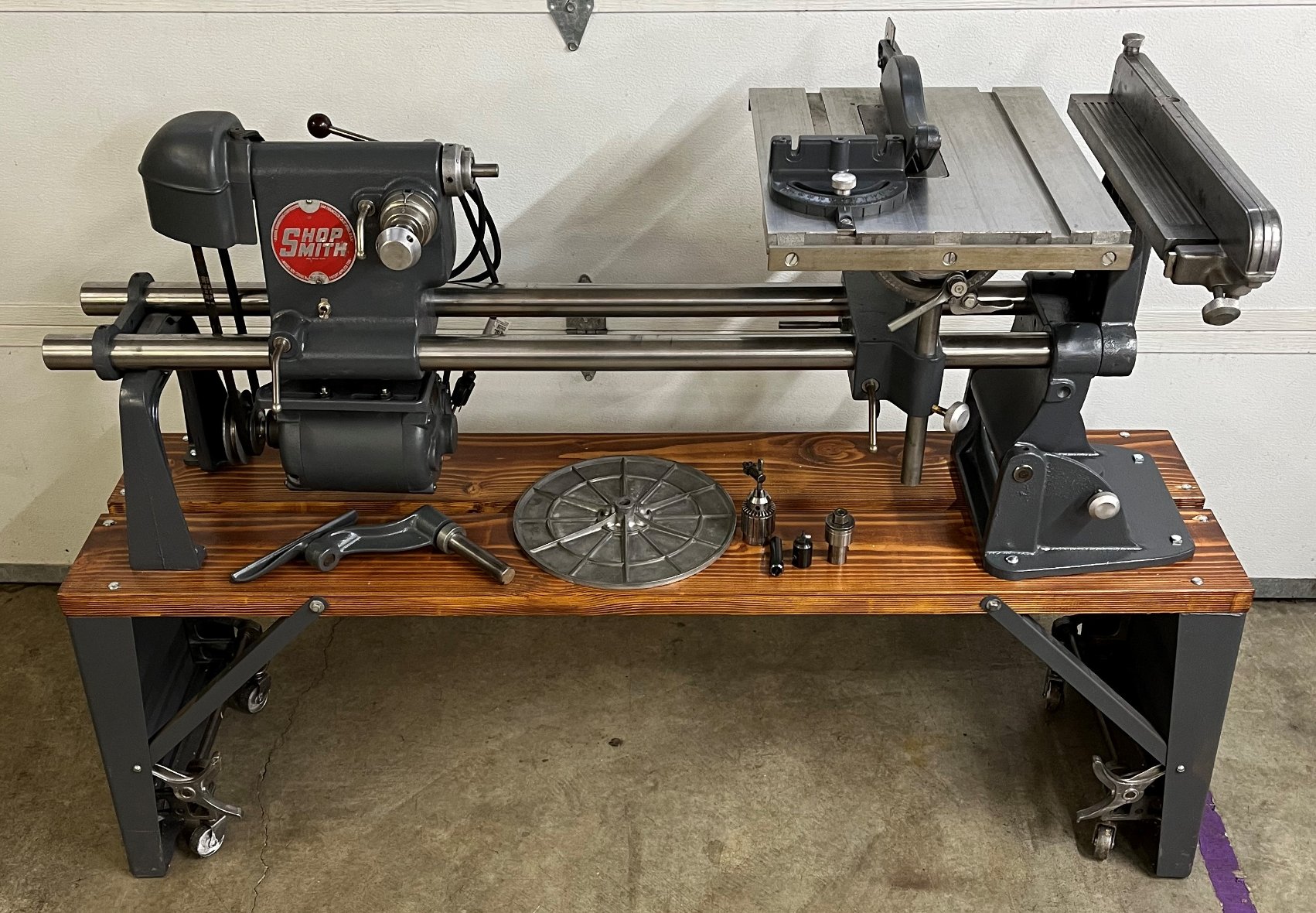

In the picture below you can see the common pattern for the Carriage Bolts to attach the Bench Boards to the Metal Bench Ends. This one is easier to see with the cut-off Base of this 10E. Normally the Base has a centered bolt hole at the end (see second picture below for the bolt hole position) that goes through a hole in the Metal Bench End. This was true for both the larger Base and the later smaller Base. There is bolt holes in the top of the Metal Bench Ends for the Headrest to attach through. When the smaller Base along with the two Bolt Headrest came out the Bench Boards recommended length went from 60" to 57".
_

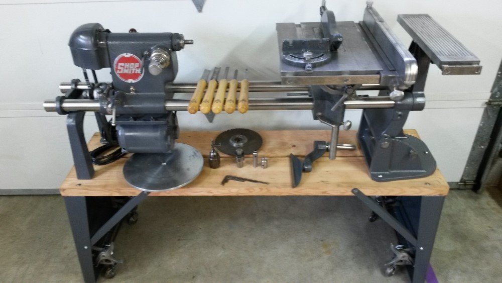

A normal Base can be seen on the Model 10E below. It also has the four Bolt Headrest.
_
The smaller Base with the two Bolt Headrest on a Model 10ER is below.
_
The Model 10's above are restorations I have done

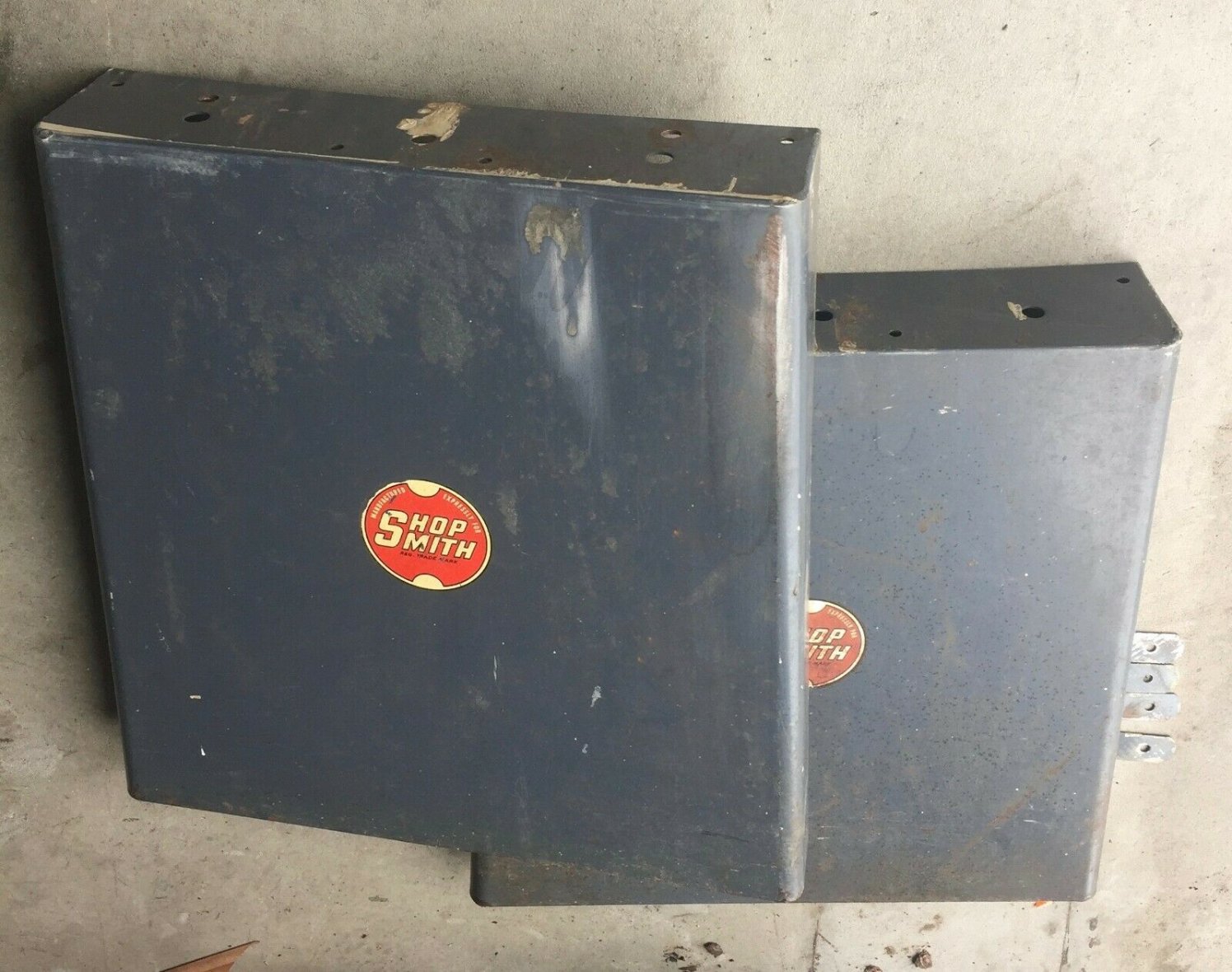

Below is an early set of Metal Bench Ends. The one on top has a couple of extra holes that have been drilled into it in line with the Headrest holes. The one on the bottom, half covered, has only the original holes. This early set does not have the Retractable Caster Mounting Holes but did come with the SS Logo Decals.
