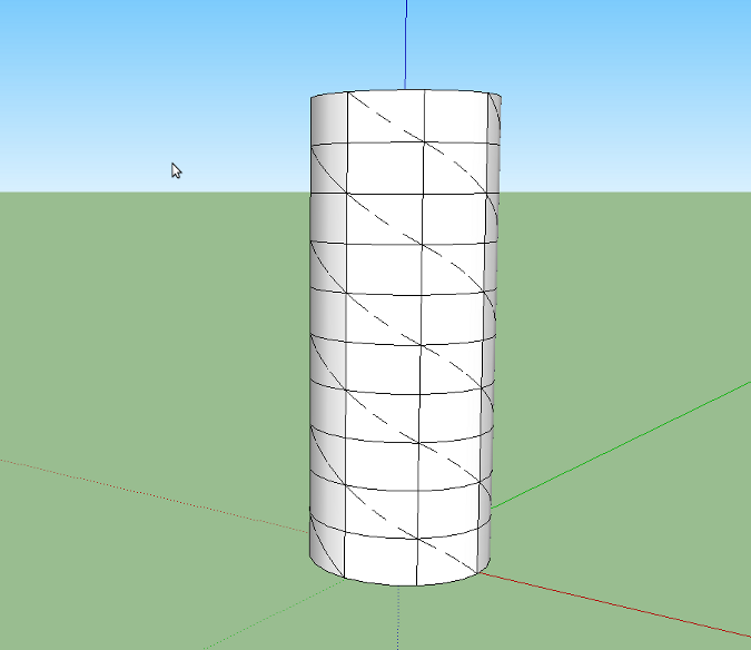

What I did after I rounded the post with a belt sander was to mark up a grid of rectangles around the post. Then I drew a diagonal line connecting the corners of some of the rectangles, continuing down the line. Using a saws-all reciprocating saw, I cut into the post using the diagonal line as a guide. I cut down about an inch or so for this. Once all of the kerfs were cut (I had four kerfs), I started shaping. Using rasps, a hand plane, chisels and dremel sanding drums I started shaping from in between the two kerfs down. So, centered between two cuts was the high point and I shaped down toward the bottom of the cuts.
I hope this image will show what I tried to say:

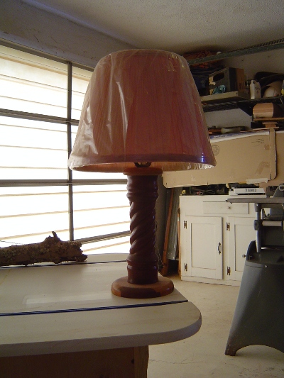

I used the same technique when I made this lamp with mahogany.
