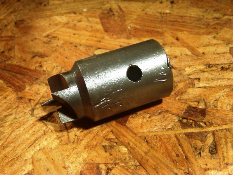

Here's what the lathe arbor looked like, pretreatment. Mmm Mmm...

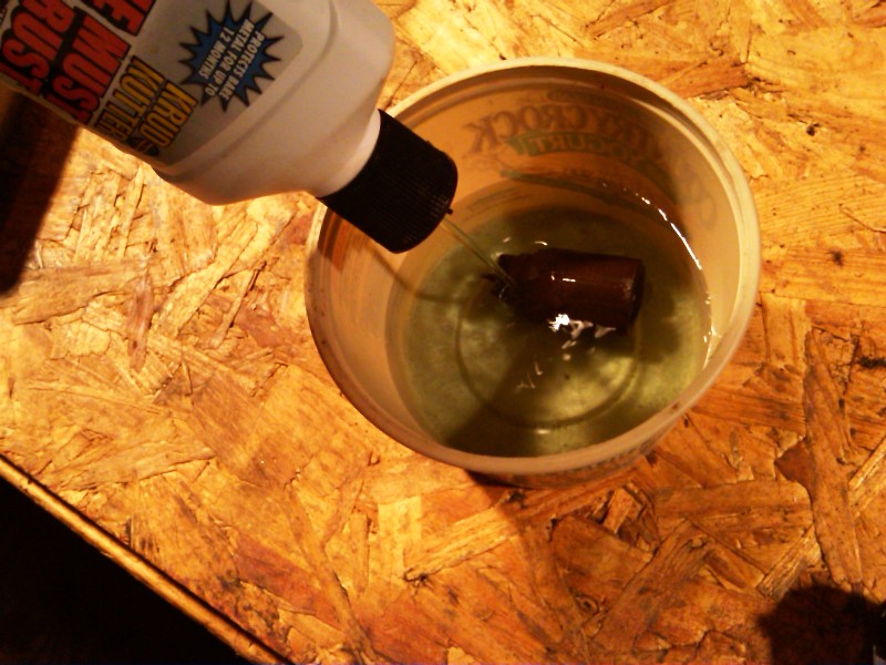

Adding the Krud Kutter to the water at a ratio of +/- 1:1.

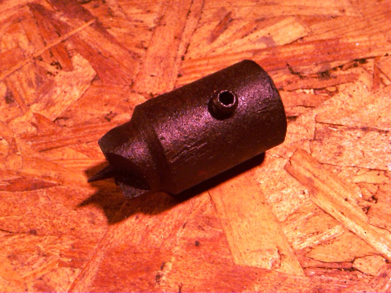

Right after pulling the lathe bit out of solution from its 24-hour soak. Man, that stuff smells like rotten eggs!

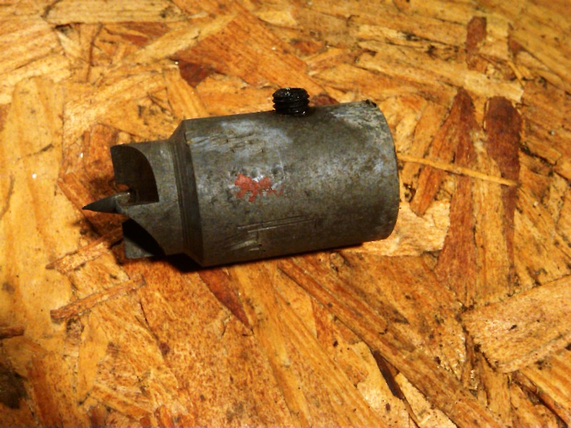

After hitting it with a steel wire wheel.

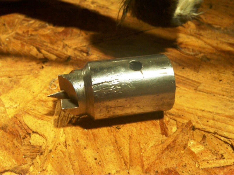

After a bit of filing and some white polishing compound (yup, I went to Harbor Freight today).
Despite the marring from Vise Grips or water pump pliers, it turned out pretty well. Moral of the story, soaking in "The Must for Rust" over night in a 1:1 water solution works pretty well and makes the stuff go farther. Plus, it removes rust deposits internally that abrasive wheels wouldn't be able to get at. The next step is to try Evapo-Rust and see how it performs.
