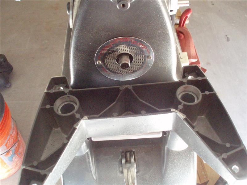

I don't do that anymore. Rather than adjust the eccentrics to position the spt shaft, I adjust them to position an inverted Mounting Base (505655) so that it aligns to the vertical line of the spindles.
To do this, you must first do it the hard way so that you can determine where the spindles line up with regard to the inverted mounting base. From then on, iot is a snap.
Pictures, I hope, are worth a thousand words:
[ATTACH]17664[/ATTACH]
Short end of the eccentrics are inserted into the Head Rest. Long end of the spindles are up.
[ATTACH]17665[/ATTACH]
Installing the mounting base onto the spindles forces their "alignment to one another". This spacing will then match the intended spt hole spacing exactly.
[ATTACH]17666[/ATTACH]
Use two flat screw drivers simultaneously to turn (position) the eccentrics. Turning the eccentrics will move the mounting base back and forth - in and ouit so that you can align the centering marks on the mounting base with the spindles. Once the mounting base has been aligned, lock the lock handle down on the eccentrics. You are now ready to install the spt and adjust the height.
[ATTACH]17668[/ATTACH]
I am making an alignment jig that will eliminate the need to eye ball spindle alignment. This jig will be used in lieu of the inverted Mounting Base.
NOTE: After your spt has been installed and the height adjusted, you could easily make spacers that would position the spt at the proper height. I do not believe this could be a universally sized spacer. I suspect differences between machines that would foul that plan.

dusty wrote:Rather than adjust the eccentrics to position the spt shaft, I adjust them to position an inverted Mounting Base (505655) so that it aligns to the vertical line of the spindles.
Brilliant. Original. Had no idea that there was a slot on (in?) the eccentrics.

I guess I am feeling a little dumb....I can see how the base gets the spacing between the mounting tubes correctly. Beyond that, I do not see how it helps to align the SPT. That is unless there is a 'centerline' reference mark on the base that conforms with each of the spt's centerlines. This reference mark would be aligned to the drive hub. Then of course, you will have to eyeball to align to the upper headstock drive shaft.:cool:
Rob in San Diego
SDSSmith wrote:I guess I am feeling a little dumb....I can see how the base gets the spacing between the mounting tubes correctly. Beyond that, I do not see how it helps to align the SPT. That is unless there is a 'centerline' reference mark on the base that conforms with each of the spt's centerlines. This reference mark would be aligned to the drive hub. Then of course, you will have to eyeball to align to the upper headstock drive shaft.:cool:
I think that that was stated in my post. This procedure must be done once, the hard way, to determine the proper alignment. Once determined, the mounting base needs to be so marked with that center line.
Eye balling the spindle position is not the hard part. Moving the spt to achieve what you have eye balled is. This procedure was intended to eliminate the need to manhandle the spt while making the spindle adjustment.
BTW, there are casting marks near the center of the mounting base but do not use those as the reference point for alignment to the spindle. You have to create your own and I suspect that every spt might be a little different.
NOTE: Don't overlook the fact that the drive spindle moves a little bit when you adjust the eccentric in the headstock (for belt tension).

Are there slots in both ends of the eccentrics? I guess what I am really asking is with the spt in place could the screw drivers be used from underneath to adjust the eccentric tubes?
