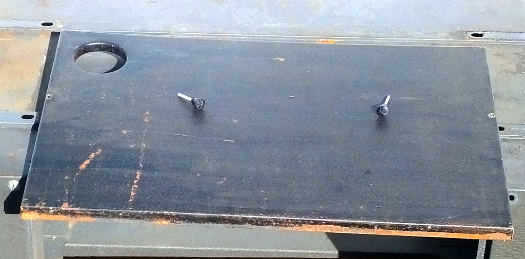

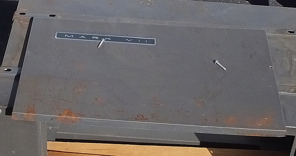

Rear panel removed first. Two plastic knob screws.

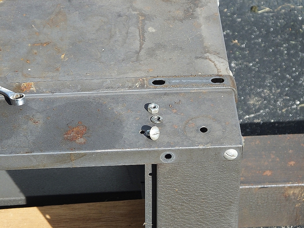

Next the front panel. Secured with 'normal' screws.

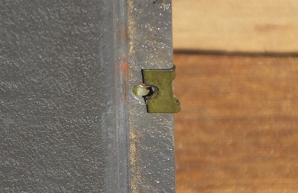

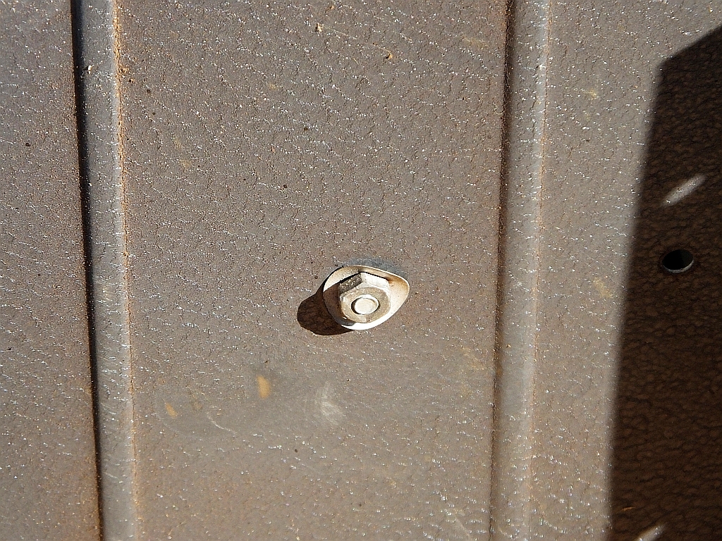

Front and back screws use tinnerman 'nuts'.

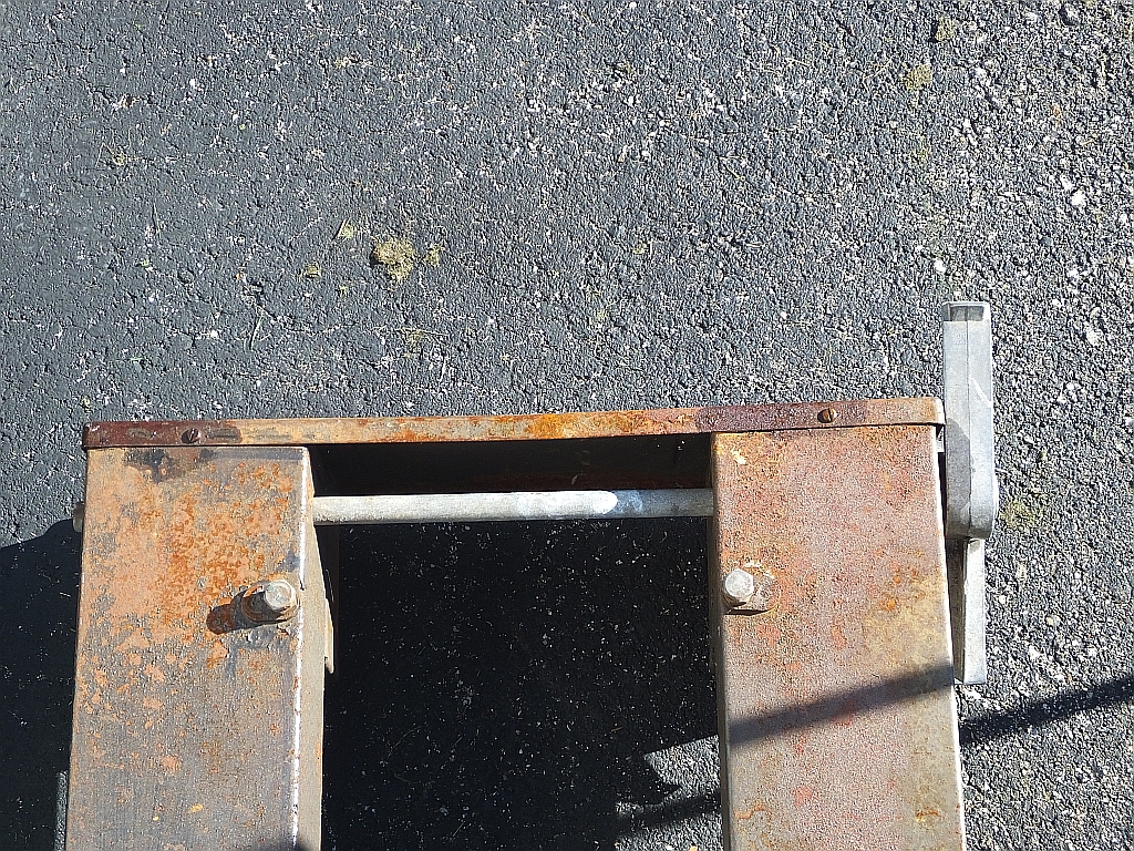

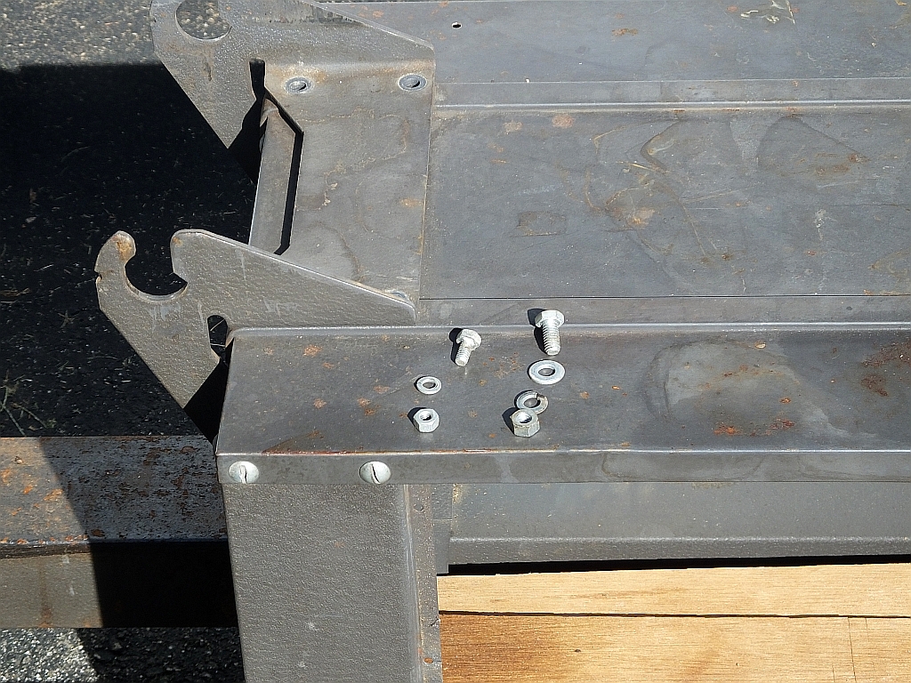

Next the tilt support bracket. There are screws attaching it to the side also. The larger screws on top, the smaller ones on the side.
Top screws.

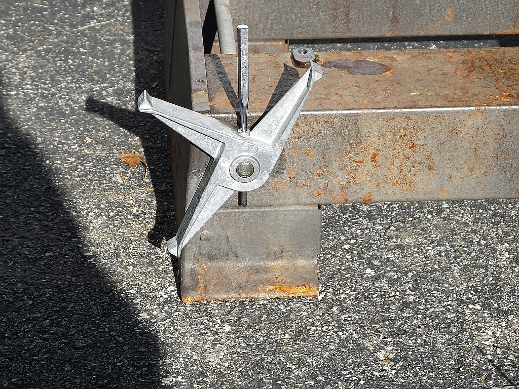

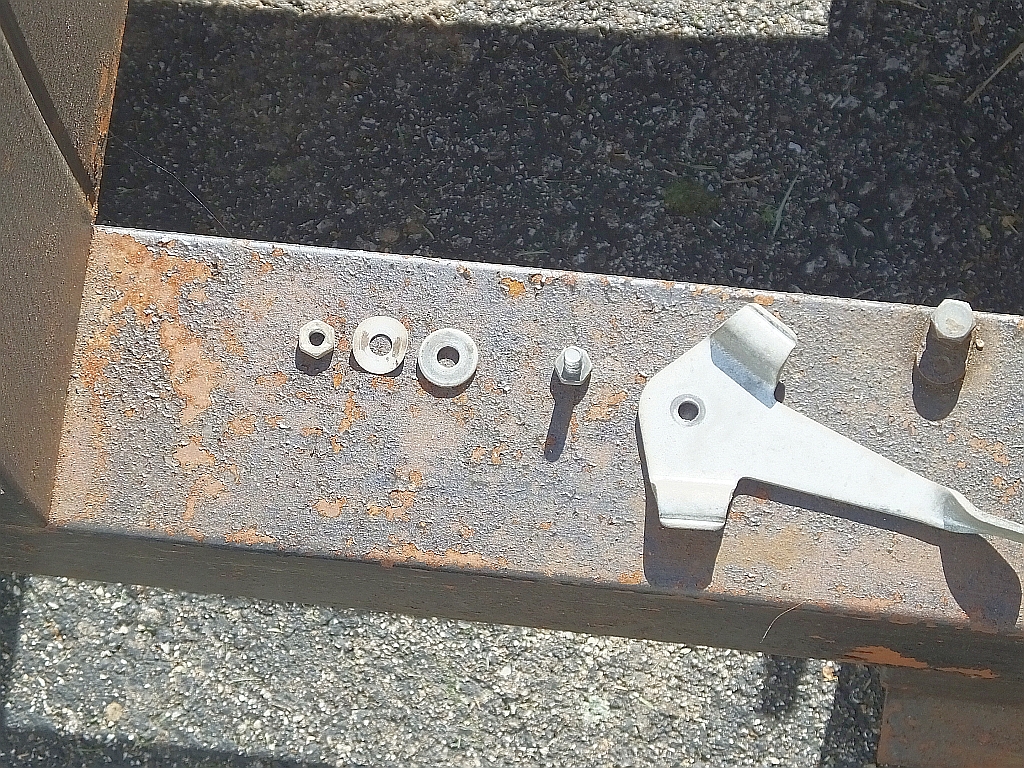

The vertical clamp mounts with a screw that includes a spring washer.
Clamp with screw etc.
From the bottom, the side retaining screws.
Screws out.

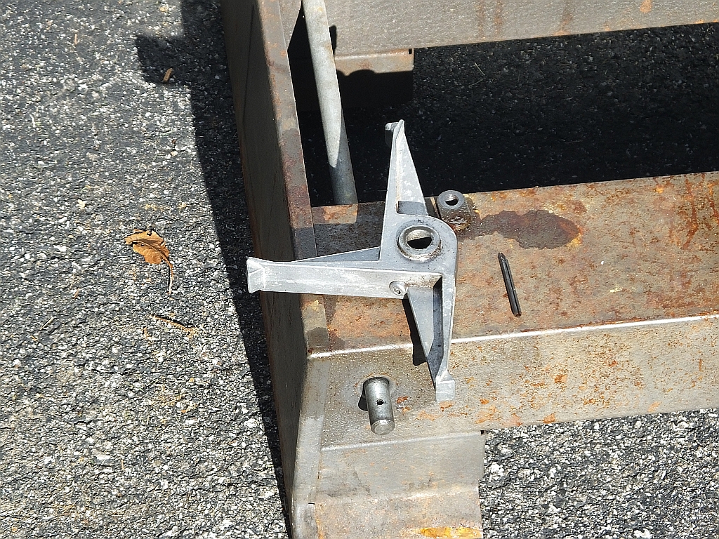

The tension pin is driven out of the foot pedal and cam shaft.
Pedal removed.

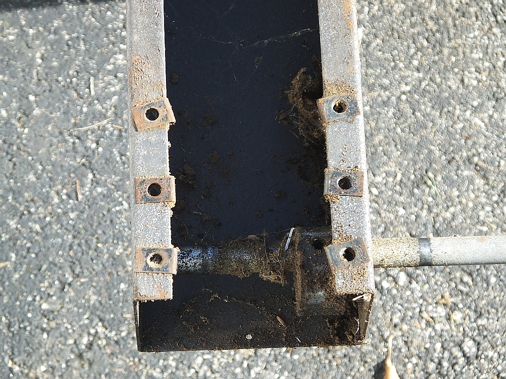

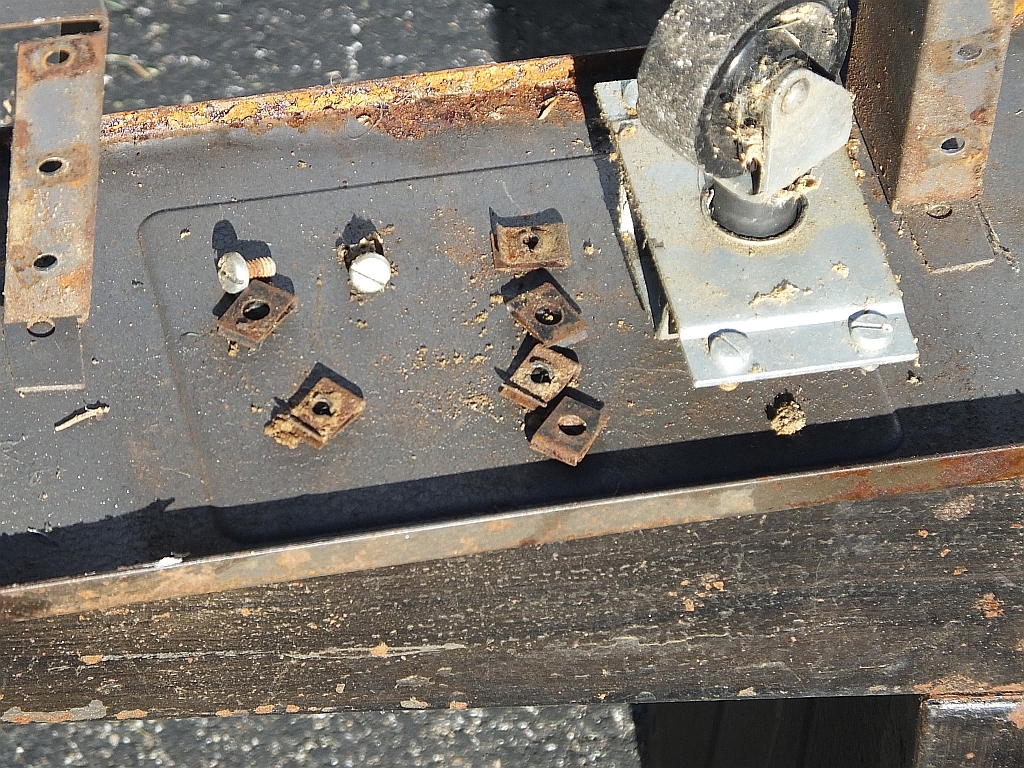

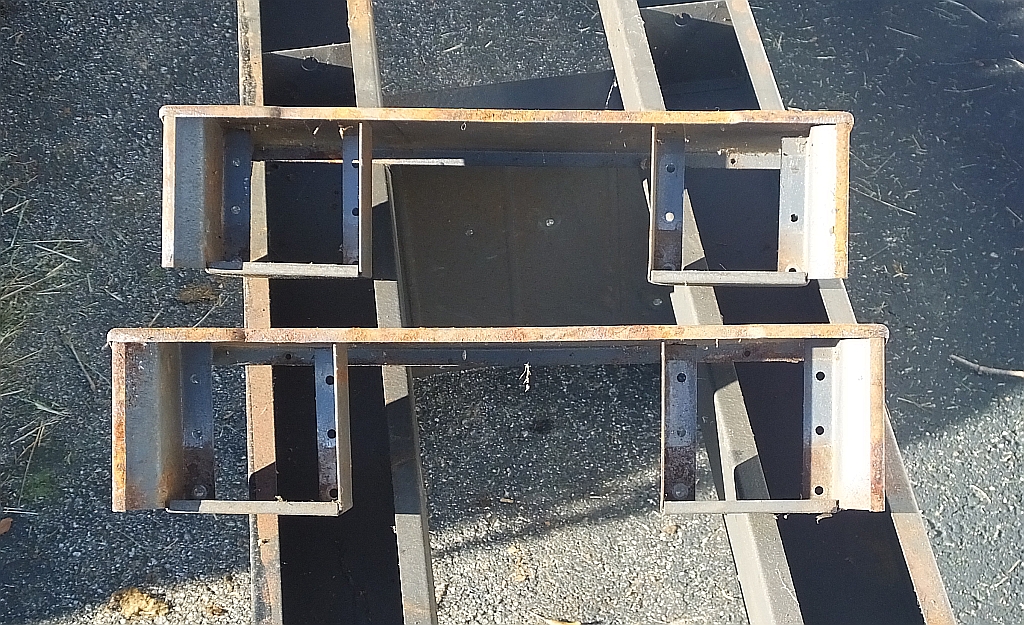

Six screws attach the 'box' and 4 secure the piston bore 'plate'. The 'box' is part of the end with feet.
Tinnerman clips serve as 'nuts' for those six screws.

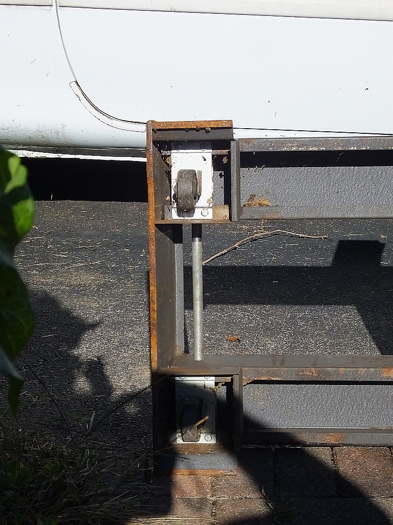

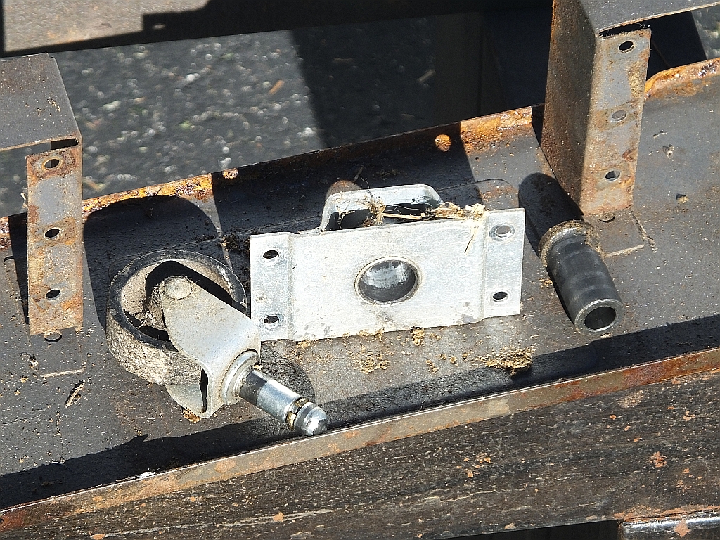

Clips, plate and caster removed.

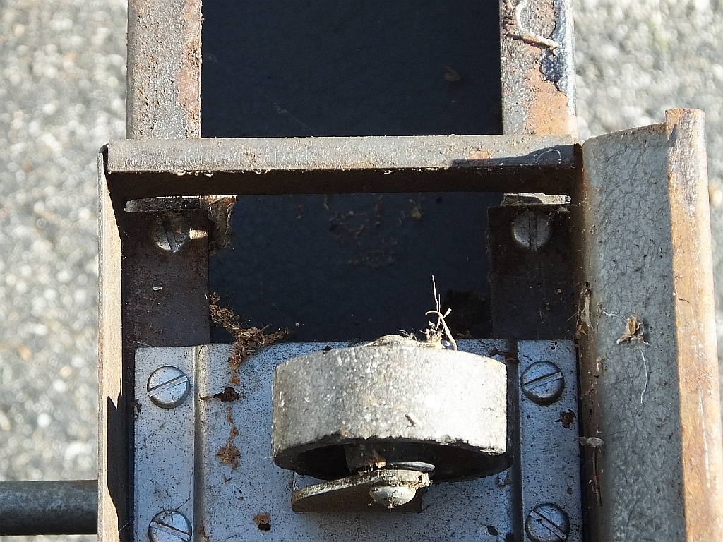

Piston has a lip on top, caster retains it from below.

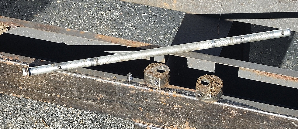

Cams are secured to camshaft with half dog set screws. Notice locating holes in shaft.

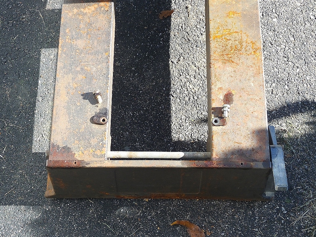

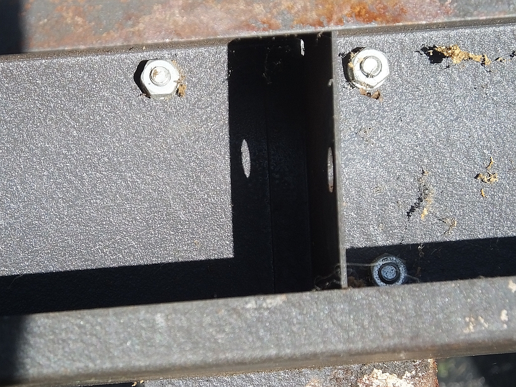

End/legs are the worst rusted parts.

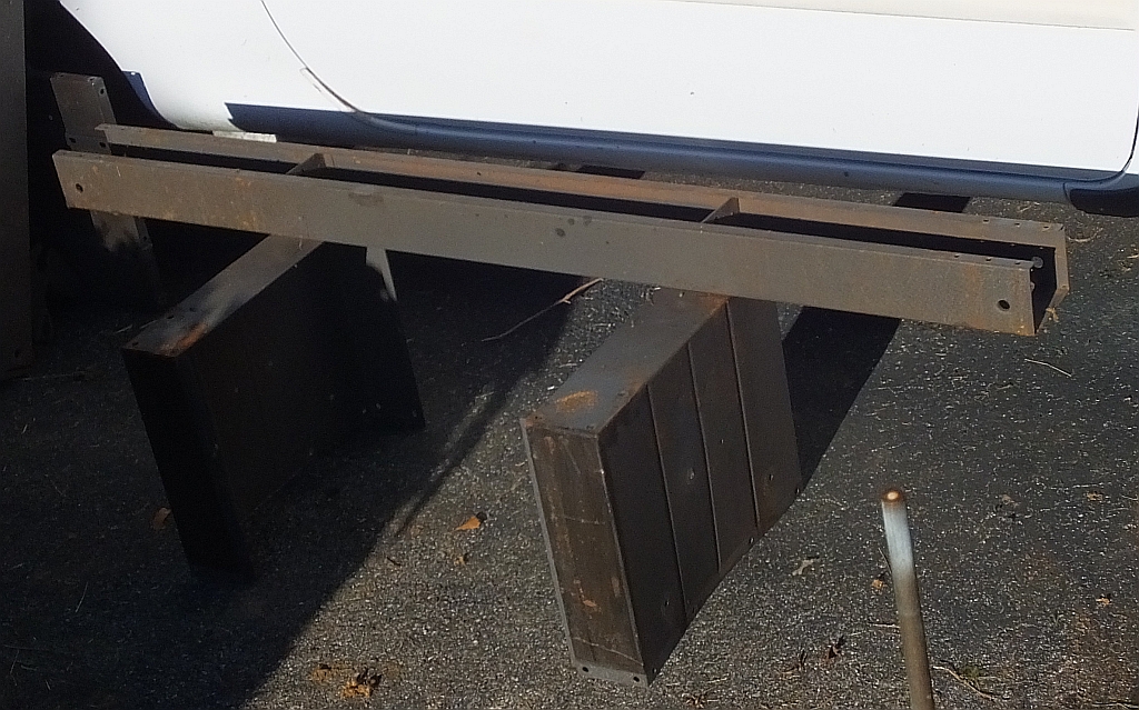

Last base rail. Kept the rails temporarily attached to the base 'box' ends to raise them up for disassembling the previous 'stuff'.

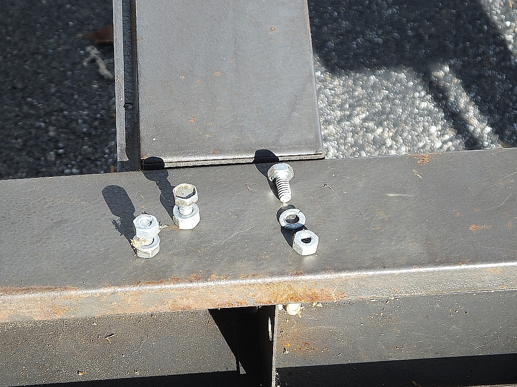

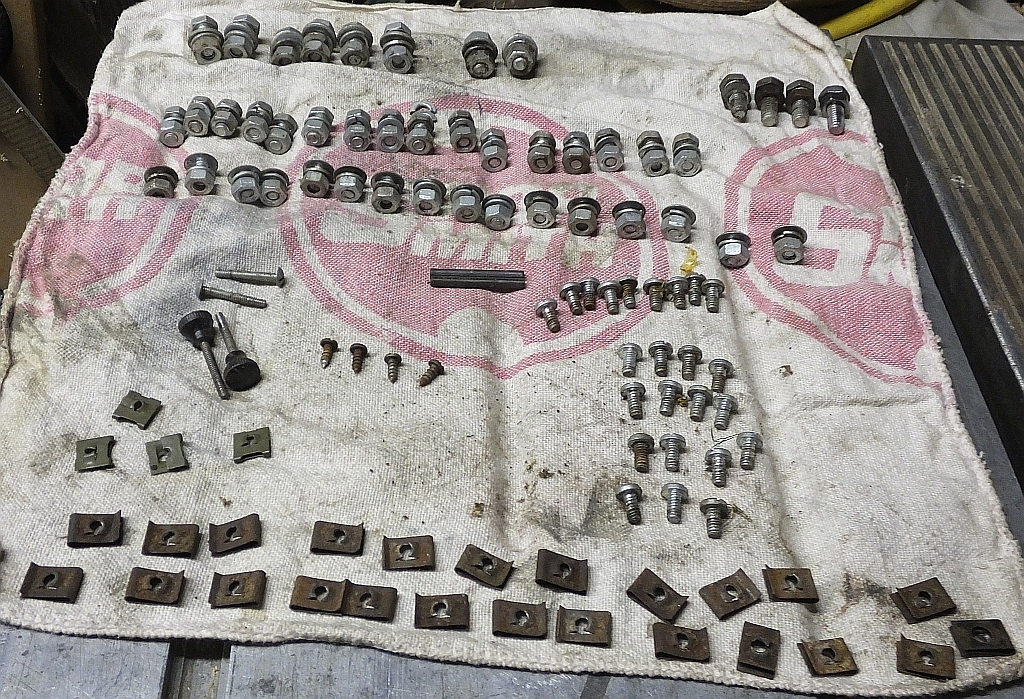

Last a pix of all the 'hardware' holding this beast together.
The vertical clamp pivot/mounting screw,spring washer and nut seem to be missing from the pix.
