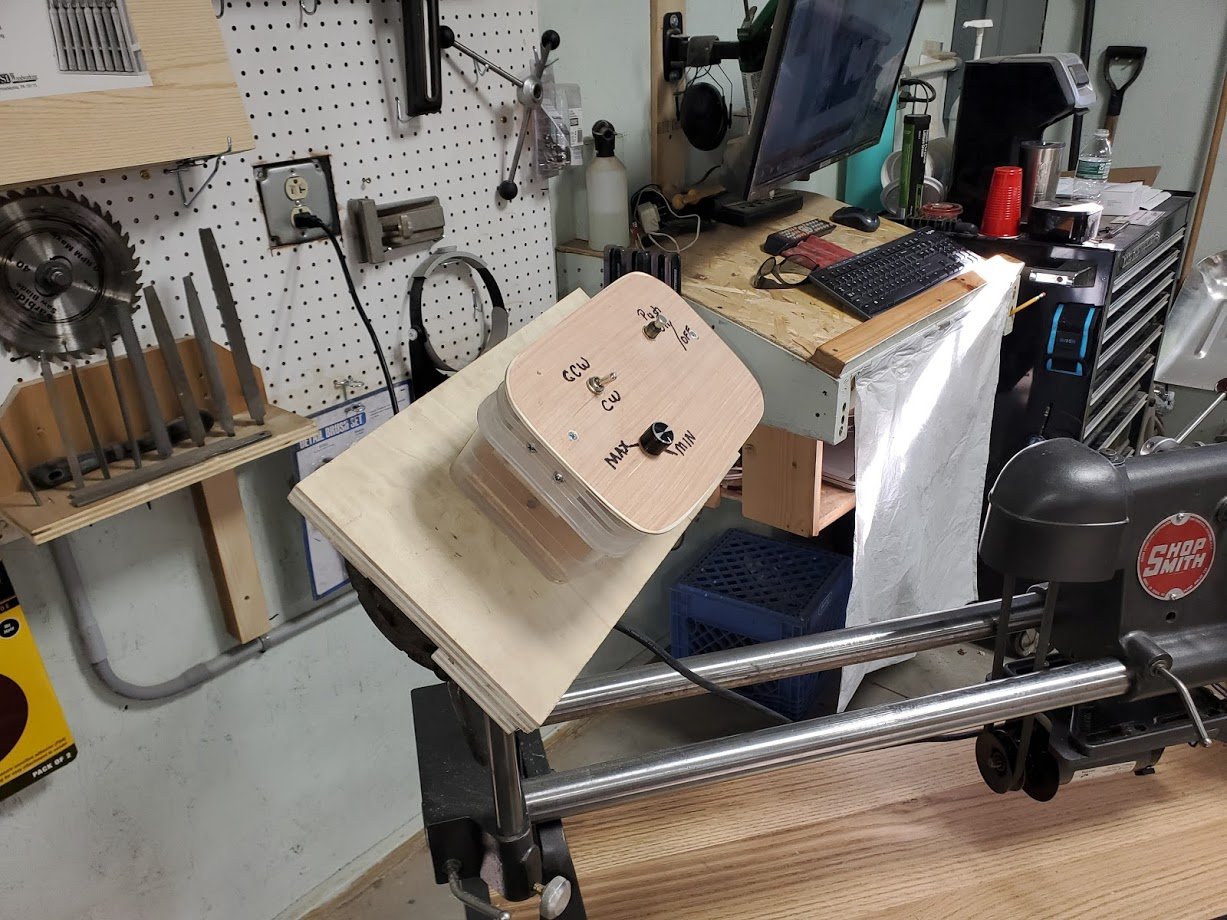

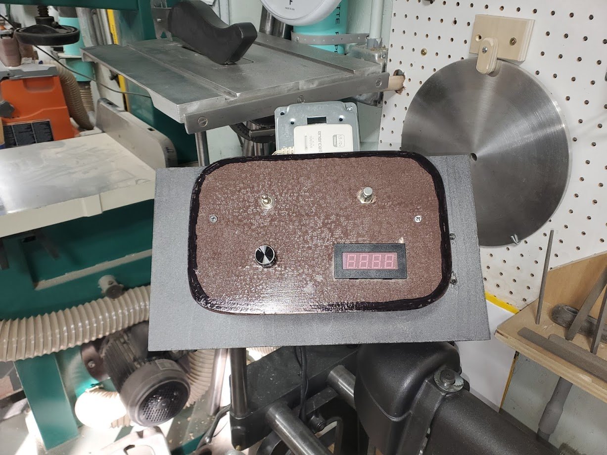

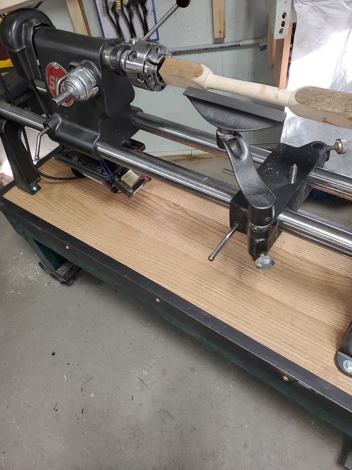

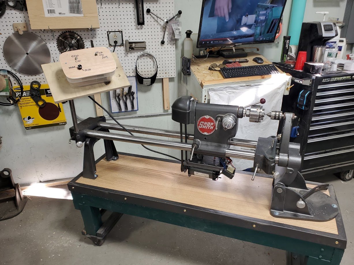

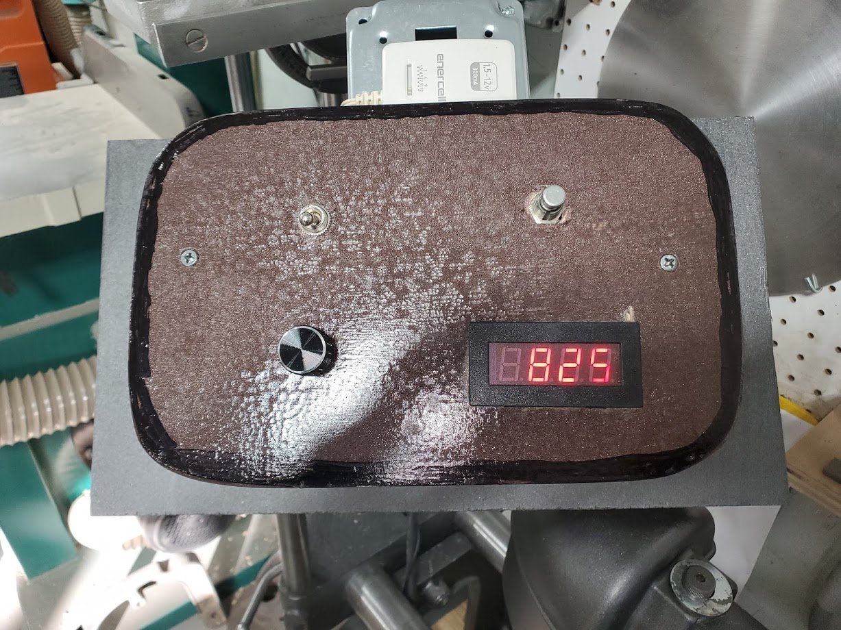

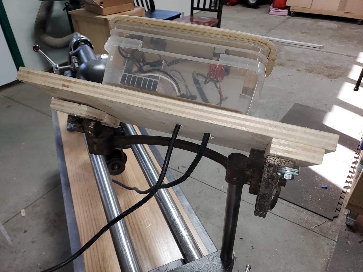

Good day today, I finally got the 10ER 12V-DC conversion completed. The control panel is all mounted and painted, the switches are all install as well as the Tach. Get this,,,,," Everything Works ".
Now I can start using the lathe to turn my first pieces. I will attempt Large Chess Pieces. Key word there is ATTEMPT. That is what I really want to do with this now. I want to thank every one in this group of great guys for all the help that you all have supplied to me. You made the conversion go allot easier than I thought it would have been.
My 10ER Completed

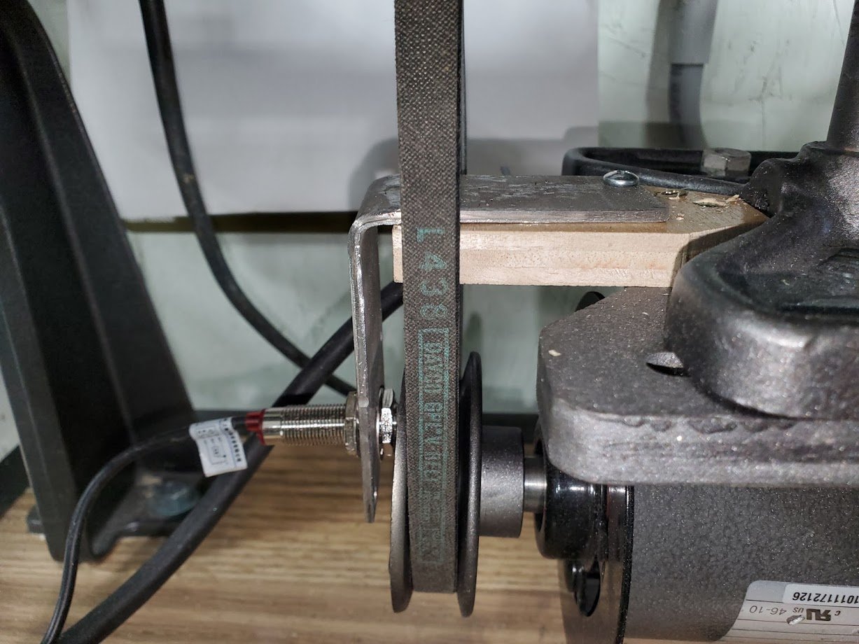

I am curious how it can read "2.5 RPM" using a 0.5 second sample time.
Re: My 10ER Completed
48 evenly spaced strips of foil on whatever is being measured, if I did the math right.JPG wrote: Mon Apr 05, 2021 6:13 pm I am curious how it can read "2.5 RPM" using a 0.5 second sample time.
- David
Yeah right !
Math is right also.
P.S. Methinks multiplying by 2.5 rather than 48 is relevant.
Math is right also.
