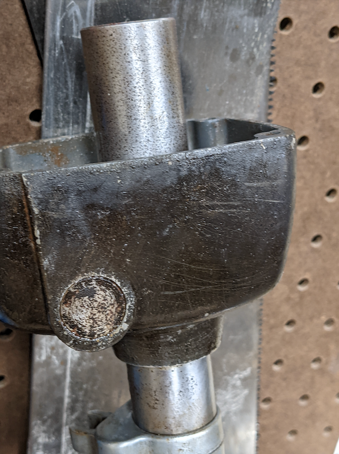

I'm restoring a Mark V 500 that was in a house fire, no direct heat or flames but it has heavy soot deposits on all the painted surfaces and a lot of the bare aluminum (picture below is about as bad as it gets, most other surfaces are somewhat better). I think the fire was about 10 years ago.
I'm wondering if anyone has a good suggestion for how to get those surfaces clean again? I tried soaking in warm soapy water and scrubbing with a stiff bristle brush - almost no effect. This stuff is tough. Mineral spirits on a cloth also did nothing.
Honestly my initial plan was to just do a functional restoration and not worry about cosmetic, but if there is a straight forward way I could get everything clean (not hours and hours of scrubbing) that would be nice also. One suggestion was to call an engine shop in case they have a bath I could put all the parts in but I'm worried that will remove the paint.
Any easy/quick solutions people know of? Like I said I don't want to open a can of worms, so if the only options include hours of scrubbing or risking damage or repainting, "just leave it alone" is a solution I can also accept.
Thanks!

Re: Cleaning sooty aluminum and other parts?
Fireplace cleaner?
Post by RFGuy »
Have you tried a 50/50 solution of white vinegar and water? If it is soot then this mildly acidic solution should work to help remove the soot with a sponge/brush.
FWIW, this is what I use on the glass in the door of my wood burning stove. It cleans it perfectly . Sometimes if there is burned on resin because a log fell against the door it is a little tough. it might work. I don't know. It might not work so well on th rough painted surfaces.
https://www.amazon.com/Rutland-Hearth-G ... B01N4NNNMB
Post by eagspoo »
Tried Barkeeper's Friend and it worked ok. I'll also try Rutland, thanks for the tip!
Post by eagspoo »
BTW @jsburger, Rutland was perfect for this job. No idea how it works but it took the soot right off. Looks dramatically better.
Great! I had no idea if it would work or not. I just know it cleans the soot off of the glass in the door of my wood burning stove.
Post by RFGuy »
You may want to rinse the parts afterward to neutralize the strong acid in this product. Otherwise it may eat into the paint if residue is left on it. Just a thought...
