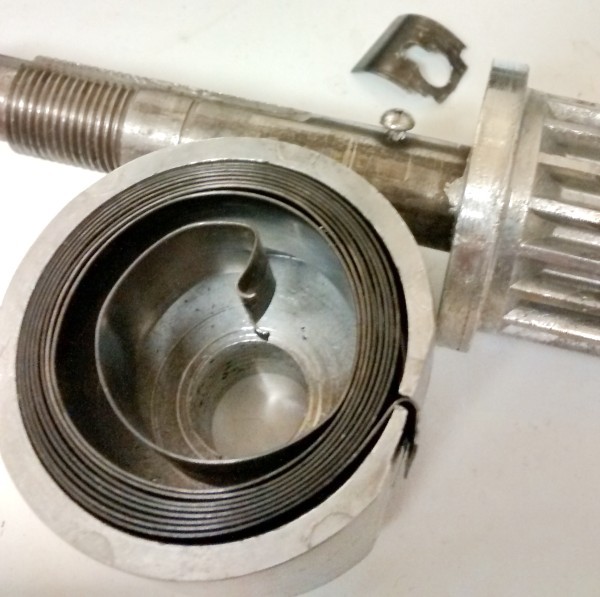

JPG - Wow, I'm afraid I just don't follow. My spring has a separate little piece of similar spring metal that it catches in turn on and that catches on the screw head (or similar item) sticking out of the shaft. Oh, I think you describe making a spring that doesn't have that piece end up working somewhat like this, where it catches automatically.
You can see that separate piece in the photo...
[ATTACH]24810[/ATTACH]
Quill Spring.jpg (75.54 KiB) Viewed 21912 times

I just had my spring housing out too, I am in the same process as you on replacing bearings on the upper spindle on a 57 greenie, and cleaning it up. In the process the quill hadle was not locked and the spring unwound and became disconnected from the pin. BUT my spring is "1" piece, the key lock end is part of the spring. I wont say your end is broken off because in the pic it is so symetrical, the "ears" on both sides of the small piece. I have seen 2 pieces that have ears like that and interlock under "pull apart" tension, but not on a spring in a housing like that. It seams/looks impossible to do that, then lock the piece on the pin, and get it all (main part of spring) under tension again once installed.
I wonder if that piece broke off uniformily, for what ever reason. I am not an expert and have no real experience with springs and the type of steel that is used and how to work with it. Mine was as clean as your pic when I opened/removed the shaft it sits on. I do know this, that springs of that style, when wound and all the "layers" are tight against each other, can rust together, if not being used for long periods, depending on humidity or H2O contamination, (wound tight, then unwound), if it does not have a light coating of some type of lube/anti corrosion substance on it.

Fitz, the small end with the key hole has broken off, the spring should be all one piece.

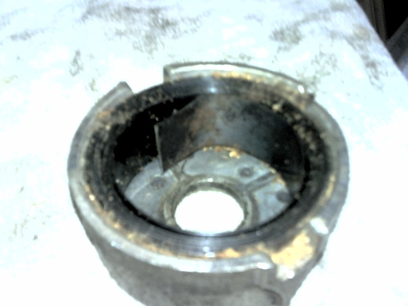

The quill spring on one of my 10ERs was broken like that.
[ATTACH]24816[/ATTACH]

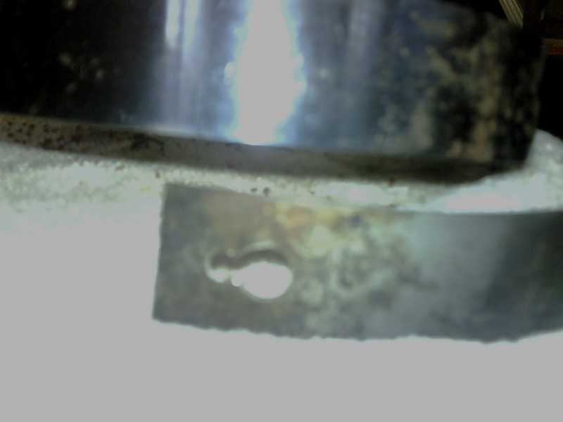

I took the spring out of the housing and drilled a new key hole.
[ATTACH]24817[/ATTACH]
Drilling was easy. I left the little points where the two holes intersect, this worked out well as it snaps on to the pin and resists coming loose.
While the spring is out of the housing you can clean and lube it properly. Wear gloves when you rewind the spring.
quill spring broken.jpg (65.67 KiB) Viewed 21895 times
quill spring redrilled.jpg (43.55 KiB) Viewed 21902 times

It's funny, I don't doubt that it is broken but it actually works well this way. The part hooks on the pin and the spring caddy he's on the part so well I wondered why they changed it when I saw the video of the guy struggling to hook the spring on the pin! I suspect a previous owner may have bent the spring so it catches this way after it broke.
What you see in the photo is after I cleaned it up a bunch.
