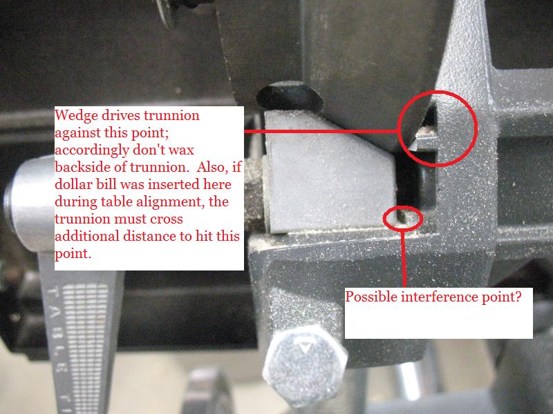

I wanted to get my eyeballs on my own before responding, Dusty. I've never had a problem with it slipping, unless I forgot to tighten it. And it doesn't take much torque on the locking lever to lock it up good and tight.
The thing is a friction lock. So if it doesn't lock, the immediate cause has to be either 1) an inadequate coefficient of friction, or 2) inadequate normal force on the clamping surfaces.
#1: You said that you have cleaned it, to no avail. And I doubt that even JPW would reduce the friction enough to keep it from locking, so my hunch is that #2 is the problem.
#2: If something else is stopping the brake travel before it locks down on the trunnion, you won't get the proper force applied. But it must be darned close in your case, or it wouldn't clamp at all.
The photo below shows my front trunnion brake in the locked position. I noticed that there is a ledge in the casting just to the right of the clamp shoe. The inside bottom corner of my front shoe is less than 1/8" from hitting that ledge, and the back is about the same. Any chance that yours is hitting it?
[ATTACH]26741[/ATTACH]

I'm hijacking and annotating Buckeye's excellent picture to make a point about this mechanism.
My understanding of how the table lock mechanism works is that
when the table lock is engaged, a wedge (one on each trunnion) are driven against the bottom beveled edge of the trunnion which creates friction at that point. In addition, the wedges force the trunnions inward toward the center of the table a fraction of an inch until the flat, backside of the trunnions contact part of the table bar/tube assembly which creates additional friction at that point. (When I used the dollar bill trick, the dollar bill went between the flat, back part of the trunnion and the table/bar tube assembly creating additional clearance).
If I am correct, wax on the flat back part of the trunnion would decrease friction that is needed to lock the table. In addition, the dollar bill trick means the trunnion starts further away from the table/bar tube assembly and the wedge must drive the trunnion a greater distance to make contact there. In that case, I see that ledge or lip in BuckeyDennis' photo (the ledge near the bottom right angle of the wedge) as a potential stop/source of interference.
This should be clearer in the the following picture:
[ATTACH]26742[/ATTACH]
