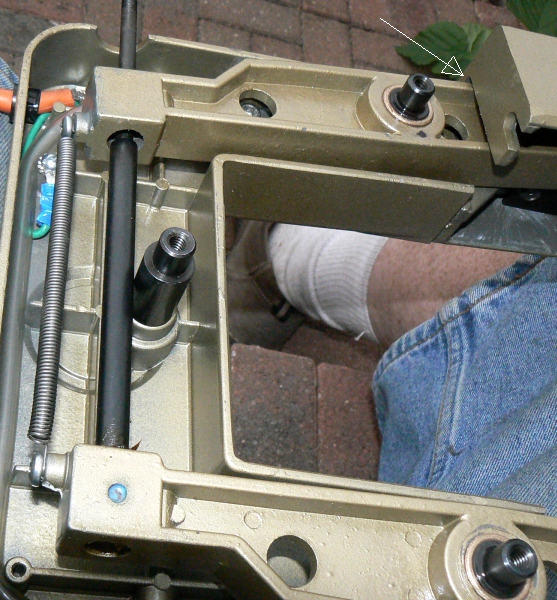

So today's adventure. I haven't used the scroll saw much in the last couple of years due to the issues I have had so when I mounted it and fired it up I noticed that the whole upper arm cover assembly is flexing. I did not remember that happening before.
I had it running slow because I had it apart and I wanted to make sure I had not put it back together wrong. Since this was a couple of days of waiting on finding parts and then loosing the spring and well other stuff so I was worried that perhaps I had forgotten to tighten the two inside upper arm screws. Decided to be safe and take it back apart to check.
Turns out they were tight. So got it back together again and readjusted. When I ran it again it is still flexing. When running at 250 rpm setting that has the saw running at 400 and it is quite easy to see. As you increase the speed it is very hard to notice but it is still happening.
So for those of you with the powerpro can you test this out at low speed and let me know if that is how the saw should act? I have a feeling that it is that way but at operational speed it is just not noticed.
So then I found a new problem that I have. Now that I know how to tune the blade to the right tension the blade likes to pop out of the mostly upper holder. The saw has the new blade holders with the little lever handle. To be honest they hurt my fingers when I try to tighten them...... age related issue I think. So after having the top pop out 3 times and the bottom once I'm not loving those handles.
Now with the old system in all the times I used the saw I had a blade come out I think once. Since I changed to the new it seemed to be working fine too but since I was not getting the correct "C" tension I'm guess it was not as likely to happen.
I found a couple of the correct size allen head cap screws that seemed about the right length and installed them. Now with a 3/16 t-handle allen wench I can get them really snug. The top is pretty easy to do that way but the wrench I have is to short to work well on the bottom. Will see if I can get a longer one this weekend.
The test cuts are working well and I'm about ready for a project. Perhaps tomorrow.
Edit to fix incorrect information.

Flexing? I doubt that.
Rocking more like it.
Remember the pivot stuff that the tension rod presses against?
Lotta conjecture here!

See revised description above.
I will try and shoot a movie of it tomorrow.
JPG wrote:Flexing? I doubt that.
Remember the pivot stuff that the tension rod presses against?![]()

As promised a video of what I'm seeing.
https://www.youtube.com/watch?v=xSF3uCd4PHg
Yes all fasteners are tight and I took it apart again to make sure they were. I think this is common but unless you run it slow it is pretty hard to see.
