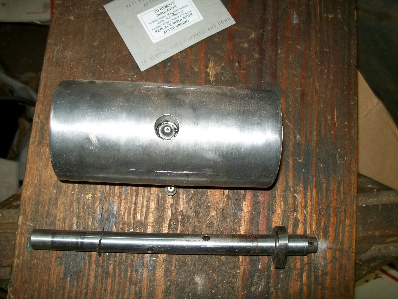

The grease mixes with the sanding wood and sanding belt dust make a harder mixture for around the drive shaft. I believe you need to disassemble, clean and grease the drive shaft every year or two as most drive shafts really show wear when this is not done. My solution was to add a grease fitting to the drive drum. I added 3 alternating holes in the drive shaft so the spring would get lubricated at the same time.

billmayo wrote:The grease mixes with the sanding wood and sanding belt dust make a harder mixture for around the drive shaft. I believe you need to disassemble, clean and grease the drive shaft every year or two as most drive shafts really show wear when this is not done. My solution was to add a grease fitting to the drive drum. I added 3 alternating holes in the drive shaft so the spring would get lubricated at the same time.
Thanks Bill! Since you mention the spring did you drill the idler drum? From what I understand they can be difficult to put back together so a grease fitting would be nice. Although Nick did just enough disassembly to lube the shaft.
