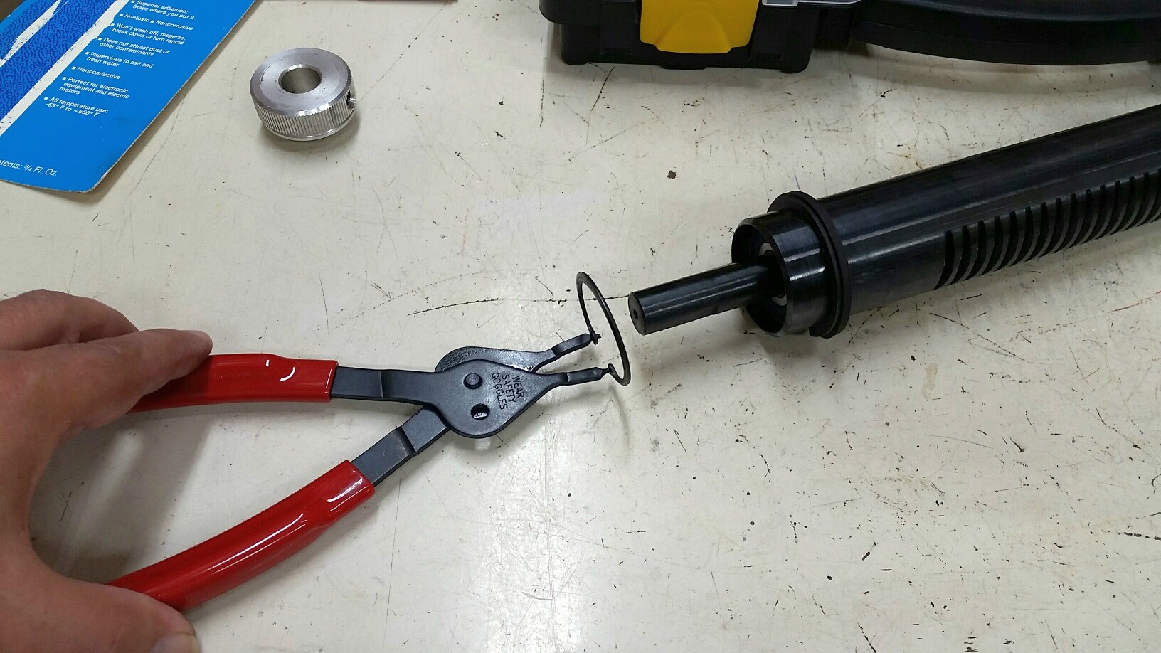

With the quill out of the machine you can start by collecting the tools you will need. Since I'm just pulling the shaft and not doing any bearing work the tools are your trusty 5/32 wrench and a snap ring pliers.
A quick side note on the snap ring pliers in case you are wondering which one to get. I have several sets, mostly smaller versions but for this project it is nice to have a decent size one. These are from Craftsman and the pair was about $20 as I recall. They convert between internal and external by way of moving the center screw. I've found them to be a good investment and they work well.
The first step is to remove the stop collar, the silvery item in the picture. This doesn't really hold anything in place anymore so replacing it is just as simple as sliding on and aligning the flat on the shaft with the set screw.
Next you will find a snap ring inside that holds the guts inside. This is where the pliers will come in handy as you need to remove it to get the shaft out of the housing.

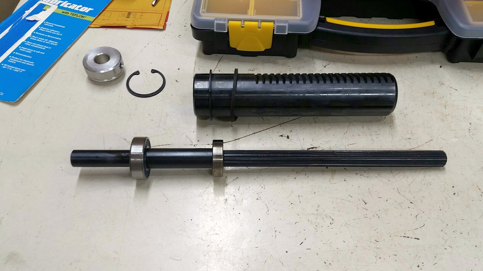

With that out of the way the shaft will come out the front with some light pressure.
You can now pull the whole shaft with bearings out all the way.

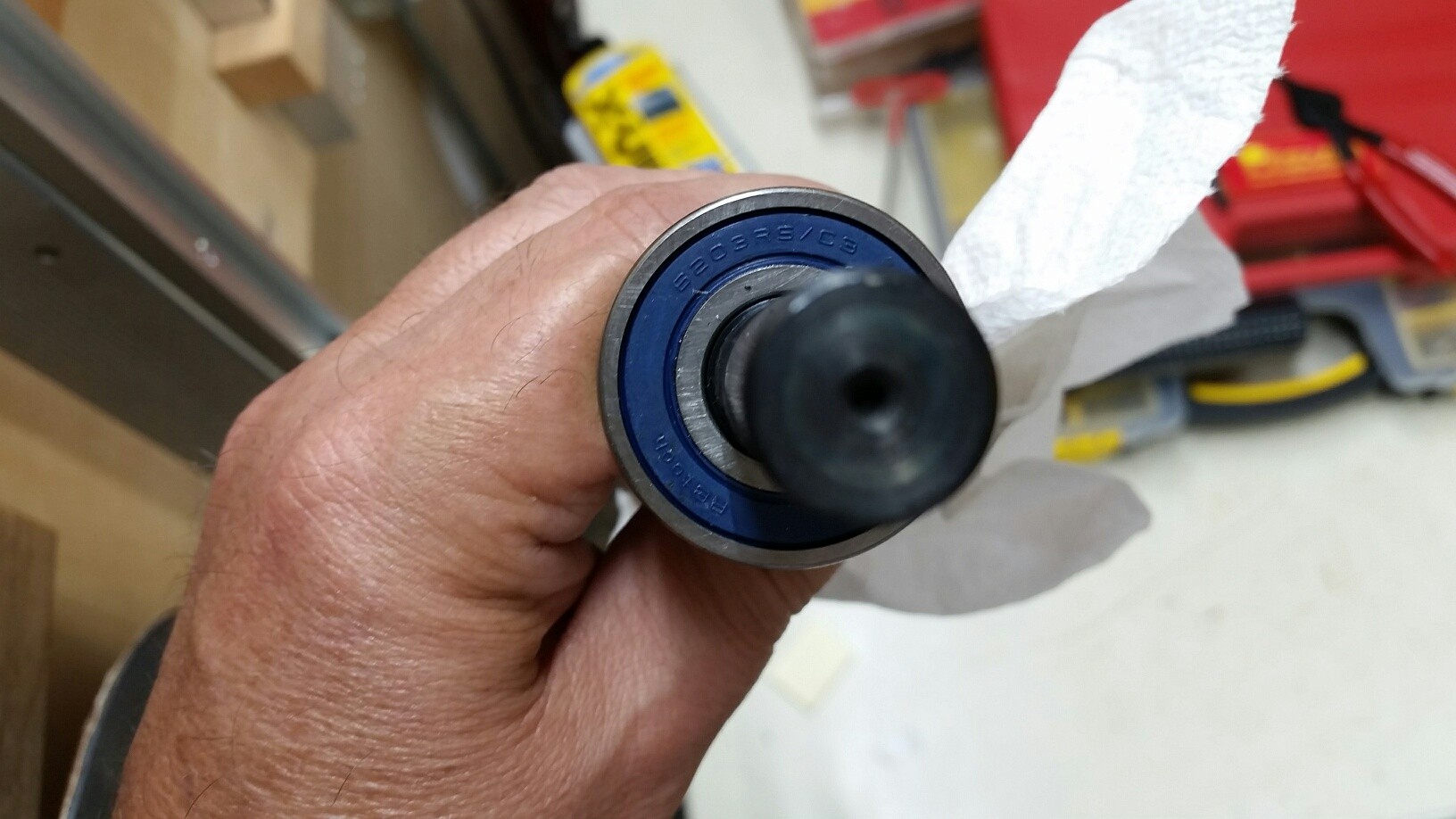

The front bearing is a RB tech 6203RS /C3. It has rubber seals on both sides and would come on and off from the front. It says made in China.
The rear bearing is also a RB tech but this time with metal shields, a 6003Z and of course still made in China.
This is a one piece shaft and the rear bearing is larger then the spline so it will slide off the back.

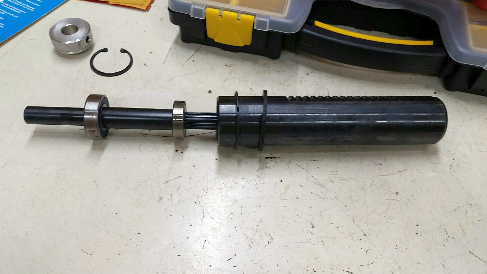

Here is the guts for one last time before I stuck it back together and remounted the quill.

Is there anything unique about this quill. It appears to be the same as mine except the bearing manufacturer.
Re: Today in the shop "Let's look in side a powerpro quill"
There are like 5 or maybe 6 versions of the two bearing quill. Some are going to be just like mine but perhaps different bearings because the quill now has a top end of 10K rpms but I think they have only one part number so all the quills are now able to run this fast..... or perhaps they always were?dusty wrote:Is there anything unique about this quill. It appears to be the same as mine except the bearing manufacturer.
I haven't taken the time to look up the bearings but my guess is that they are not all that different from other versions as 10K while it seems fast is not all the fast when you start looking at things like routers who can run upwards of 30K.
If you know the date of your quill, like you did an upgrade it would be interesting to have you pull it apart to see how close it is.
I was really glad to see it as a one piece shaft, the older two piece one always seem odd to me. I know why they did it but if I had been the designer I would have not gone that way.
