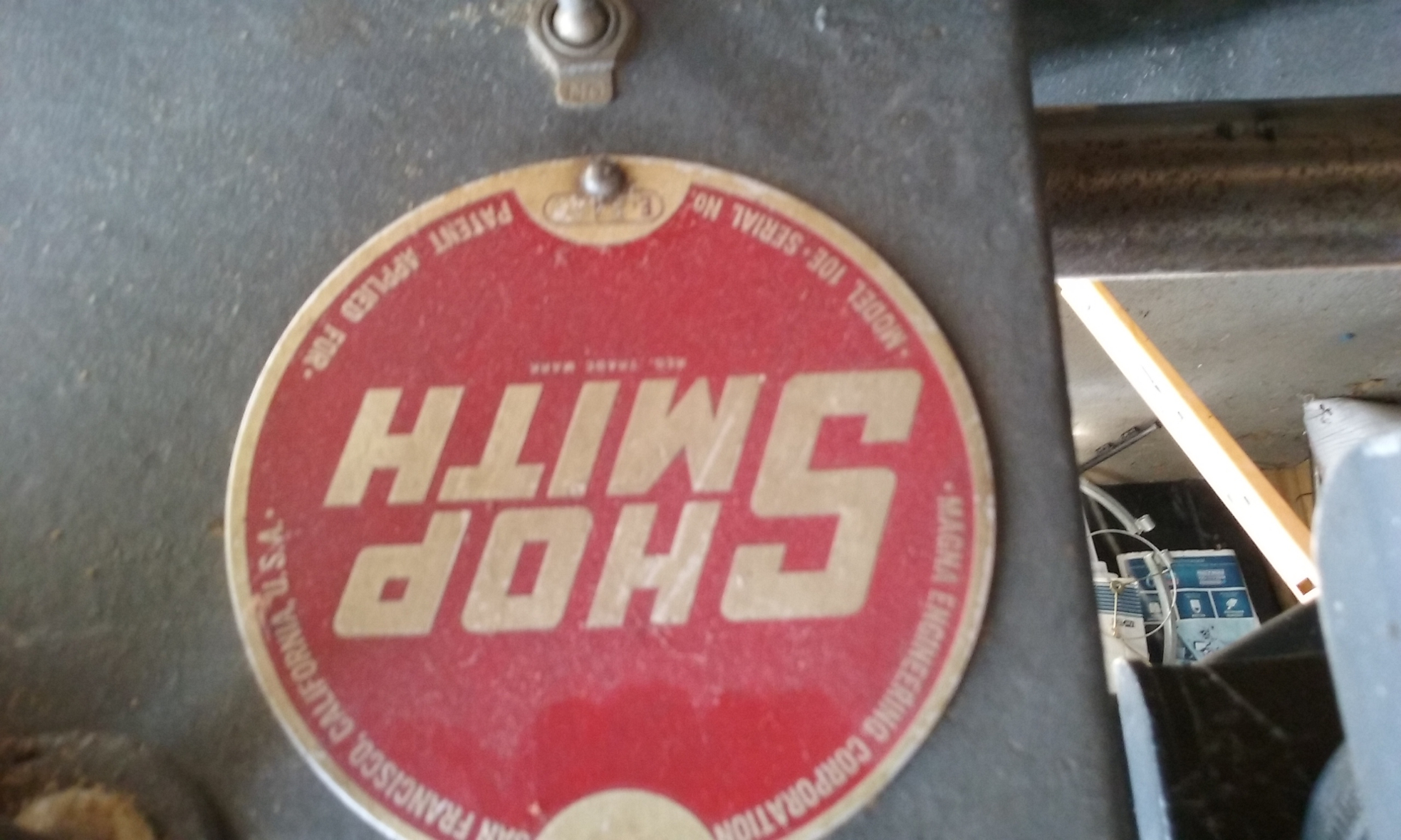

Well, I picked it up last Sunday. I plan to post pictures of it as is tomorrow. It does have a serial number of E5466. I think it may be 1952 based upon the manuals (Montgomery Ward and Magna) which came with it, however I don't know for sure.

For a 1952 there should be five digits in the serial number.ryanbp01 wrote:Well, I picked it up last Sunday. I plan to post pictures of it as is tomorrow. It does have a serial number of E5466. I think it may be 1952 based upon the manuals (Montgomery Ward and Magna) which came with it, however I don't know for sure.

I would think E5466 would be 1948 made in the Eastern plant. The later manuals that came with it would suggest otherwise. The pictures should help bring more clarity.ryanbp01 wrote:So, what year would it be?

I agree with what Ron said. The E in the serial number denotes it was made in the Eastern Plant and the serial number being that low puts it not long after the Eastern Plant went into production.

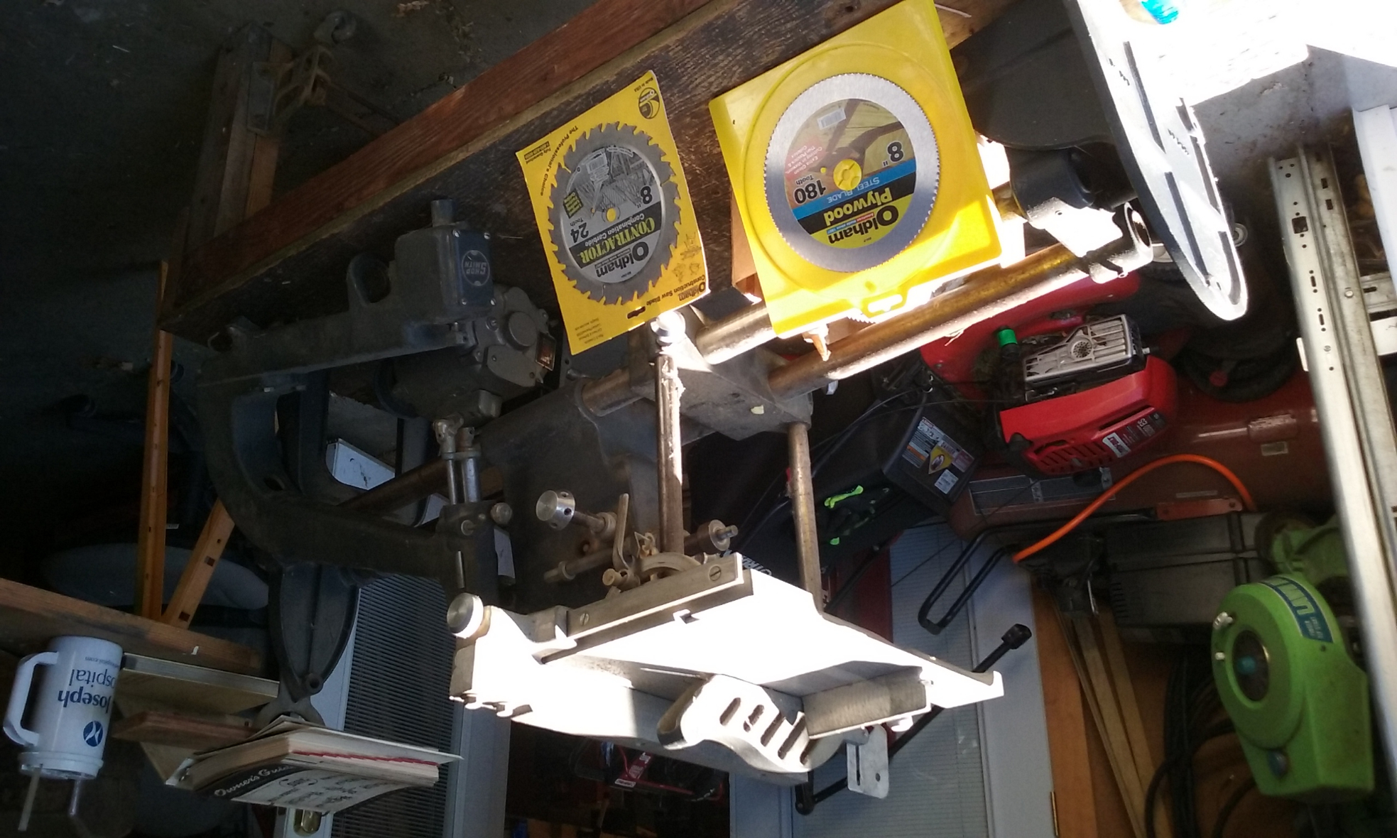

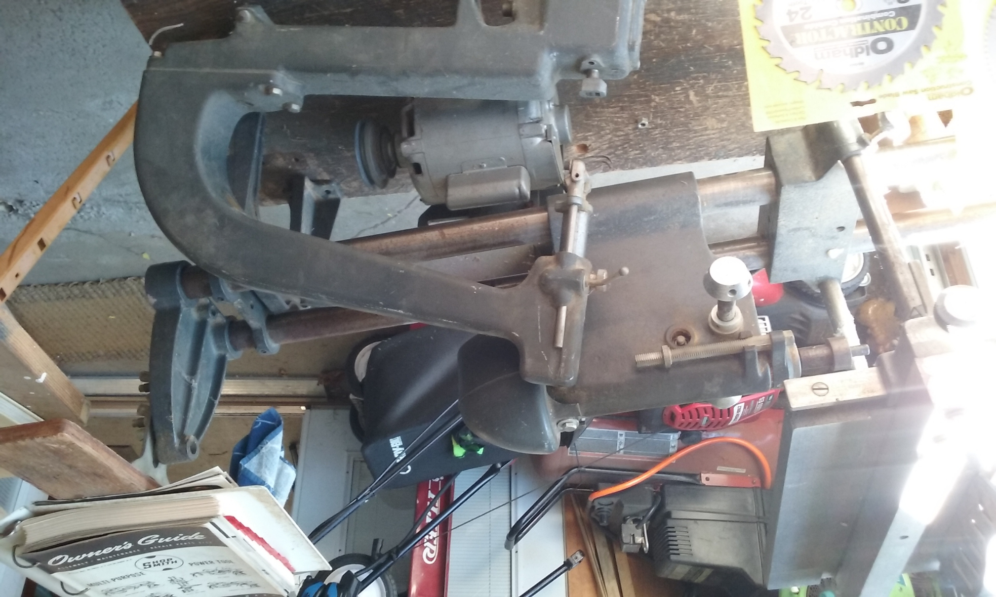

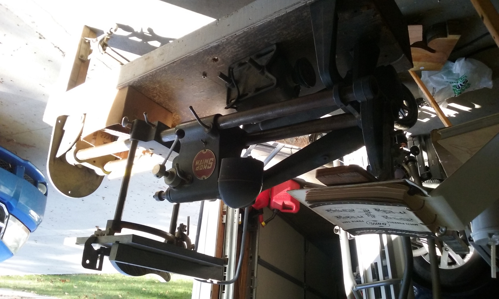

Your 10E has version 2 of the headstock, the larger Base and the 4 Bolt Headrest. It also has the Wood Extension Table and version 2 of the Tailstock. This information comes from the pictures I saw of it. 10ER's did not have the Wood Extension Table and it is one of the changes that occurred shortly before the 10E became the 10ER.

Well, after working outside getting stuff finished before the weather turns, I thought I would post some pics on the 10er before I start taking things apart for restoration:
- 20191013_160516.jpg (1.58 MiB) Viewed 21225 times
