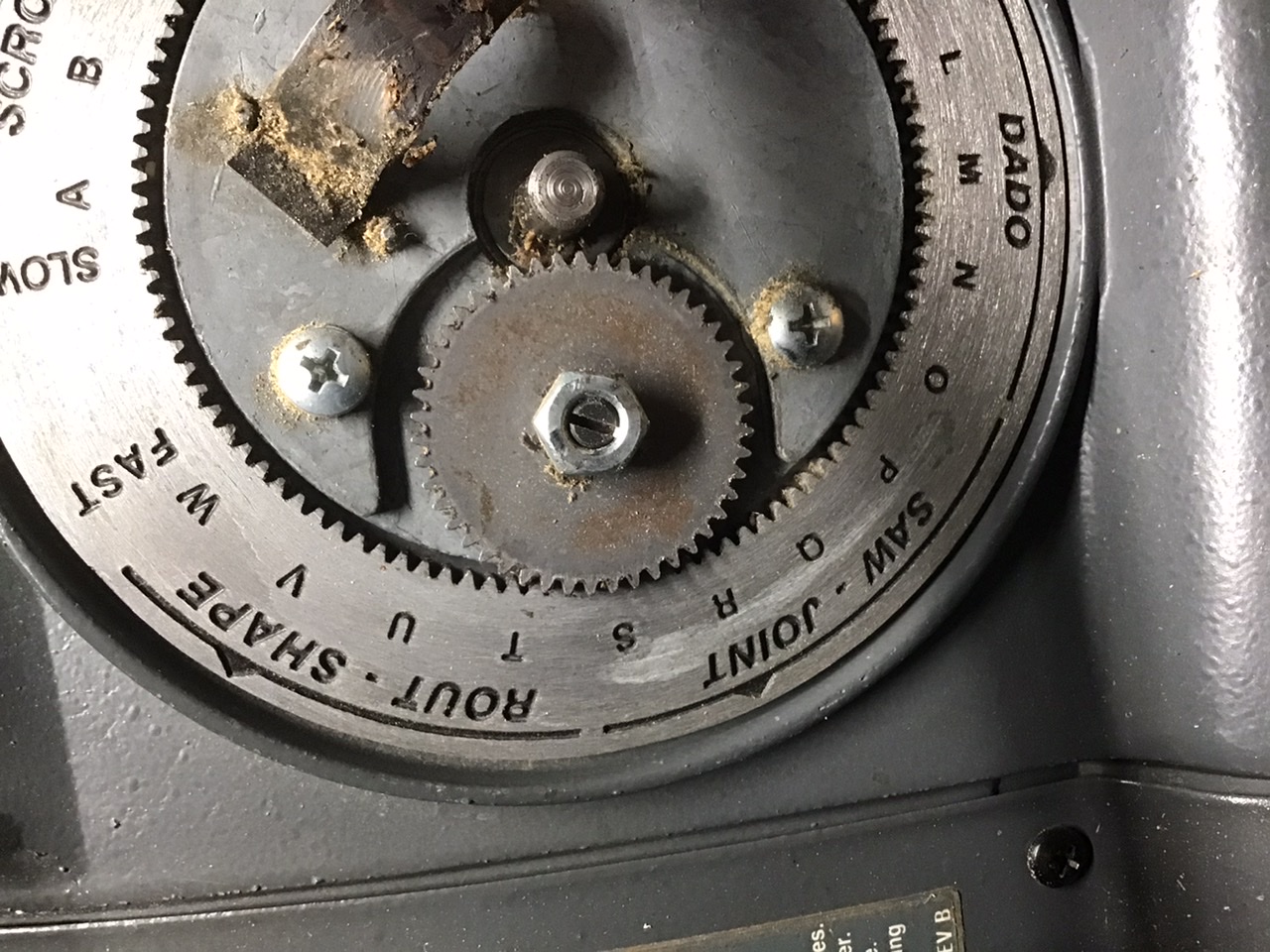

I finally removed the control dial after finding correct tool!
Found the small sprocket off the larger one.
The nut holding it was loose. I held the slotted screw while tightening the nut.
Is the nut supposed to be loose?

The nut should be tight. It does two things. The set screw is a stop for the toothed Quadrant Assembly aka "porkchop" on the back and holds the gear in place on its bushing when the nut locks the set screw. The set screw limits the Quadrant Assembly's travel. I know I have instructions for adjusting the set screw but I cannot find the digital copy right now. Sorry
