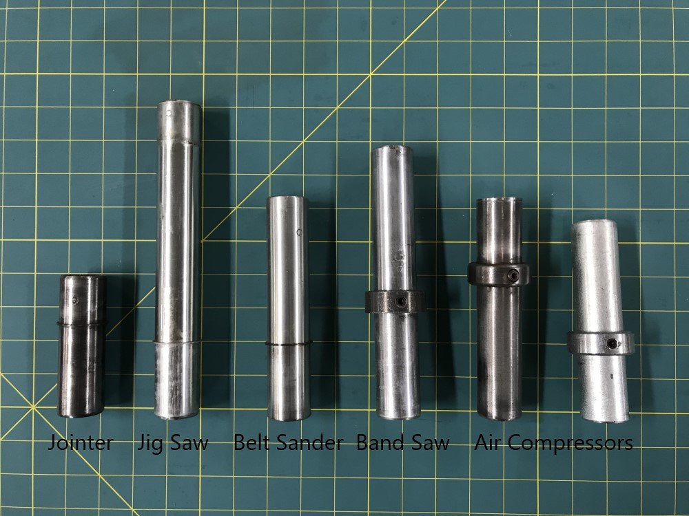

SPT – straight post Overall Length Length from top to ring/collar* (sorry the information doesn't line up under the headings)
Jointer 3-7/8” 1-5/16” P/N A3094, 3094
Jig Saw 8-7/8” 6-3/4” P/N 502289
Belt Sander 6-1/4” 4-1/8” P/N B3532, 503002
Band Saw 7-1/2” 4-3/4” P/N A3466
Air Compressor – M 6-1/8” 2-1/2" P/N 66100, 502568
Air Compressor – CH 5-1/2” 3-3/4” P/N 516533
*Collars are measured from the top of the post to the bottom of the collar. Lengths may vary by individual set up.
The Air Compressor posts are left original Magna and right later CH.

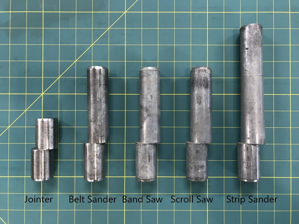

SPT – eccentric post Overall Length Length from top to eccentric offset
Jointer 3-1/2” 1-3/4” P/N 502080, 5020809
Jig Saw 8-7/8" 6-3/4" P/N 513776
Belt Sander 6-1/2” 4-1/2” P/N 513777, 5137779
Band Saw 6-1/2” 4-1/2” P/N 513777, 5137779
Scroll Saw 6-1/2” 4-1/2” P/N 513777
Strip Sander 8-7/8” 6-3/4” P/N 513776, 5137769
The Eccentric Mounting Post for the Jig Saw is not shown in the picture below but is the same as the one for the Strip Sander.

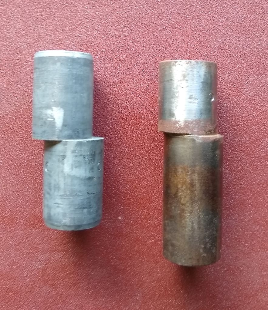

Re: SPT Mounting Posts
These solid eccentric mounts came on my Greenie Jointer. They mount short end up, are steel, and have about half or a little less 'eccentricity' compared to the more recent version, shown for comparison. I presume they are original, though this unit has only been mine since the early 1980's. In terms of timeline they must they fall between the snap-ring straight tube and the current eccentric.
