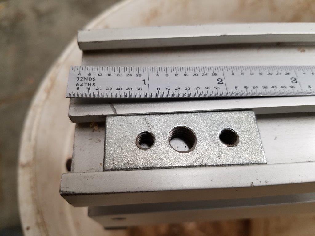

I didn't notice this until I tried to slide a sliding t-nut into the top slots of my 520 fence. Apparently I've dropped it enough times on the concrete floor to slightly squeeze the end of the top two slots just enough to prevent the nut from sliding in. How should I go about expanding that slot without damaging anything else?

Picture? Depending on how much is damaged, you could put a chamfer of the end with the disc sander. Or you could possibly just dress the dinged portion with a small file. If you start the T-Nut from the other end, how close does it get before there is interference?

If it is minor and you don't use the top track of the fence very often maybe just alter the t-nut?

I can not slide t-nuts into thew front of my two fences. If I slide them in from the outfeed end they work fine. I have never dropped my fence.

I can get the nuts in from the front. They bind and stop when I get them to about 1 1/2 inches from the back side. I thought about inserting a-nut at the front and forcing it out the backside with a punch and hammer. hal

There is a rule in my shop (yes, occasionally it is ignored) that demands "no hammers".
If I was to do anything about this, I would try to draw a t-nut through the slot using pressure (clamps) and not impact force.
We are looking at the out feed end of the fence - are we not? Is the t-nut being squeezed by the top rail of the miter slot? If so, many a bit of cautious filing with a fine file. Are both t-slots the same way?

Yes Dusty - on all counts.
I really like your solution. Seems much safer.
It is the outfeed end.
If I understand your comment correctly. Both slots are affected. I can't tell what part of the t=nit is binding. At first I thought it was just the upper part of the slot that ridges over the wings of the t-nut. But I suppose the whole nut could be squeezed. It look to me like those edges were bent in slightly when the hit the floor. You can see the small dents on the corners of the fence where the impact occurred.

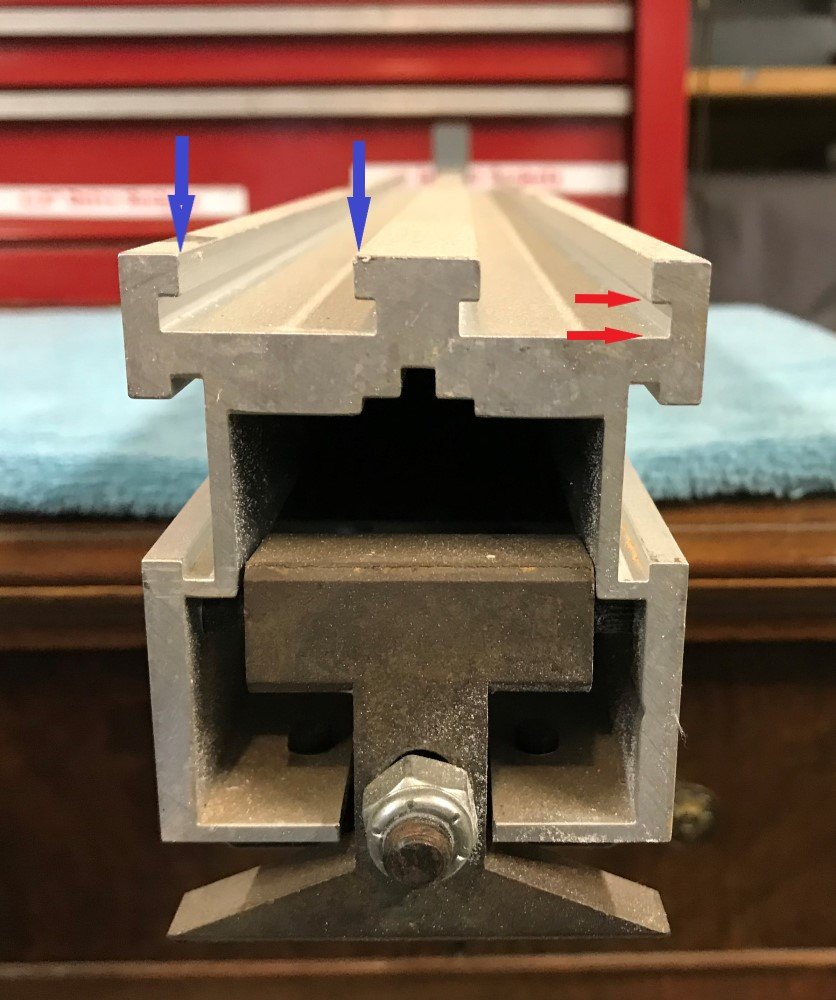

Maybe some careful measuring of the width of the "T" slot top opening (blue arrows) and the height of the slot (red arrows) on both the damaged and undamaged ends would give a better idea if the pinching is from the side or the top of the fence. For the opening width (blue arrows) measure both the top opening and the channel width below it. That should give you the area(s) on which to file.
