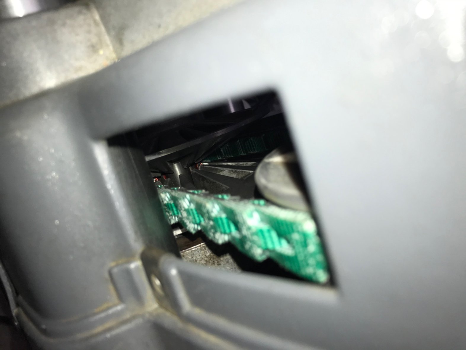

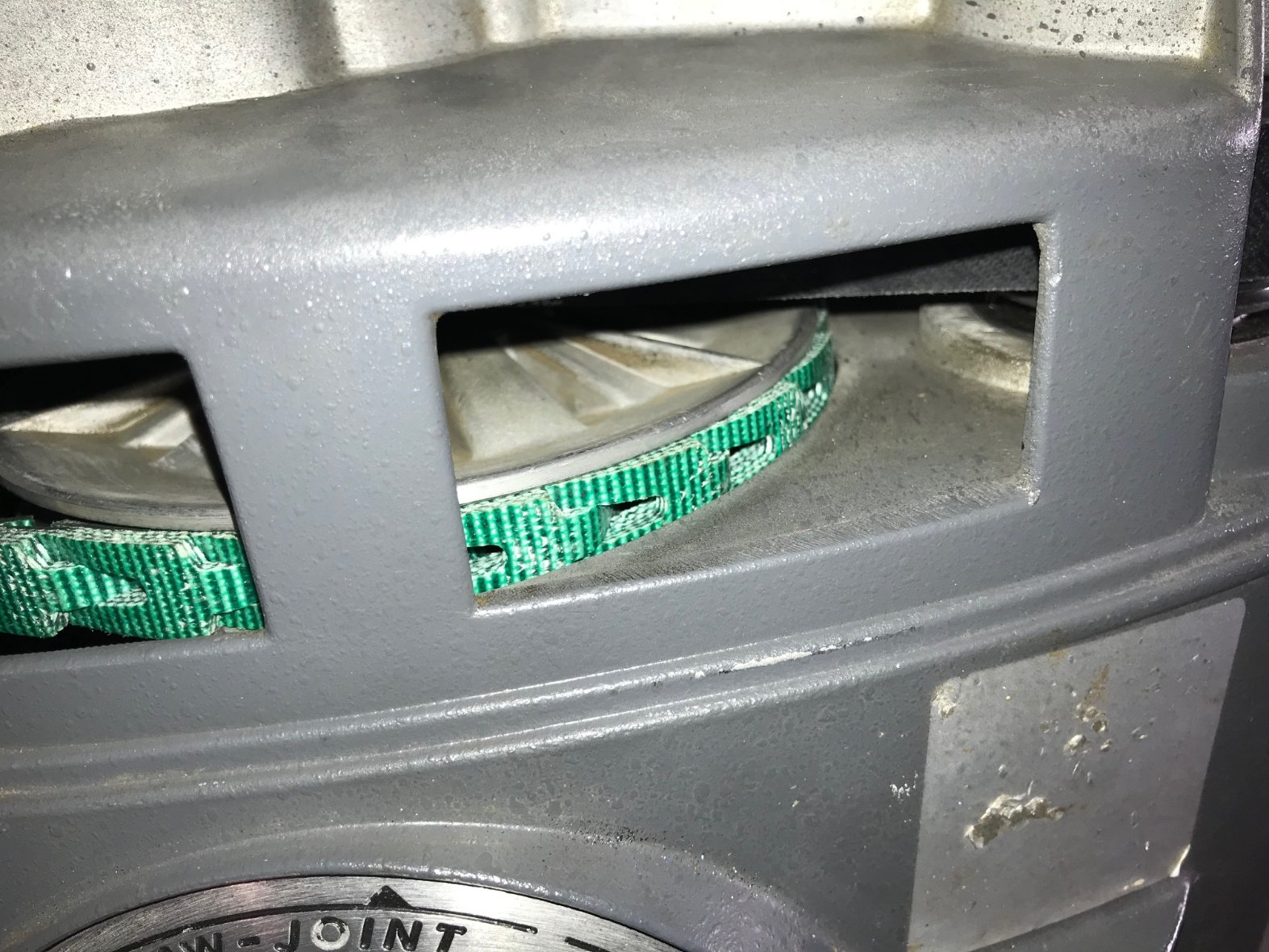

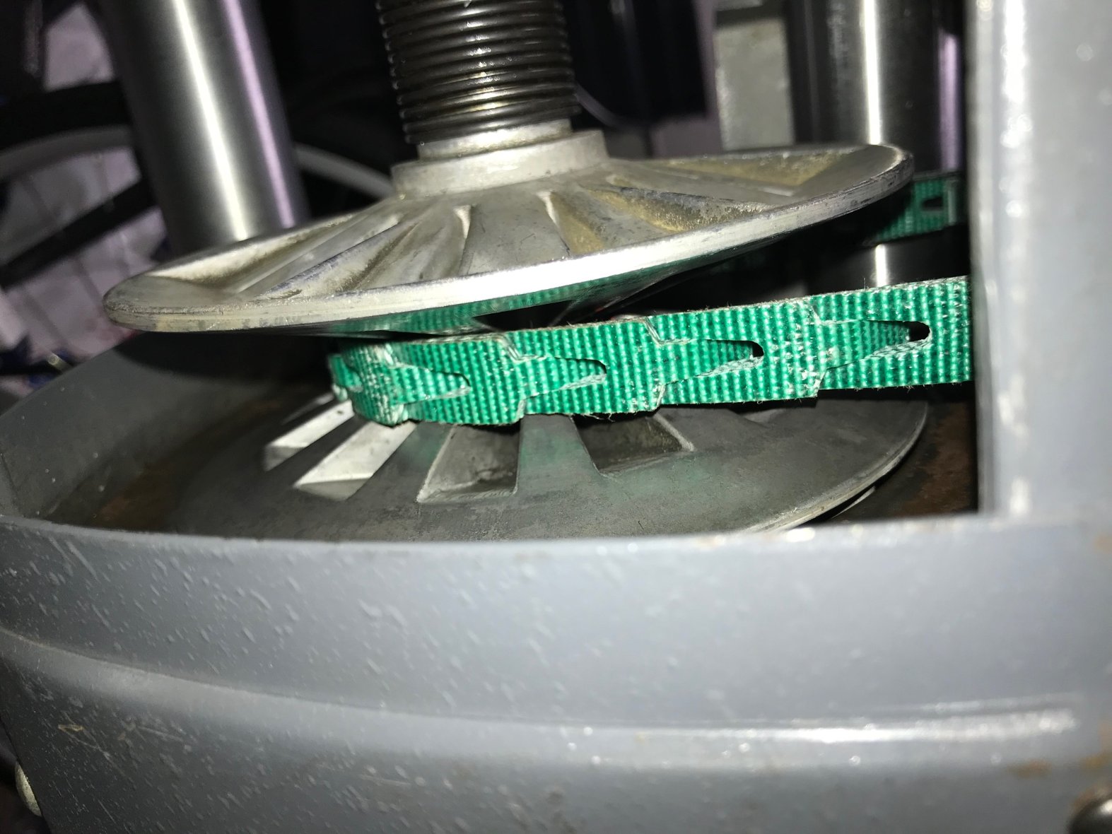

Just turned on my 1982 Mark V 500 for first time. I acquired from a friend and rebuilt headstock. I have 4 belts to try, Jacob A belt, SS new, Kevlar belt and a 32 link belt form HF. Link belt is on now. I have a calibrated RPM gauge and the slowest speed I get is 1080 rpm. The motor is running at 3580 rpm. My questions are:
What is the motor rpm supposed to be and will a longer or shorter belt slow it down?
I can't go any slower or the belt hits the casting.
Sorry about the pics, for some reason they rotated when I inserted.

Low RPM should be in the 700 range. Your speed is most likely a result of having the wrong belt length.
My suggestion would be to put on the Shopsmith branded V belt and try again.

Both the width and length of the belt effect the speed, Also, the tabs on the link belt make it deeper through and will limit how far the belt can go in the sheaves.

Effect Belt Length has on resultant speed
A longer belt will cause higher speeds since the floating(motor) sheave must compress(close) more to maintain tension and that results in the belt riding further out on the motor pulley.
A shorter belt will invert that. The belt will ride further IN on the motor pulley causing slower speed range.
The control sheave range is fairly consistent with a properly set high speed stop.
A narrower belt will cause faster speeds since it will be riding further INTO the idler pulley and further OUT on the motor pulley.(wear can create that)

The 32 link belt started same size as SS and is a little wider. But after running for a few minutes, it stretched so I removed 2 links to make it same size as SS. Since it is a little wider, it hits the casting when trying to get below 760 rpm. I went back to the SS belt.
