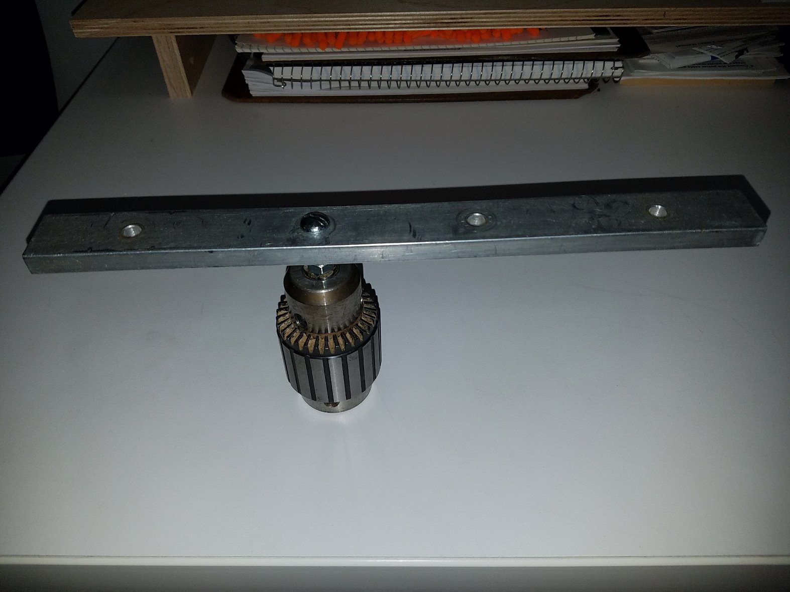

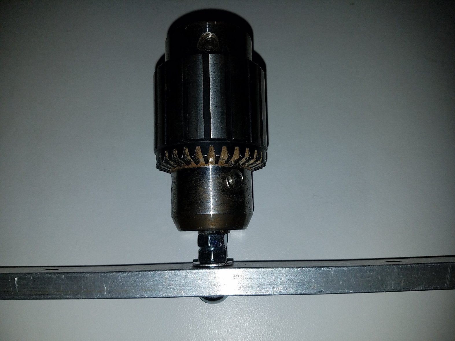

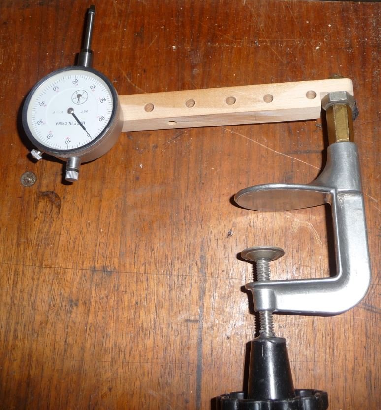

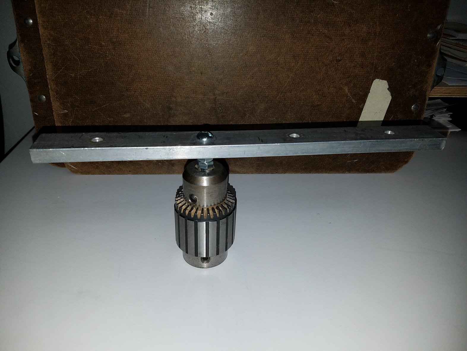

[attachment=0]Thanks for the suggestions. The shims are thicker than you'd expect; they came from an extension table I bought used. It was from the earlier 510 and the p.o. had used shims to level it. I put two 0.10 shims on one side and it reduced the delta to .18. So I added two more. Now it's within .02; close enough. I like Dusty's set up and actually had some milled aluminum I could have used but I made one similar to the one on the video using steel. Here's a pic of my dial indicator gauge mount. Made from stuff collected over the years.
