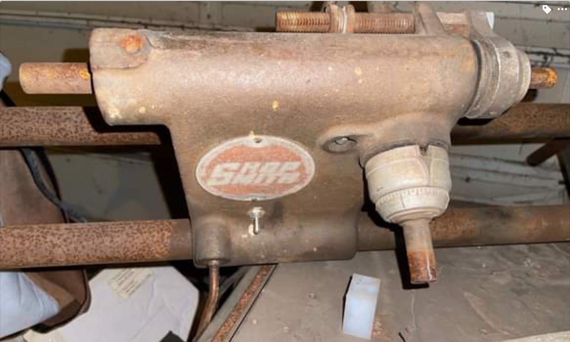

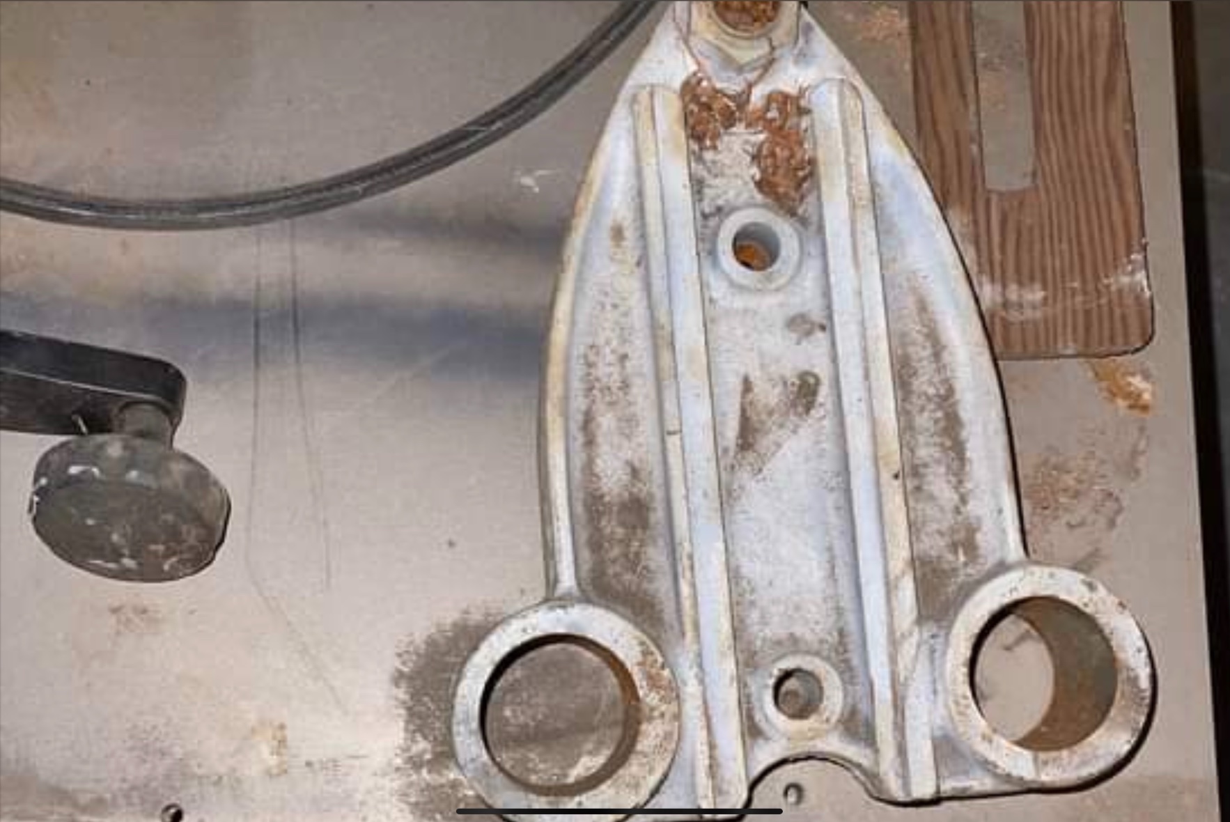

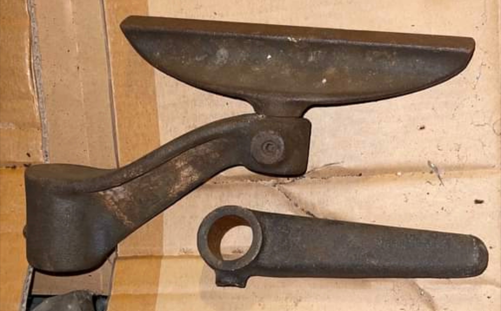

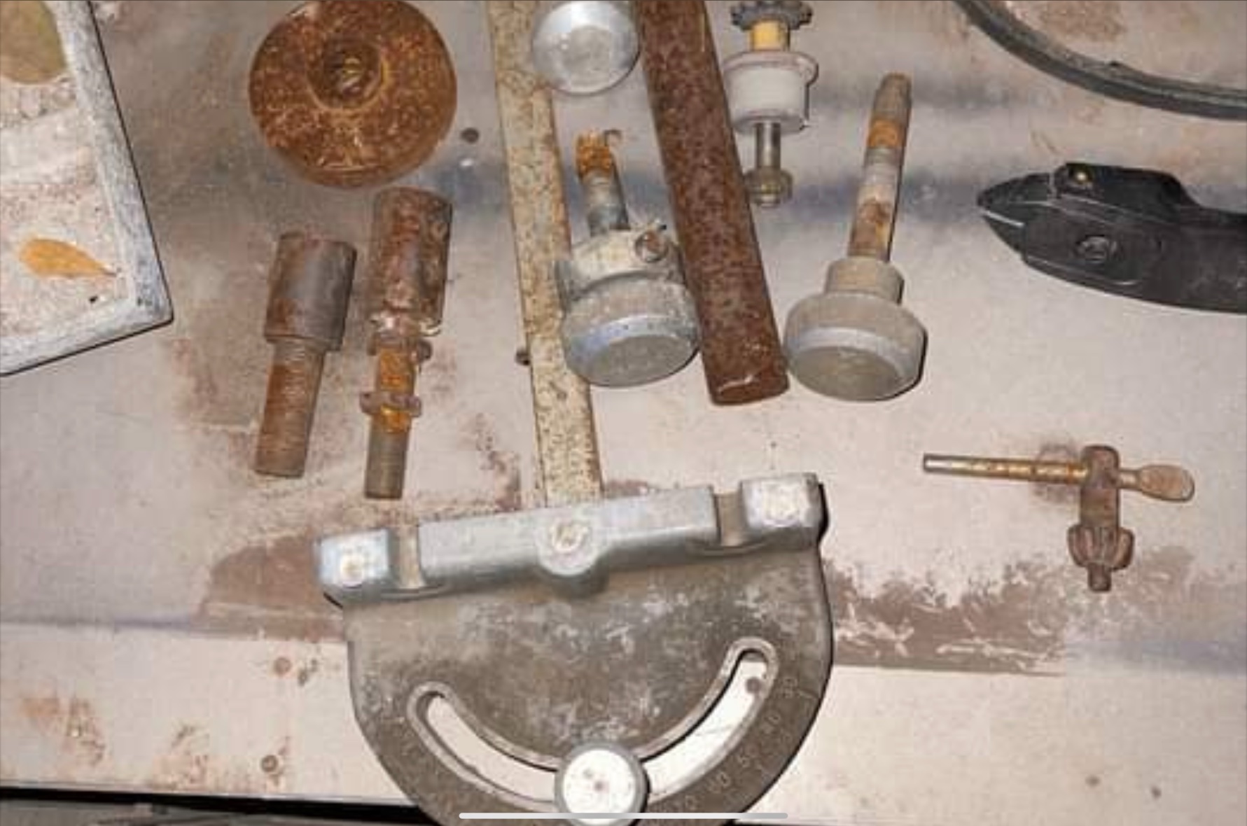

I’ve been blessed to have been given a 10E that needs some attention before I can begin using it. I’ve posted pics on the Facebook group and now found this forum so am hoping folks might be able to help me out here.
I’m basically trying to figure out what additional parts I need to get it running. Also, what paint would be the closest match to the original gray color...hopefully there is an enamel available off the shelf that is close.
From the info folks have told me already , even though mine is marked “10E”, it’s apparently actually a 10ER? Likely made in early 1949...I think...
I’ve watched many YouTube videos and have read quite a few posts about these on here. I’m looking forward to getting mine fixed up soon. I am a disabled veteran and will be using it primarily as a lathe to make turned items for my other hobby of decorative knot work.
I understand it’s not ok to ask to buy used parts on here and I am not trying to do that. I’m just trying to gather a list of parts I need so I can know what I’m looking at before I get started on this project.
Parts I know I need so far:
Upper pulley
Upper pulley guard
At least one table rod
Sanding disc
Quill handle
Speed changer would be useful if I can find one
Various other handles (How many? Which ones?)
Can you see any other parts I’ll need from these pictures please? I will not be using it for the table saw functionality at this time.

WHY do you need a table rod?
Spur drive and tailstock arbor.
A ton of evaporust and or a trough for electrolysis and a low v DC power supply.
Quill lock. ( One of them missing knobs. )
Yes it is an ER.
OH and motor mounting plate etc.
Yes it is an ER.

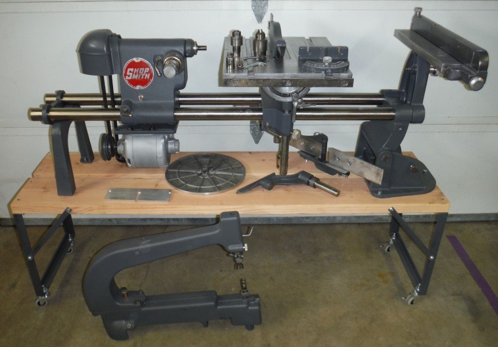

First off welcome to the Shopsmith Forum. We can help you with advice and you'll find a lot of help here. There has been a lot of debate as to when the Model 10 changed from 10E to 10ER. There is also the marking of the Shopsmith on the Logo/serial number plate going from Model 10E to ER to 10ER which can be confusing. JPG has said it is an ER but I go by what it says on the plate. Your says it is a 10E so for me it is a 10E. What is more important to me is which version of parts it has. This is important because some parts are interchangeable individually and others as assemblies. Since it looks like you have headstock version 4 yours would be a late 10E and the year is probably correct at 1949.
As to the parts you need to restore it to original JPG has already given you some of that and others you already know. The best place for you to start that list would be comparing what you do have against the parts list and drawings in the Owner's Manual. Hopefully you have one. With that you can decide which parts you don't need right away if you are only planning to use it for lathe work. Later you can get the additional part to make it complete and use the other functions.
Your big challenge ahead is disassembling everything and rust removal. Some rust may have to be removed to free parts from one another. JPG recommended Evaporust which does an excellent job of rust removal but can be a bit expensive in your case. It is reusable but you will need larger amounts to cover those bigger parts. Another option I use on larger things like the way tubes is vinegar. It works slower but is much cheaper when you need a lot. Just options to consider. Don't get discouraged though. Even a basket case can be brought back to life. Below is one I restored five years ago. It was in bad shape like yours. Lots of rust on it. I ended up replacing the Quill and Pinion because they had too much rust pitting. Missing parts were replaced too, but most parts were able to be saved.

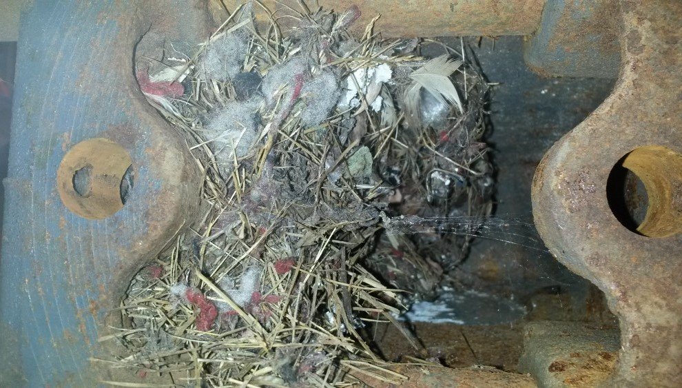

Below is what I found inside the Headstock.
_ _
Depending on how original you want to restore it will guide the replacement part purchases. The Belt Guard for yours will be the earlier version and not the one shown on the 10ER above. The motors used back than still run like champs today. The most common one is the A. O. Smith 1/2 HP Motor and was the one sold with the Shopsmith Model 10's. There was a 3/4 HP option and some buyers opted to provide their own motor. All the motors I have gotten with Model 10s worked still and just need a little TLC. I have replaced the bearings in a very few. To date I own or have owned 23 Model 10's and restore Shopsmith Tools as a hobby.

...because mine has one and half of another one. No idea why half of one is missing.
Yes, though I’m considering a Nova chuck (with appropriate adapter)...Spur drive and tailstock arbor.
I have the motor and mounting plate...just need to make sure it won’t shock the heck out of me when I turn it on...OH and motor mounting plate etc.

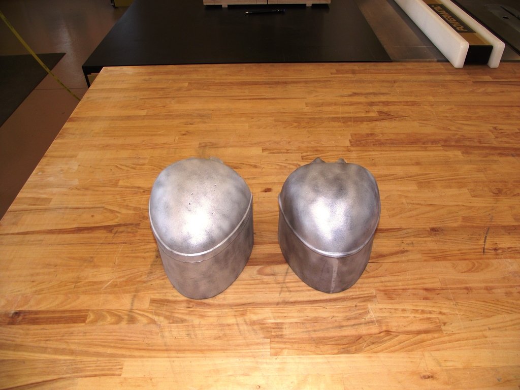

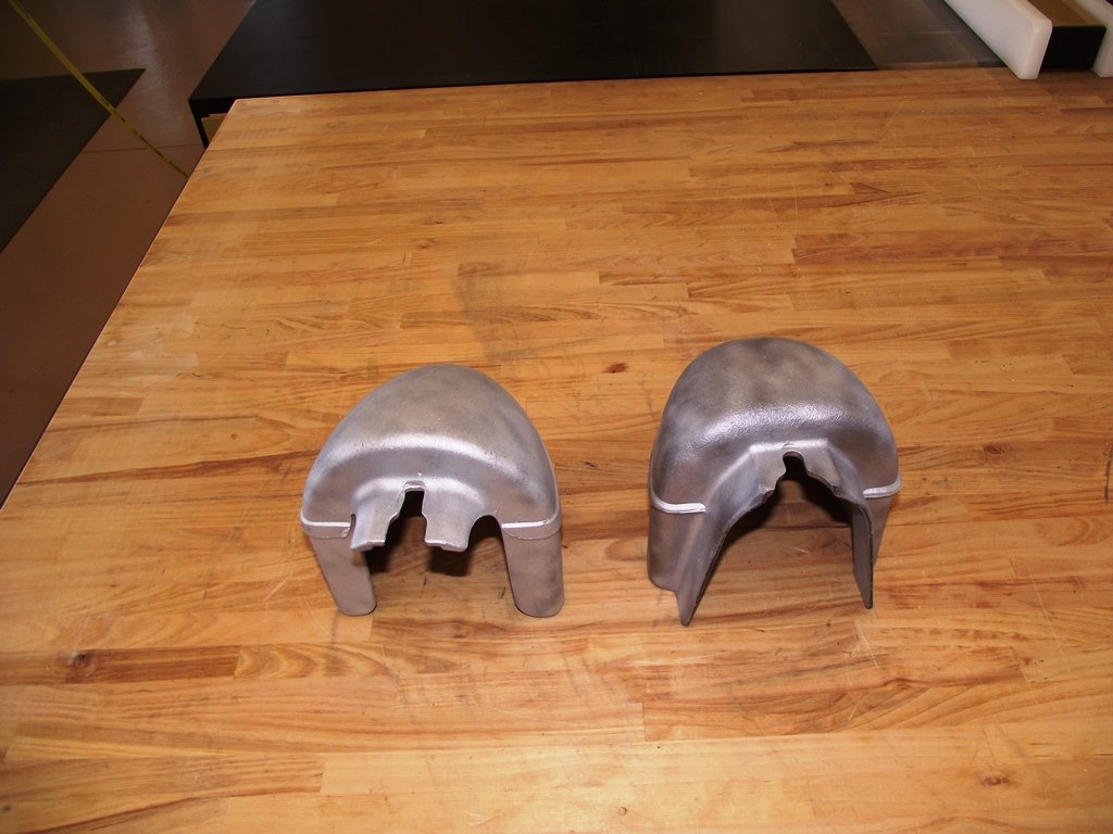

The top pulley is a 3 step pulley, 2", 3", 4". The problem is the head stock pulley has a 13/16" bore. That is not standard and is not available today. eBay has them occasionally.jumpmaster wrote: ↑Tue Mar 30, 2021 6:00 pm Does anyone happen to have a pic of the correct top pulley / belt guard I need for my machine please?
Another source is Skip Campbell... https://www.mkctools.com/10erparts.htm
The pulley cover shows up on eBay from time to time. It is not particularly rare but is not also a common part. There are two versions shown in the pictures. Either will work.
- DSCF1165.JPG (117.23 KiB) Viewed 2613 times
- DSCF1166.JPG (118.25 KiB) Viewed 2613 times
