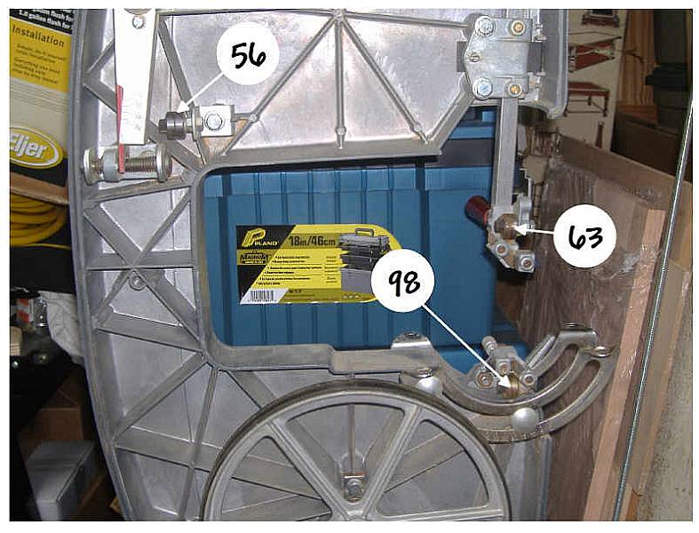

Moving right along here, now we are on to bearings. This post is not dealing with the wheel bearing but rather the ones dealing with blade control.
This is an inside shot of my bandsaw:
[ATTACH]13594[/ATTACH]
According to the date tag this is a 1985 model. I just got it so I have no idea as to the history of it. The "included 1/4" blade" was badly rusted and kinked, I broke it apart as it was no where near being usable. This means I have no blade to evaluate the bearings and alignment, but I have ready read many many stories here about those issues and want to avoid this area of ownership.
For this post I'm interested in the three areas shown, the auto tracking #56 and the upper and lower ones #63 and #98.

- ssbandsaw sc.jpg (78.93 KiB) Viewed 43063 times
