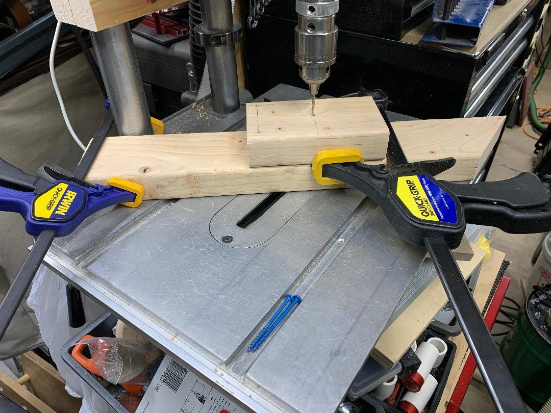

The 6" piece I marked with a center line down the length and a cross line at the 3" point. I drilled two 1/8" holes near one end, I went with 1/2" in from the end and a 1/2" from the edges. This is not critical. I then used the same drill to put a hole at the center point of the part. Again this is not all that critical.
The other hunk of left over 2 x 4 I arranged so it was supported at the left tube and then had it center line in line with where the drill bit would drill. I then trimmed the 2 x 4 more or less even with the main table so there wasn't extra hanging out over the table.
I then clamped that 2 x 4 so it was against the left tube again and clamped the other end to the main table. Now using the 1/8" drill bit lowered and locked in the center hole of the 6" piece I clamped the two parts together. Then you can screw the 6" part to the 2 x 4 after moving things around to work. I used a couple of 2-1/2" blue kreg screws for this.

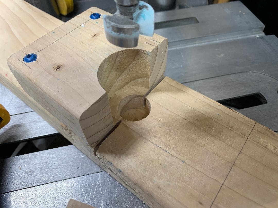

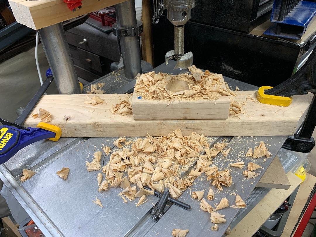

Now you need to get things aligned again which you do with the 1/8" bit and the left tube., and again clamp the 2 x 4 to the main table. You need a 1-11/16" drill and go just through the top section of 2 x 4. Clean out the chips and go to a 1" bit and drill into the lower 2 x 4 about a 1/2" or so.
Using a sliding miter box saw or what ever you have you now cut just the top 2 x 4 on its center line. It is OK to cut into the bottom 2 x 4 just be careful to not damage the cut off or yourself.

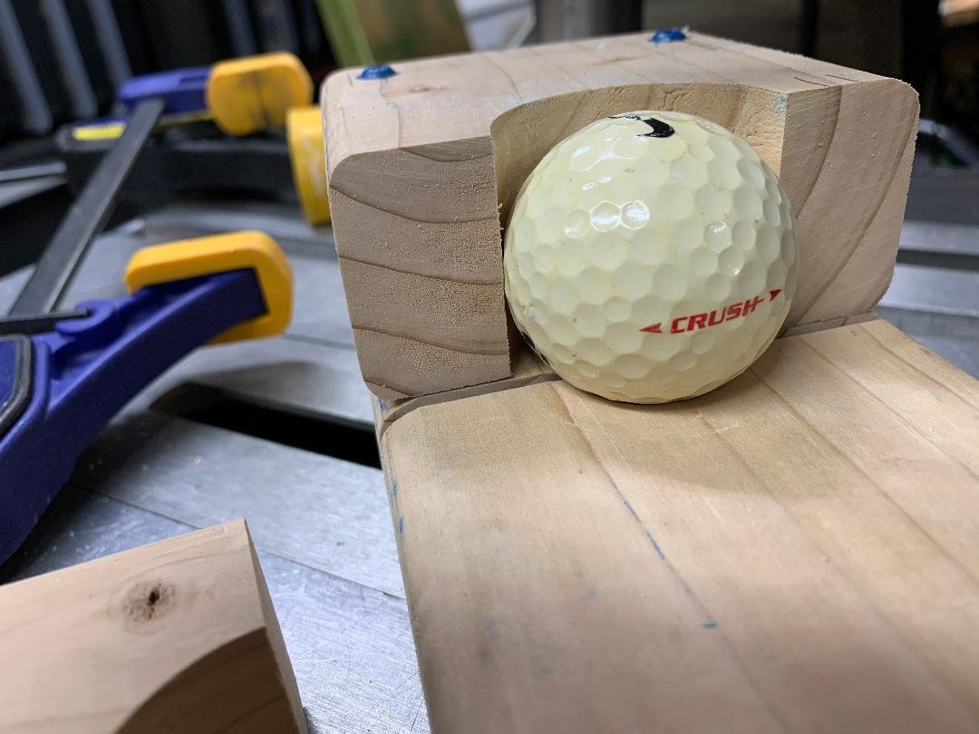

With the 1" bit used as a locator and the 2 x 4 against the tube you again clamp the board down to the main table. A golf ball is then aligned in the jig and clamped between the top 2 x 4 parts. You are now all set to drill a golf ball for a magnet. I have my magnets on order so when they arrive I will check the depth before I glue it in.

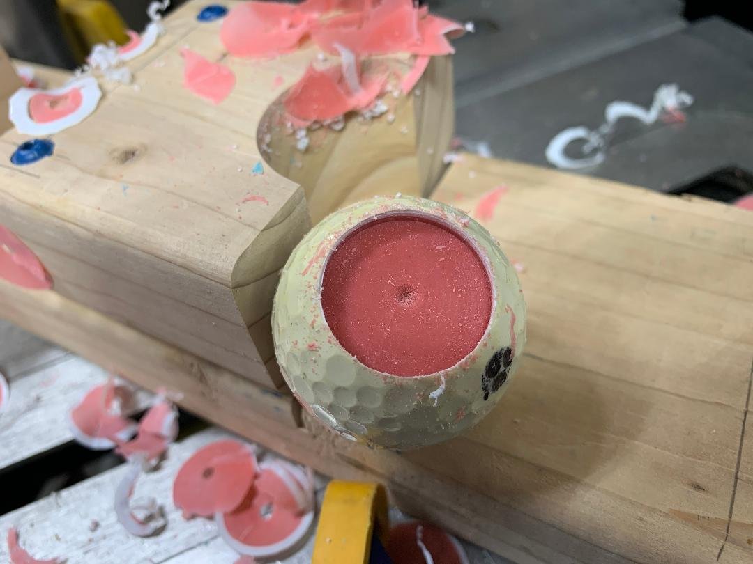

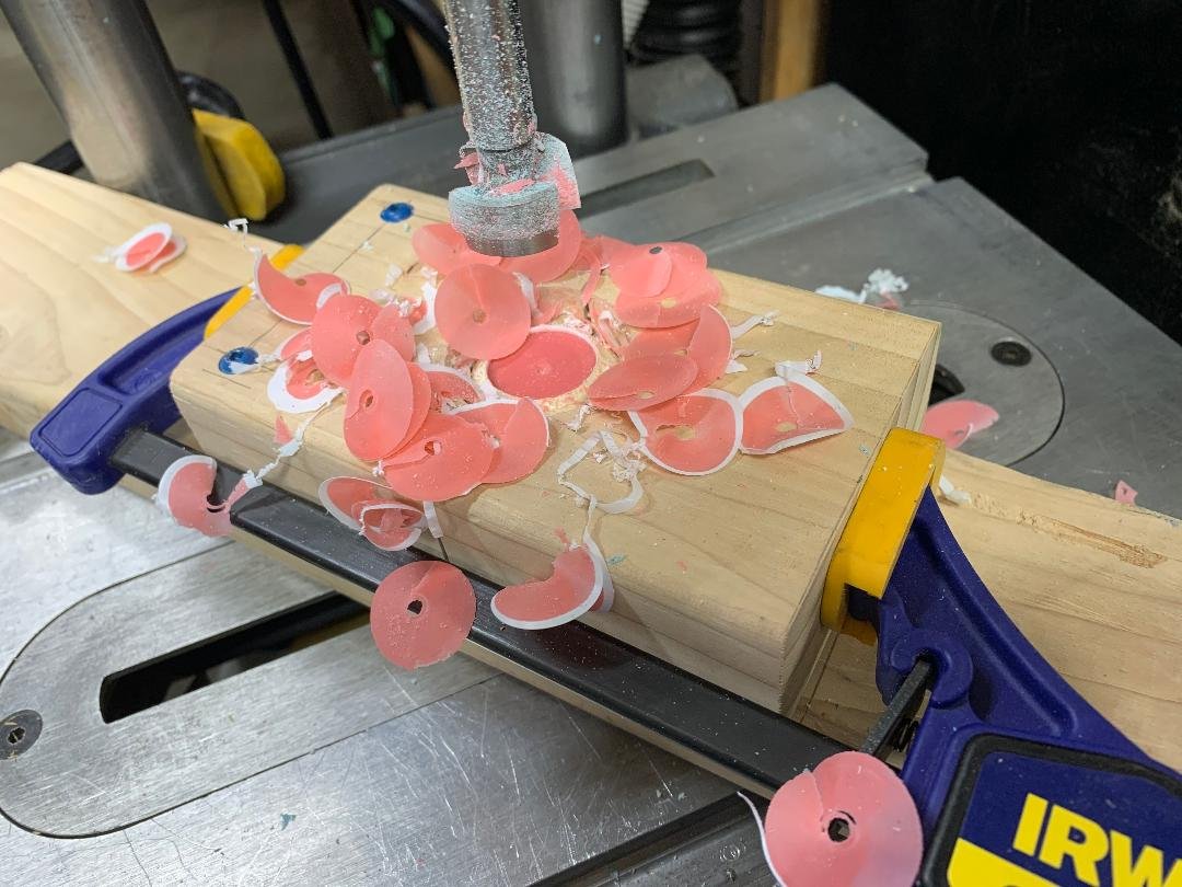

Nice colorful swarf! Drilled the 6 balls for this project and found a collection of colors from the outer jacket as well as what is inside.
I put the magnets on a piece of metal tubing to sand. Had some 50 grit and used that.
They are glued and waiting the 24 hour cure time.
Hope the CA holds well enough. These magnets are pretty strong and I managed to get two stuck together, a real effort needed to get them back apart.
