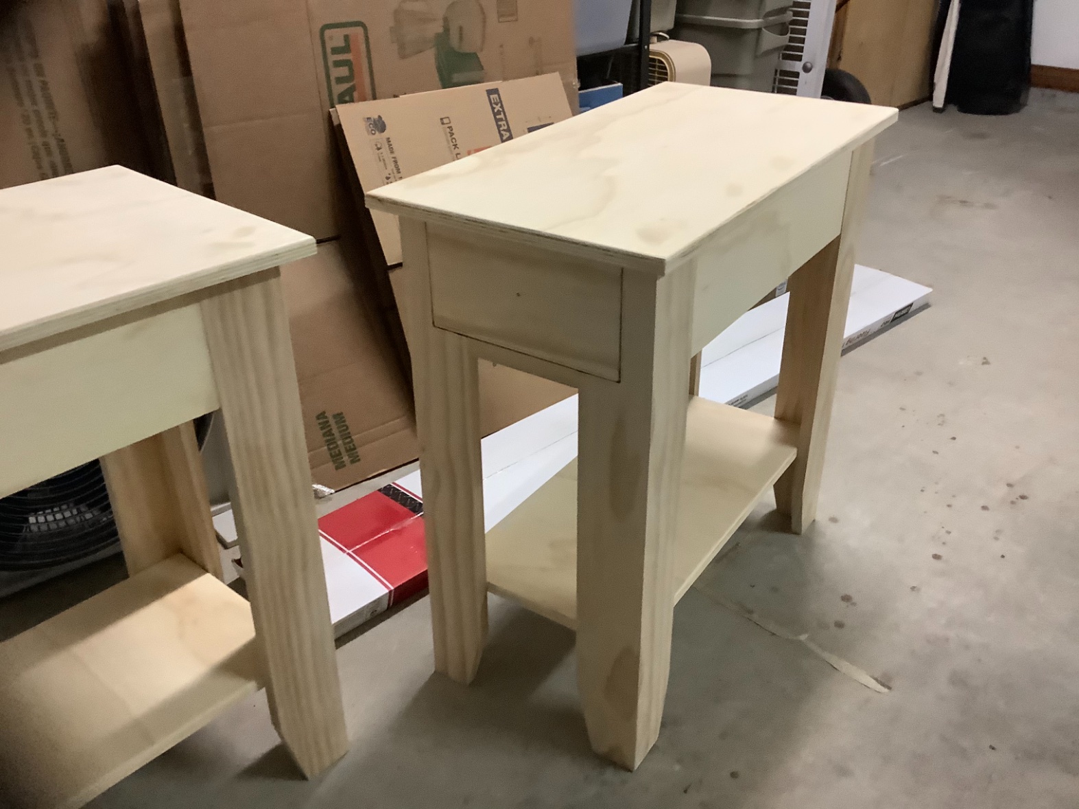

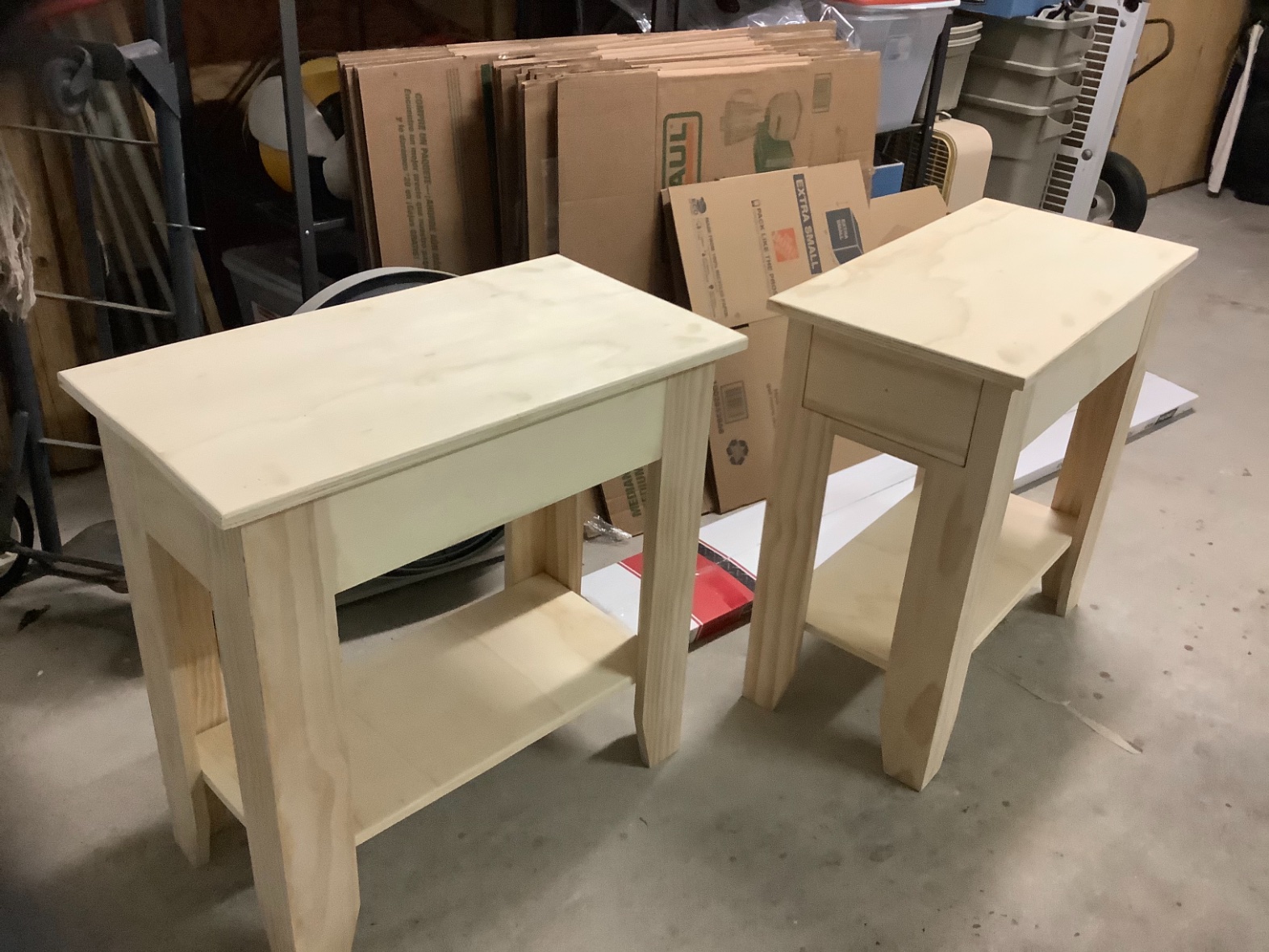

Is there a good way to route an edge on plywood that will be painted and look good?

I wanted something other than a straight edge. I was thinking about rounding it. I do have some banding if I end up keeping it straight. If I do round what is best option. Coat with filler, wipe a glue coat, paint just edge, etc. then sand all these before painting with final coat. Whatever we come up with I’ll most probably try a scrap piece to see if I end up with banding.
