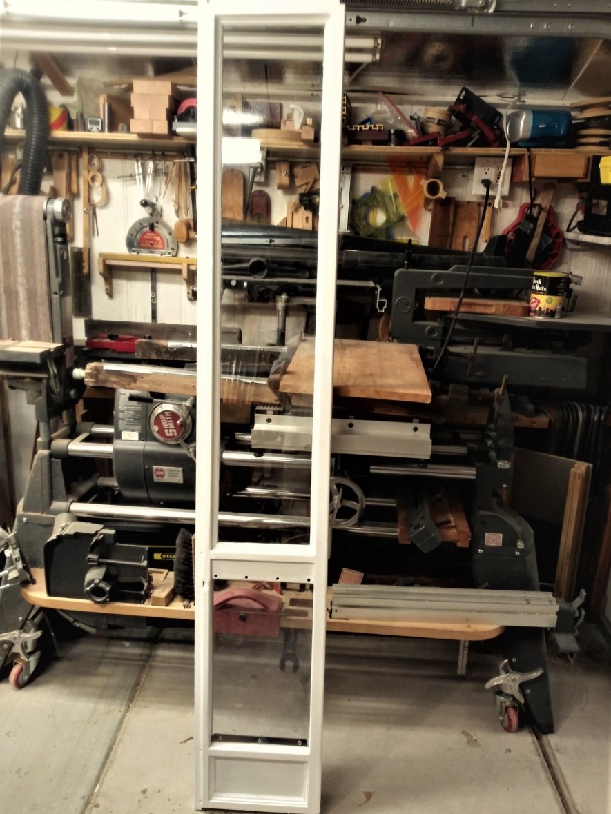

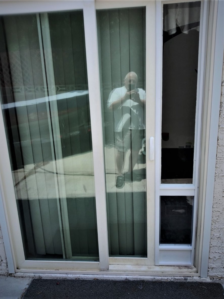

Below are pictures of the new doge door should save me dealing with lettering the dog out. After I installed the insert and proudly showed my wife her first question was "How do we lock the patio door". I hate to admit it but she was r---t there is no way to lock it. Suggestions would be helpful.

Just curious, maybe it is just the picture, but what keeps a burglar from simply using the dog door? It looks large enough for a skinny thief to climb right through?
