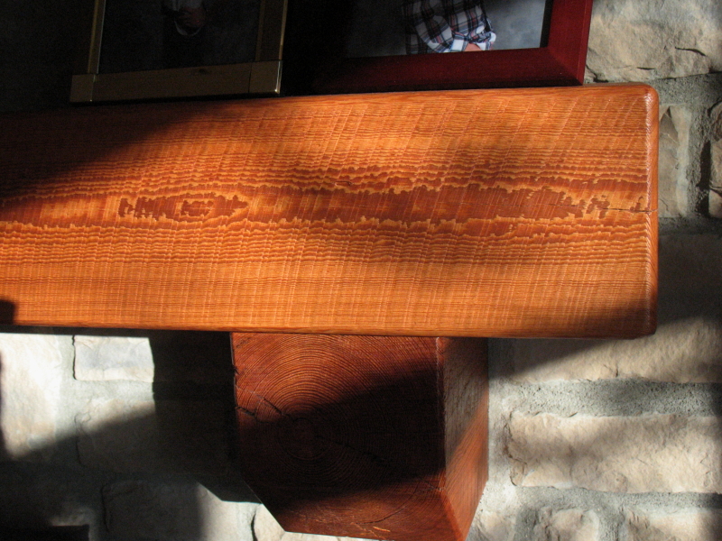

It’s expected to hit three below here tonight in Central Ohio, so still tis the season to enjoy a nice roaring fire. What better time to share my mantel-building project with you guys? Besides, if I don’t post this soon, Sir Paul of the Green Barn will be beat me to press with his gigantic new table build, and that sucker will make my mantel look like a mere matchstick! So here’s a teaser shot of the finished project, illuminated by early-morning sunlight through the windows.

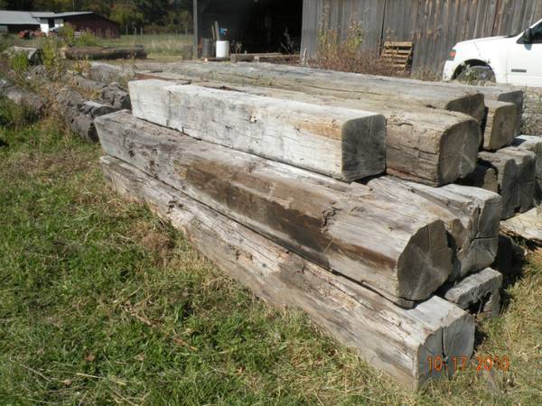

The seller had salvaged the timbers from several old barns to build a new barn for himself, and the heart pine beams had been stored in one of those old barns for some 50 years. Before that, I’m told that they were structural beams in an old International tractor plant near Dayton. So they probably date back to the 1800’s, when Southern heart pine was commonly used for structural timbers. It’s naturally rot-resistant, and was once plentiful.
Here’s the stack of rough beams from whence mine came. They had been left out in the weather for a couple years at that point.

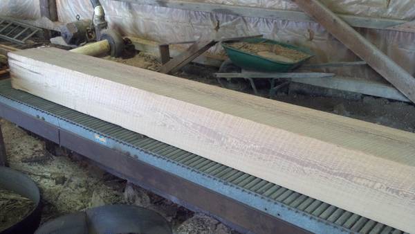

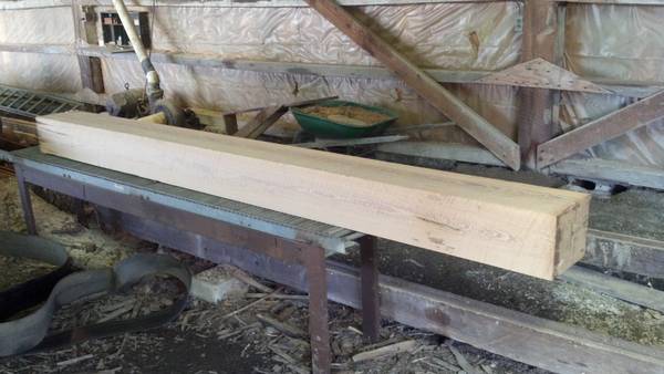

Now mind you, I didn’t want the mantel to be quite that rustic. But as luck would have it, the building in the background of the photo houses an antique sawmill, and they resawed one of the beams to my 8”x10” dimensions. Here’s my beam after resawing, still at the mill.
The end grain had absorbed a fair amount of water. The first several inches were pretty badly checked, but the middle section was solid.
Toting it home required a couple of helpers, as the beam weighed over 200 pounds. Then I let it dry out in my workshop for several months. Some of the cutoff slabs from resawing were thick enough to make useful boards, so I took them home as well.

Re: Heart-pine mantel
Y'all notice the closeness of the rings. Very old growth fer sure! More than a half century of growth in the supports.
