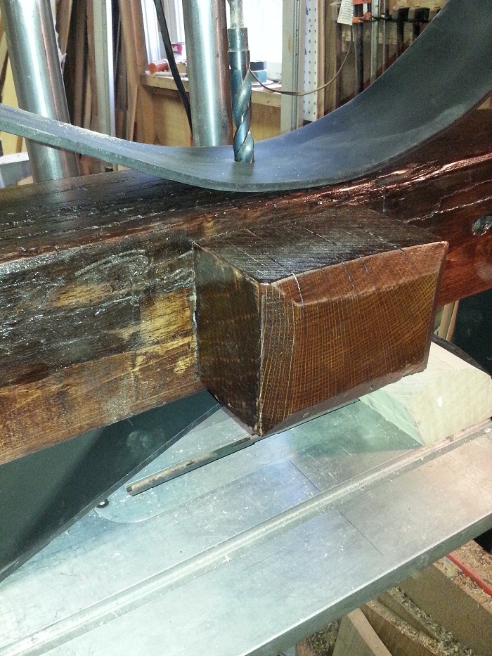

Got ready to drill a hole in a table leg in horizontal mode which was going to be so easy on my SS. Oops the table won't go down far enough! Switched to vertical position and had a perfectly centered hole in no time. Metal base in which I had previously drilled the table leg hole, plus top and base countersunk attachment holes. Now the metal part of the base has been welded and I needed to drill a matching hole thru a wood beam in the middle of the metal part of the base.

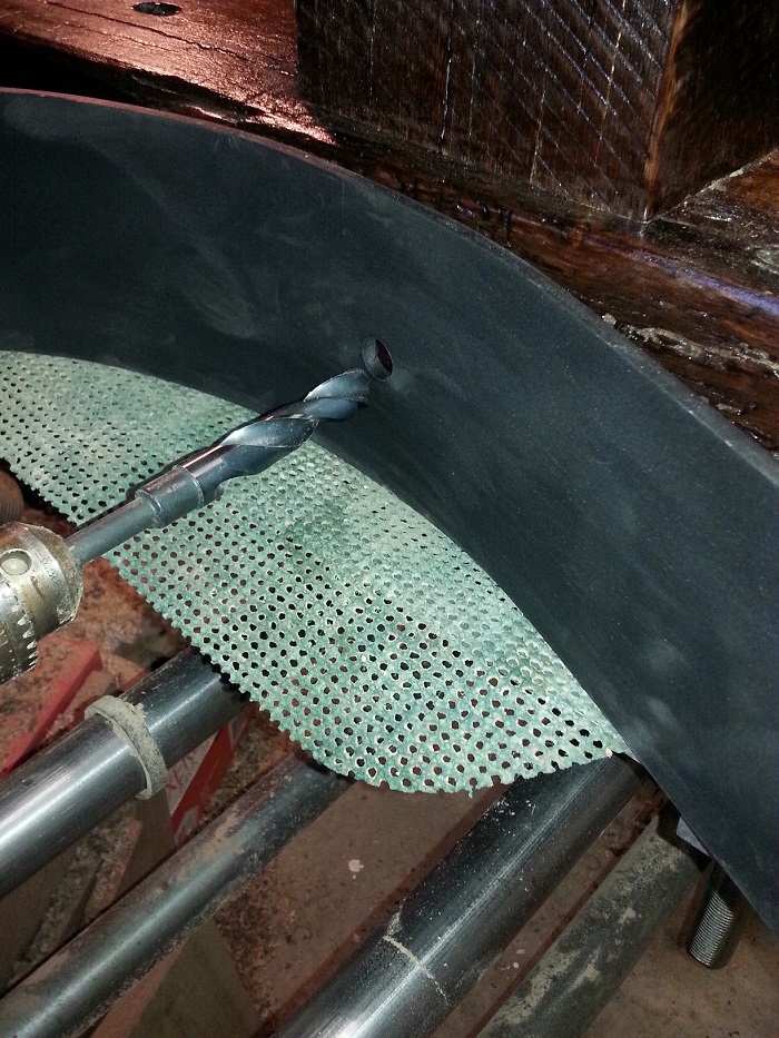

I do not like to drill metal with my SS, but that is the only drill press we have. It did quite well, although, about halfway thru the original 40+ holes I was wishing for the big industrial drill press that I grew up with where you could bring the handle down so far, squirt a little oil and walk away to let the weight of the handle do the work.

- HORZ - OPPS.jpg (315.73 KiB) Viewed 8833 times
- VERT.jpg (322.2 KiB) Viewed 8833 times
- DONE.jpg (167.83 KiB) Viewed 8833 times
