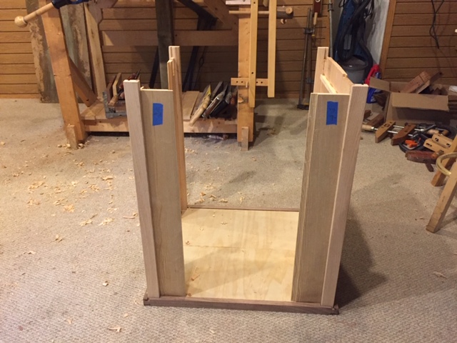

This was shown in earlier stages on another thread where I was showing off a lot of resawn lumber, courtesy the SS Bandsaw. The project is still a long ways from done, but it's fun to go down and mess with it every so often.
Here was a Base for a cabinet, sized mainly to use up pieces of poplar and oak I had. Also some nice resawn walnut will be a cabinet floor soon:

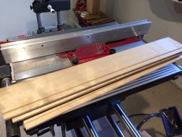

The SS Table Saw was plied into rabbeting chores, quite a few times, for lapped pieces:

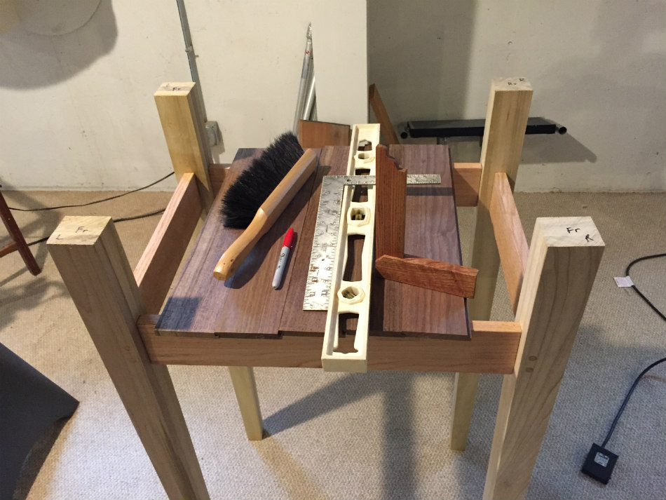

Here, a "Topper is being pieced together, upside down, a bit at a time:
Here is when a Topper gets test-fit on a Base:

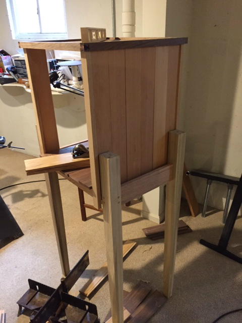

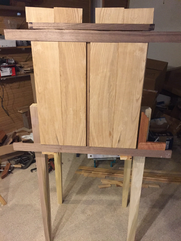

I have been able to 90% lay-in the lapped cabinet sideboards... this may or may not have been my best idea, but it has certainly allowed me to use up a lot of tight-grained resawn wood. The overall carcass has needed a number of small trims and adjustments, but generally is going to (mental) plan.
I am now mocking-up the front-door sizes in cardboard; the nice resawn Ash planks on the floor will be applied as those doors.
Again the photo shows the 4 legs to be mainly paint-grade poplar, which is what I'll do some time (brown or black range of color).
thanks for watching
Chris

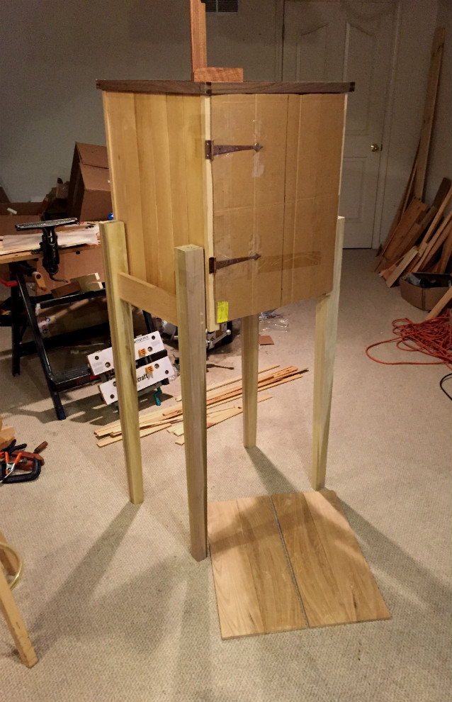

I have done some preliminaries on matching up the ash door-stock and fitting it to some walnut "breadboard end" stock. The "ash cutoffs" sitting atop the cabinet were my reminder to where each board ultimately goes:
More later!
Chris

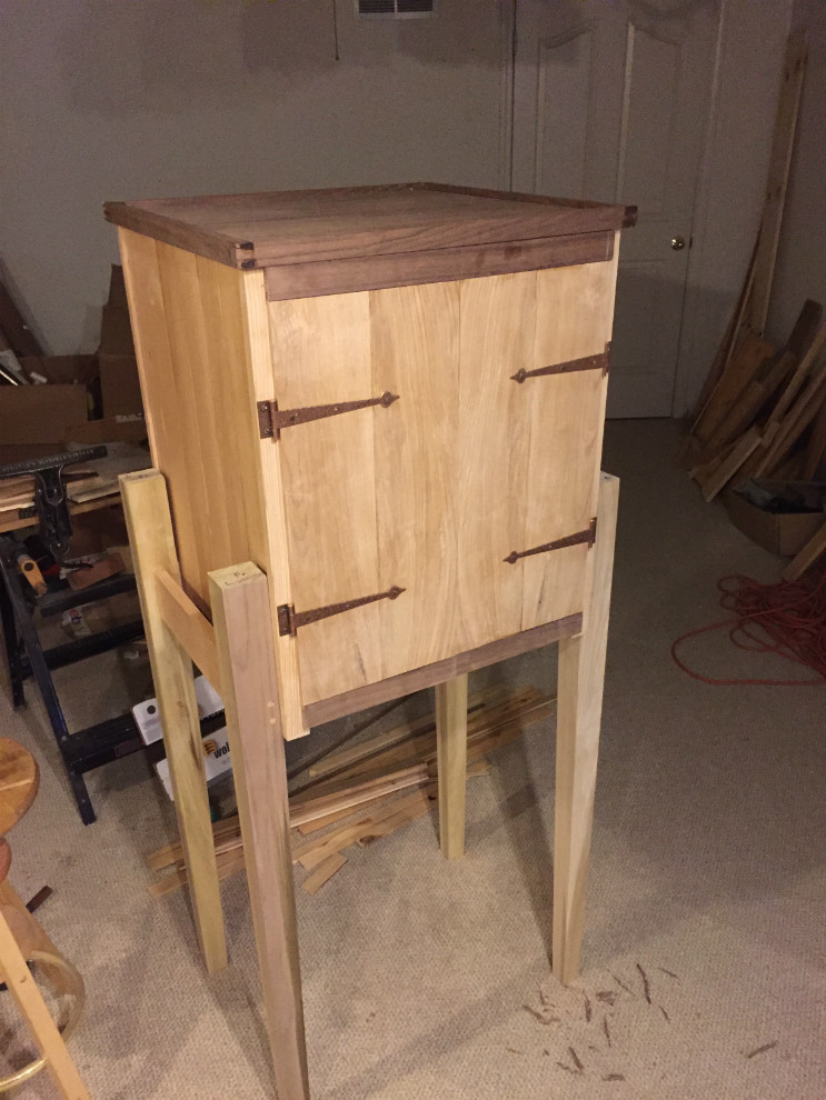

I had a couple of hours on July 4 before the rest of the events pulled me away. These doors are now hinged and working, with a slight lap-joint intersection on the center-line:
More later!
Chris
