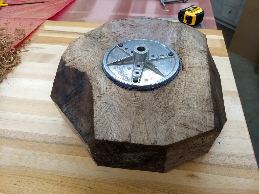

Here's my daughter's bowl blank, trimmed down just enough to clear the way tubes, and mounted on a 6" faceplate. The rough blank started out at about 16” in diameter. To preserve as much of the crotch figure as possible, I used the center of the tree as the bottom of the bowl, and left some sapwood at the rim.

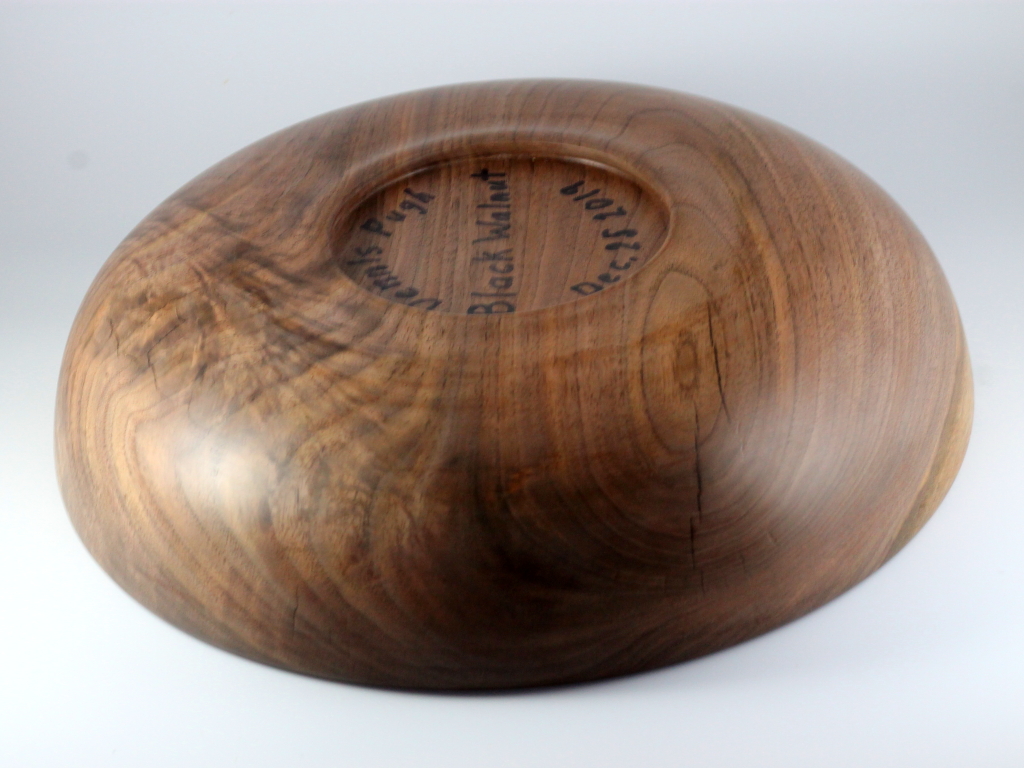

In this next shot of the finished bowl bottom, you can see a little checking from the accelerated drying. An existing crack in the bottom of the bowl had opened up a bit, another small one formed, and some slight checking appeared in the crotch-figure part. But there were no showstoppers, and some slow-curing epoxy penetrated and stabilized the cracks easily enough. I'll be curious to see how the conventional three-months-in-a-paper-bag process compares on a future bowl.
