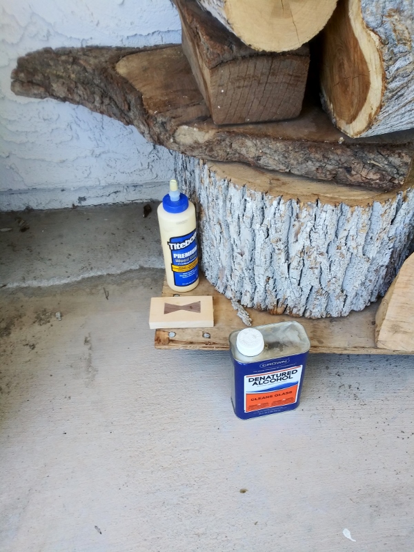

STB
Posts: 270
Joined: Thu Feb 24, 2011 12:26 pm
Location: Boulder City NV/Keno OR
Re: Glue up question
Post by STB »
STB wrote:Good question. I have a cart coated with boiled linseed oil. I will glue a piece o pine to it with tightbond II this morning and let you know the results tomorrow.
Wiped area with alcohol and it stuck just fine.
Glue test.jpg (357.46 KiB) Viewed 7491 times
