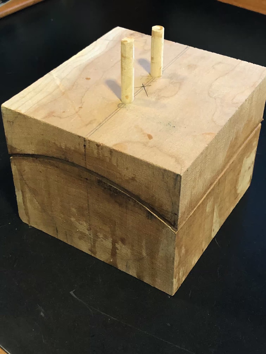

We used 1/8" thick material for the "wave", and it only takes about a minute in the microwave. Just make sure it is hot enough to bend without breaking. The dowels help to keep things aligned for gluing. They are in the interior of the bowl and will be turned away.
Glued up blank.
Glued up blank.

Thanks Mike. Very interesting.
so, I take it the dowel holes were drilled before you cut the blank into two pieces? Hmm, maybe only after you mated everything up?
Intriguing.

I can't remember the exact order, but you can drill the blank before slicing, and drill the contrasting piece through the blank when it is clamped up for bending/drying. With the dowels, you keep the grain on the blank aligned and keep everything from slipping when the glue is applied. Glue on the curved faces makes everything want to slide.

It's interesting because I had been thinking about trying that very technique to glue straight but angled cuts. The slipping had been severe and I built a jig to fix that. Haven't tried it yet but I love this dowel solution. Looks like the dowels are situated to be in the middle of the bowl that gets removed during turning.
