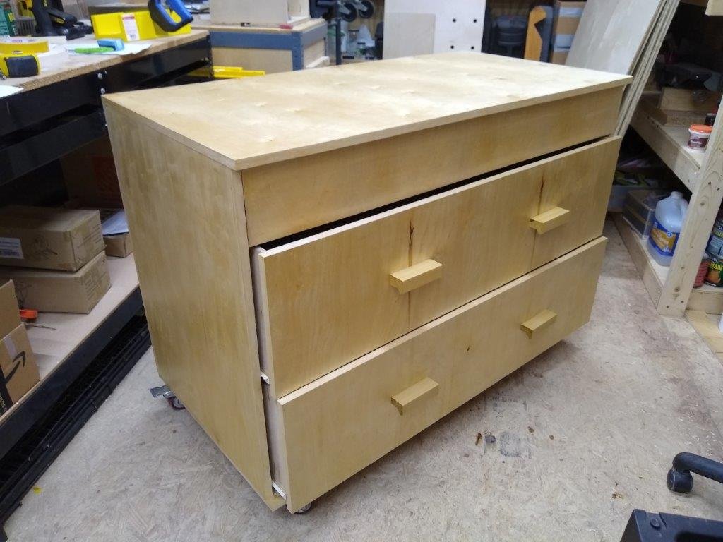

After working in my shop for about 8 months, Im undertaking table replacement. I had some old rickety workbench which ive used extensively but im ready for something more stable.
I decided on 3 tables to replace odds and ends I have in the shop.
First table is complete- except for dividers in those monster drawers. BTW- i hate drawer slides- getting them to work well is something I haven't figured out yet.
1st table has a flat top-no features-just a big work surface. The drawers do close - trust me ! Pic was taken while polyurethane was drying.

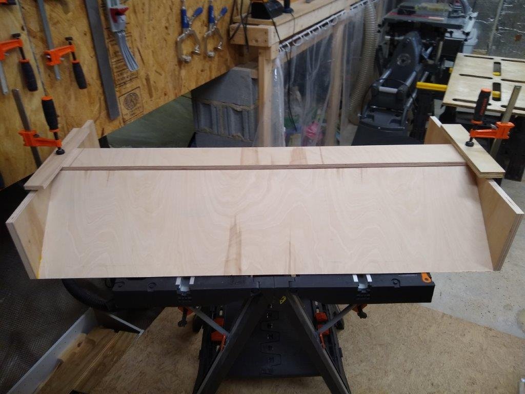

You can see what the 2nd table will incorporate :

I like that table and also like the idea of multiple smaller table rather than one big one. Looking forward to seeing the rest!
Re: WorkTable project
LIKE!! wheels wheels and wheels !! its nice to have the option on moving the tables around , I have been using saw horses and table tops now for a long time because they can be stored easily but a table on wheels definitely has it's benefits .
Yes- Part of the design choice is that 3 of the table top edges are flush with the vertical table walls...so I can butt 2 tables together for a larger surface when needed. I'm thinking about adding some little flip clasps to them together when needed.

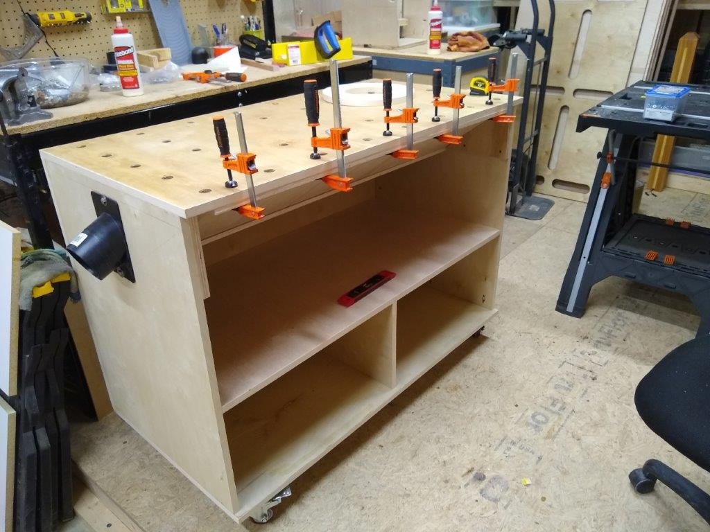

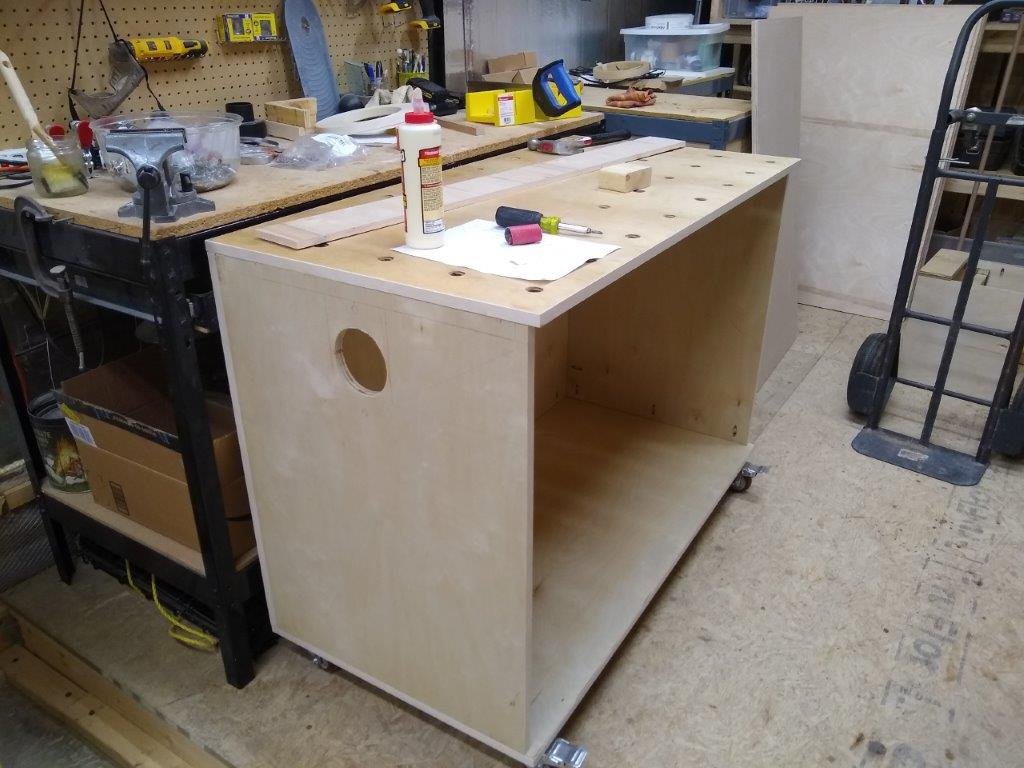

Well the 2nd table is nearing completion. It is a bench dog top with an experimental addition- I built a chamber to capture dust which draws air thru the bench dog holes themselves out to my dust unit. Heres the base unit.

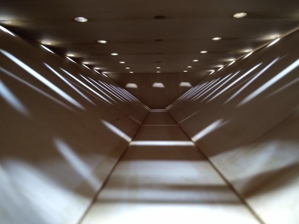

And the dust chamber to fit underneath the tabletop. Really don't know how well this might work. I sized the bench dog opening total area to be similar to the 4" port on the side of the table-hopefully giving good flow thru. We will see !
Heres a fun view of the interior of the dust chamber-with light coming in through the benchdog holes in the tabletop.
one issue I created-as the dust chamber gets closer to the top-the length of the bench dogs I can use in the outer bench holes gets shorter...not a big issue-but punching a hole thru the 1/2 ply dust chamber with a hold down would be...aggravating!
and close to final assembly - I am working on a couple of drawers for the bottom and then I can move on to the last table.

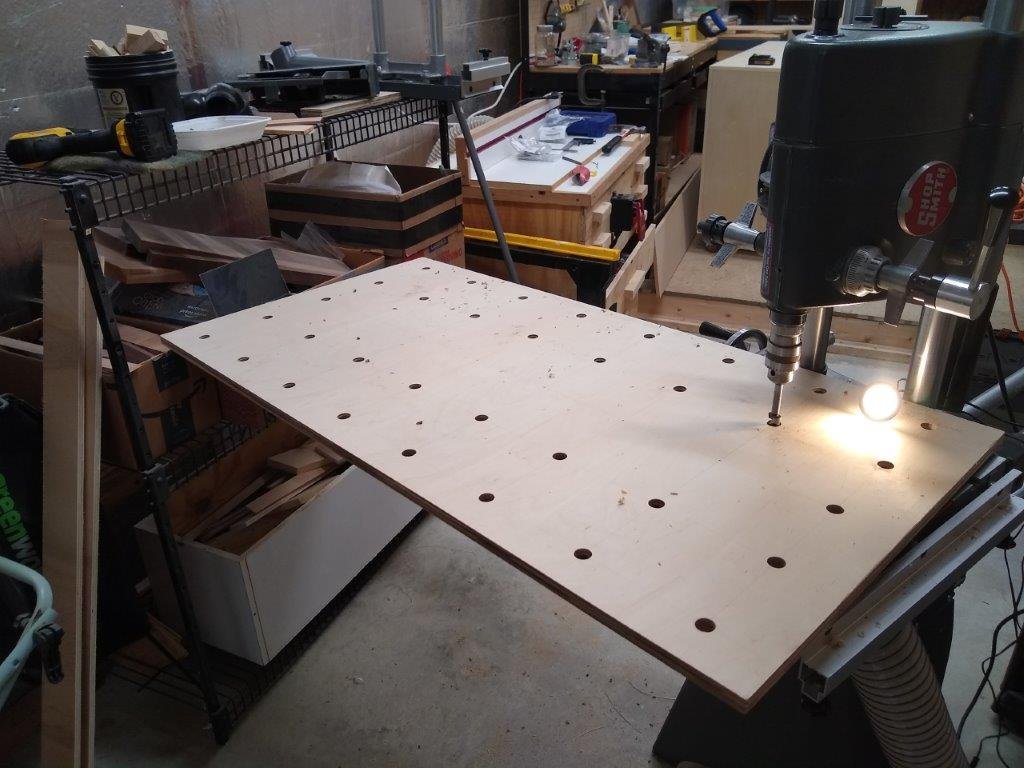

As a teaser-the third table top is in the background of that last picture-behind the dolly. Can anyone guess my intended use for a tabe like that ?

Looks good! After you have used it a bit, let us know how the dust collection works on that table. I considered it for the one I recently built, but decided to push it off and consider it as a possible add-on in the future. Please share an update on yours in the future once you've had some time to try it out.

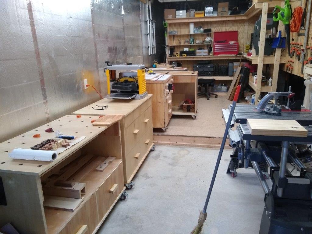

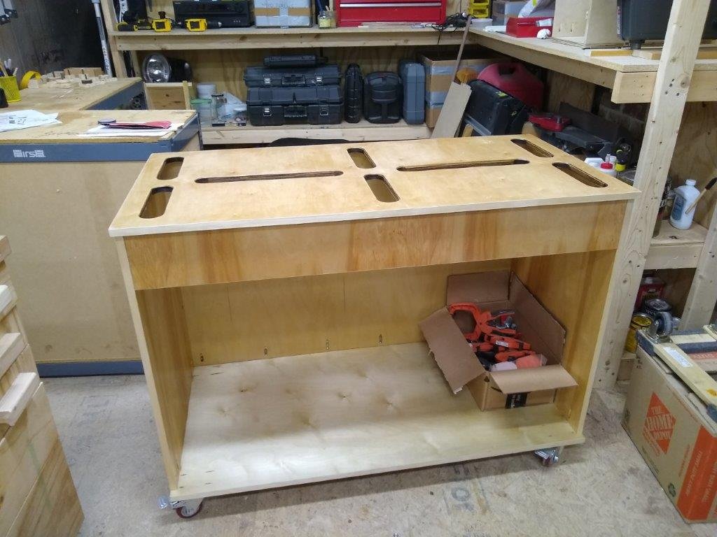

Finally- 3 tables done. The third table I cut big slots into it to allow me to clamp stuff easily. Like my Vise and my miter saw ...which had always been bolted to the table I finally got rid of .
With that- I could finally re-arrange the shop a bit to add more work surface space- which seems to always be missing.
Meanwhile- the wife came wandering around and noticed all the scrap plywood I was making and decided to turn out some small holiday cheer to send to friends and family. She enlisted me to cut veneer like strips of the plywood which she then deftly glued to triangular scraps I had. Way more creative than I will ever be.
One thing I am already noticing- veneer on the bottoms of the tables gets nicked up pretty quickly- ah well-they are shop tables !
