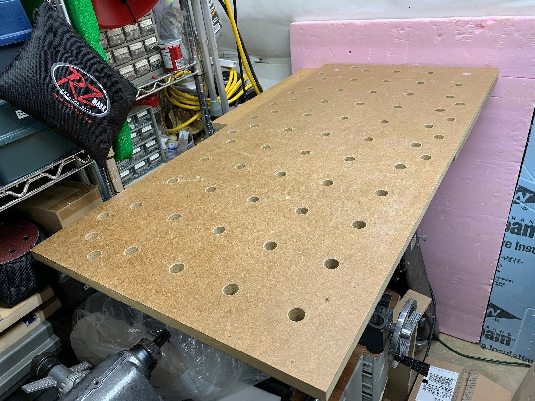

Here is a first look at this. The basic idea is to have my end MFT stay on then set an additional table on top and held in place by these dogs. It looks like this:
The table first pictured has already had the holes prepared so I dug out one that has not so I can show how this works.

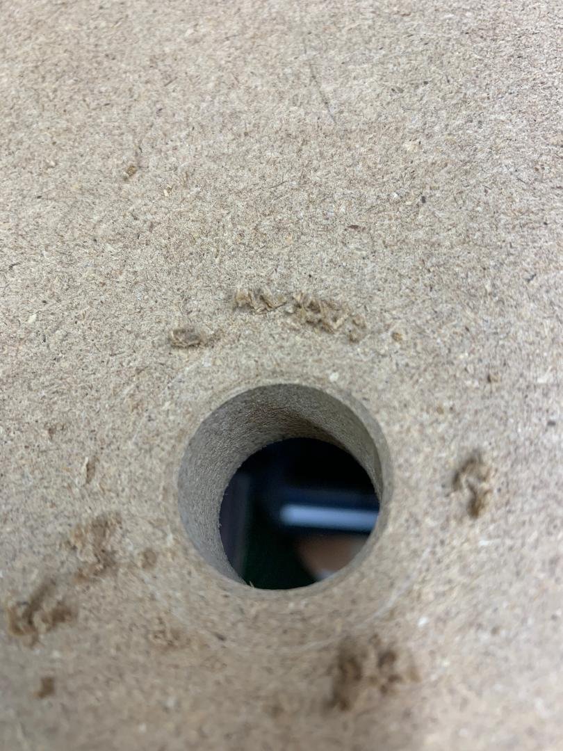

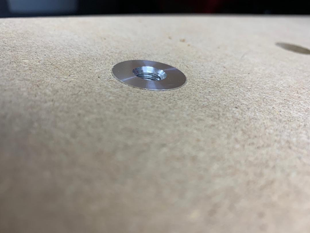

As you can see the dog has a chamfered lip so in order to get it to fit flush you need to get the holes ready to except the dog. You want them to look like this when inserted
You can do this by several means, for me since I have the one from Axminster I used that. It looks like this:
You put it in the hole and turn and you get this:

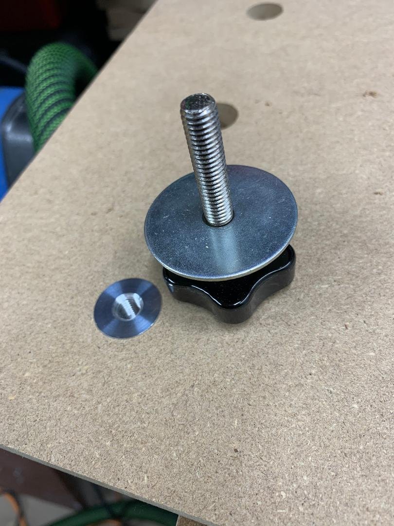

The next part you need is a knob that pulls it all together. I have a collection of these M8 knobs so I didn't buy the matched set from TSO.

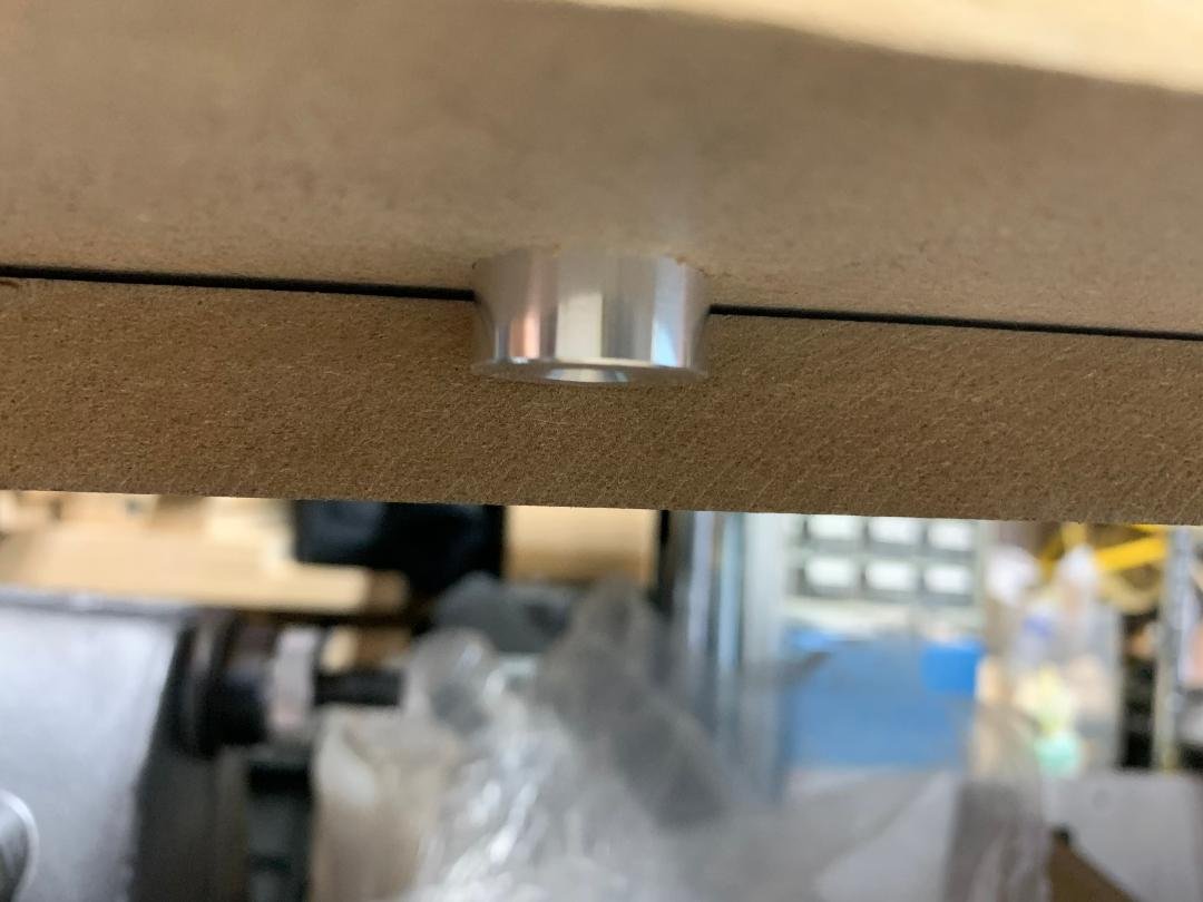

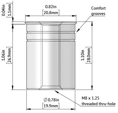

What makes the work is the fact the dog is longer then the work top so it fits in a hole in the lower MFT surface. Here is a shot showing how much longer:

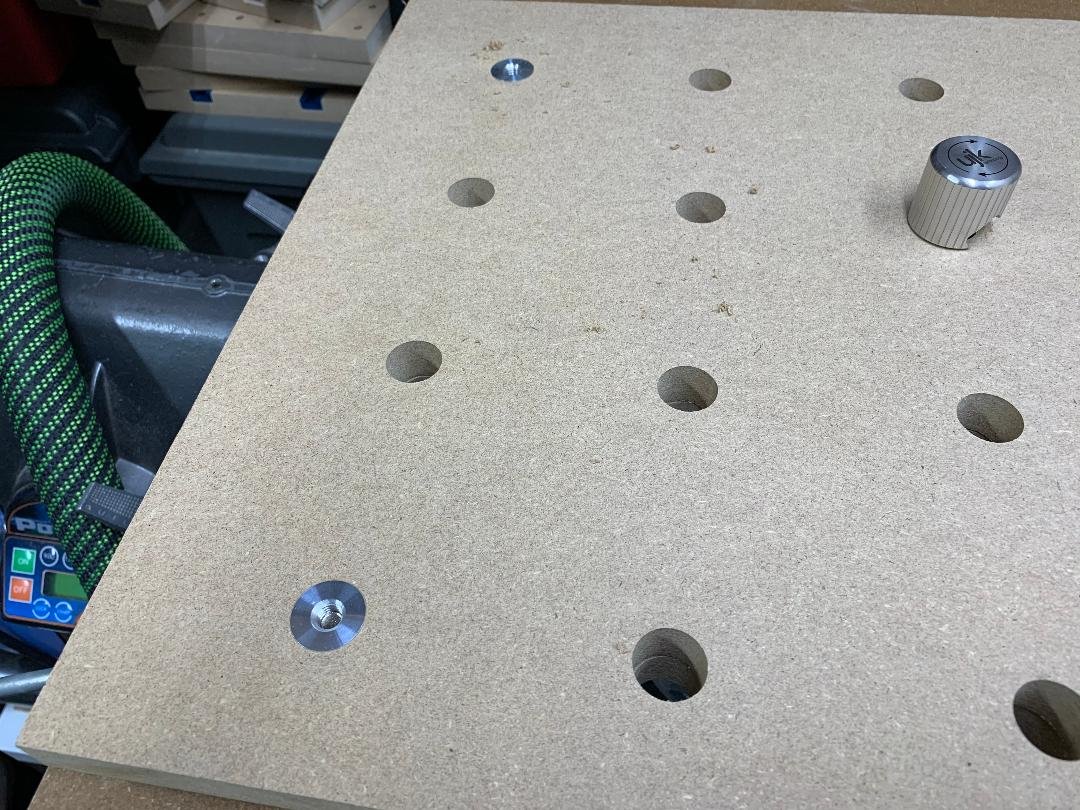

You don't have to do all the holes for this if you wish, just do the hole that you plan to use. Here is a shot with two holes ready and the rest not, I will more then likely do them all but at some later date.

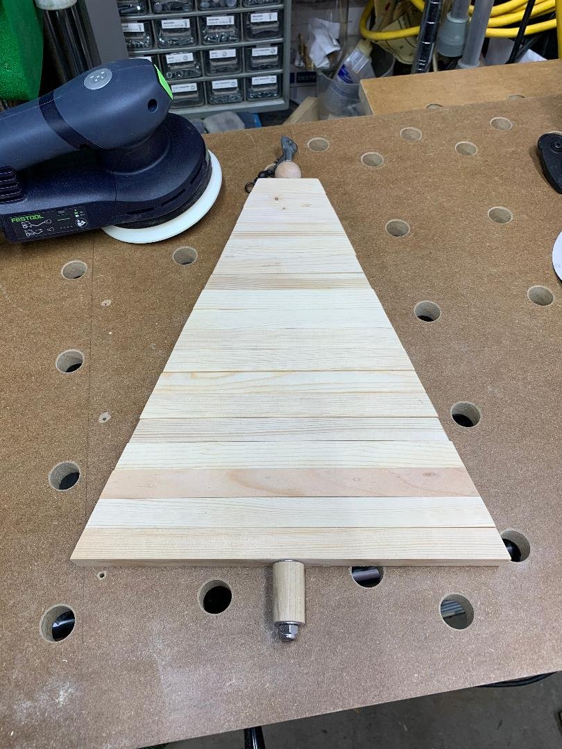

I actually used this today for a place to do some sanding. I was sanding a Christmas Tree. It is going to work great.

So you may not be able to picture me sanding a Christmas Tree so here is a picture so you know it happened. BTW this is after the initial sanding, you can tell by all the saw dust laying around.

Ed, do you have any problem with those “dogs” wanting to turn in the hole as you tighten the clamp knob? Aside from some friction at the little chamfer flange, I can’t see what would prevent it.
Re: Smart Connect Bench Dogs
They are going through one top and into the next so they seem to fit tight enough not to turn. I have not tried them every where so it is possible that some "looser" holes might turn out to be a problem but even then I thing pushing down with a finger will be enough to prevent the turning??

Well, a Morse taper certainly has plenty of holding power. But those have a much steeper contact angle than the dog “lip” that mates with the hole chamfer (45 degrees, I presume). Aside from the lip, the dog is basically a just cylindrical nut, and I was curious as to how well it works without wrench flats or spanner holes.

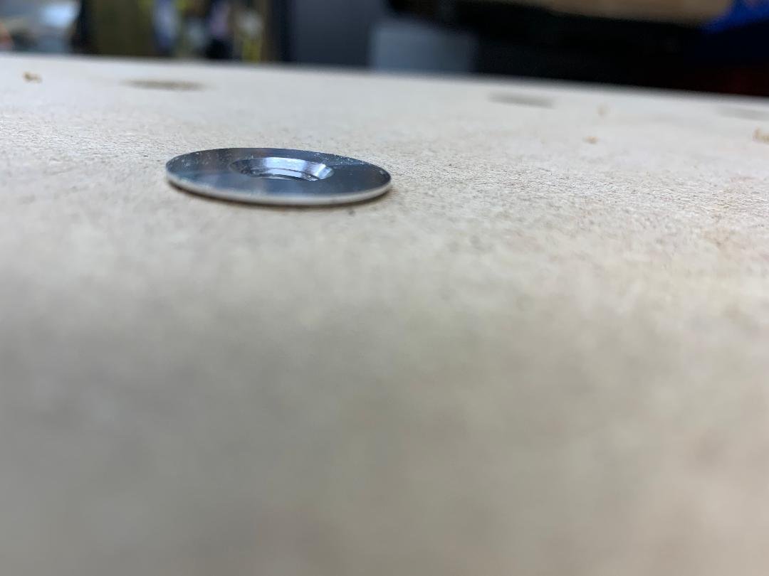

After a couple of days using my new set up I noticed that the dogs set just proud of the top. It isn't much but it can be felt and when sliding some material into it you can notice it. It would appear that either the design or physical product has a problem. Since TSO sells the UJK chamfer tool that the dogs would have been designed to work with the tool. Maybe my expectation of it being flat or recessed was incorrect????
I have contacted TSO and waiting on an answer. This is the second time I have found a problem with one of there new products, the first one they fixed but did offer me new parts when they fixed the issue. I had to buy the new one but that wasn't so bad, but I hope they do better on this.
